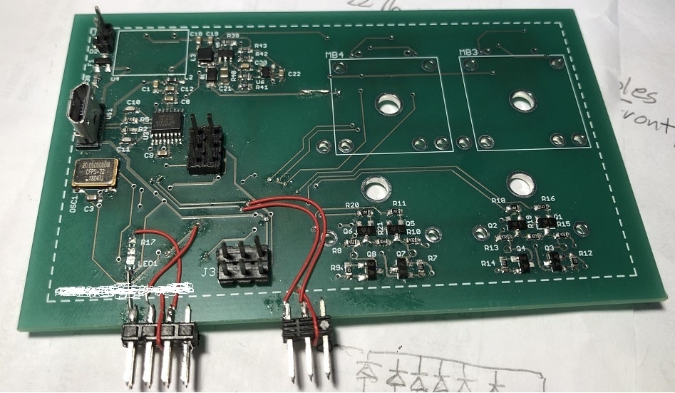

    I add a lot of flying leads to my early prototypes in order to attach test equipment to assist in the coding and debug processes.  I tend to use Kynar wires attached using vias if possible, or by removing resist and soldering to traces.  I like to run the wires to headers at the board edges, so that I can quick disconnect the board if I need to re-work the board.
    The headers make it easy to attach scope probes or dupont connectors to route signals to instruments or even protoboards.

    Hi Gene,
    I don't know what engineers would do without Kynar wire.. best invention for SMD board troubleshooting (and wire bodges) ever : )  One thing I really should do on prototype boards is remember to occasionally make a few vias large (or have some small spare holes), simply for passing bodge wires from one side of the board to the other. With nearly every component on a board being SMD these days, it's easy to end up in a situation where either a fresh hole needs to be drilled, or the wire needs to run to the edge of the board to get onto the other side.

    genebren over 2 years ago in reply to shabaz
    The addition of vias and small holes is a great idea (but one that I often forget).  I often need to drill small holes through the board to pass wires or to add wire ties to secure the connectors that I add (the wire ties are handy to allow the connector to float so they can be plugger into perfboards or protoboards).
    Design for testability is an important step in the process, but one that often gets ignored in the mad rush to get a board on order. Something that I need to work on in my processes.
