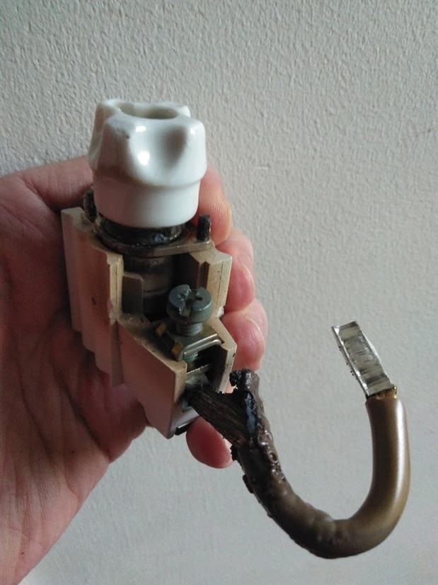

    Yep, something similar happened to me only last week. Air gap in old fuse (more likely) or possibly loose connection had caused flickering but could smell some ozone too (usually the sign). Failure triggered due to higher than normal current as had a couple of electric heaters on for a change (one was also my fan heater) and then the wife put the kettle on...
