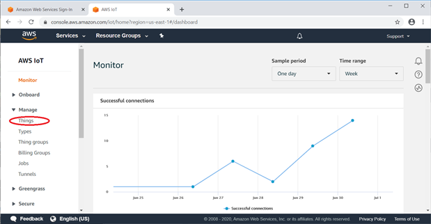

The AWS Console page will appear:

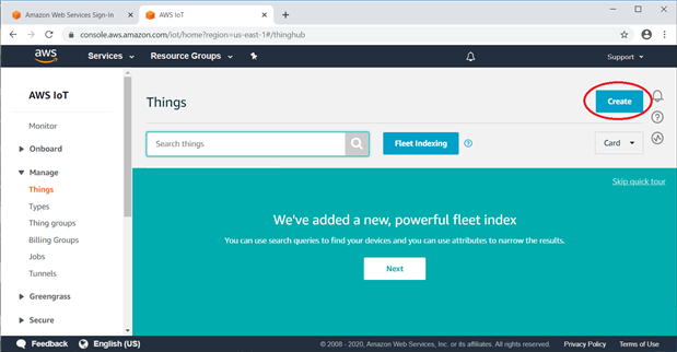

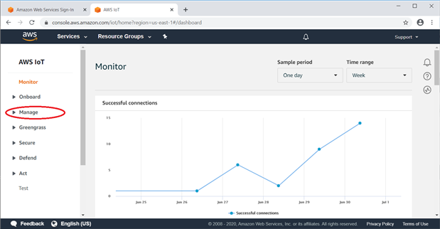

Select «Manage» on the left panel then choose «Things»:

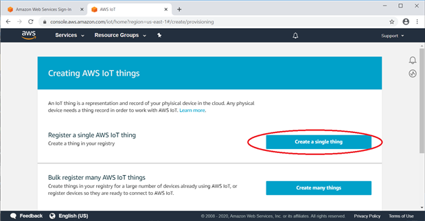

If you already have a thing choose «Create», if it is the first thing on the account choose «Register a thing»:

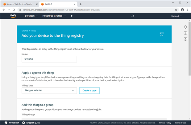

On the Creating AWS IoT things page, choose «Create a single thing»:
On the next page enter a name for your IoT thing (for example, «SENSOR»), scroll the page down and then choose Next.

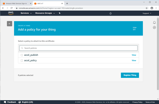

Then choose «Attach a policy» if you already have one.

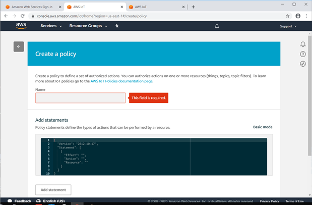

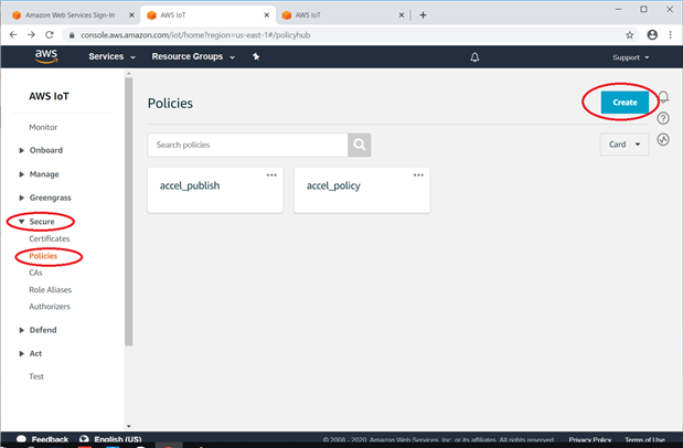

If no policies are defined then choose «Secure» on the left panel, then «Policies — Create»:
Fields of the page to fill are:
Name: is a policy name.
Action: should be set to iot:*
Resource: should be set to *
Effect: Allow
The same policy could be set in advanced mode by copying the fragment
"Version": "2012-10-17",
"Statement": [
"Effect": "Allow",
"Action": "iot:*",
"Resource": "*"
to the text field:

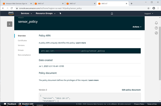

Press «Create» button to create the policy.
Example of the SENSOR_POLICY page:

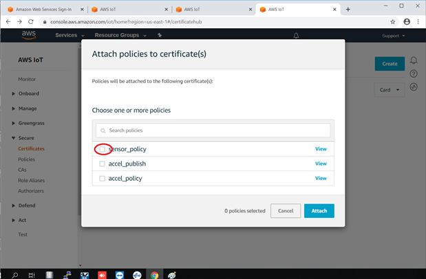

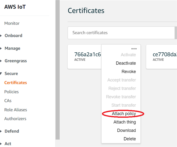

Now the created policy should be attached to the certificate of the Thing (SENSOR):
Choose «Secure» then «Certificates» on the left panel of AWS console:
Then press «...» sign at the upper right corner and select «Attach policy»:
Select «sensor_policy» created before and then «Attach».

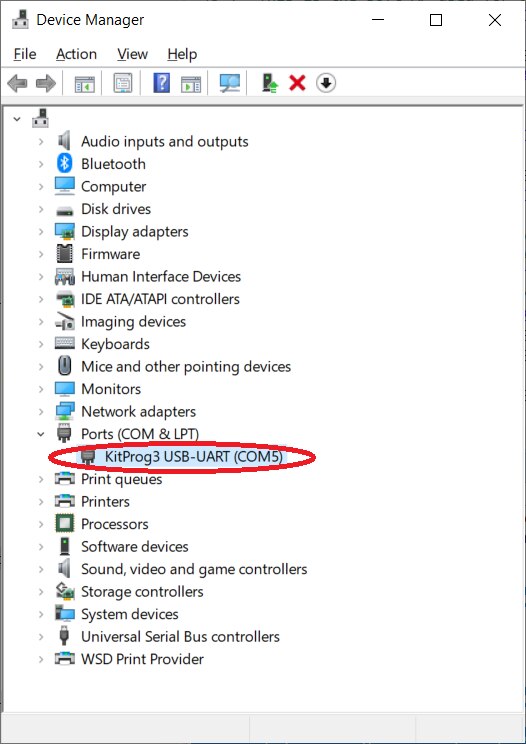

Open the Device Manager and find the PSoCRegistered 6 WiFi-BT Pioneer Kit serial port (COM5 on the the picture).
Save the COM-port name to insert it into the Make Target config later.

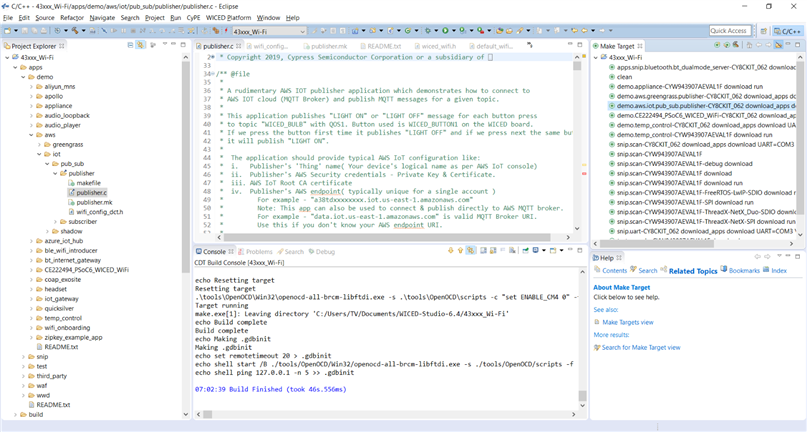

Start WICED IDE and open in the Project Explorer (the left panel with folder tree) and open demo project source file /43xxx_Wi-Fi/apps/demo/aws/iot/pub_sub/publisher/publisher.c

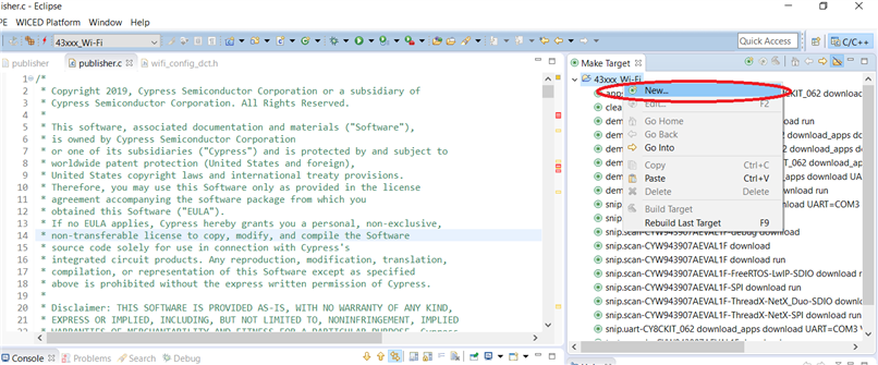

To compile, build and upload the code you should create «Make Target» item at the right panel (Make Target panel).
Right-click on the 43xxx_Wi_Fi folder and select «New…»
Paste the following string to the «Target name» field of the «Create Make Target» window:
demo.aws.iot.pub_sub.publisher-CY8CKIT_062 download_apps download UART=COMXX VERBOSE=1 run
where COMXX is a COM name in the Device Manager.
Do not change other controls and click OK.
Double-click the appeared item and look for the console output for the strings:
Downloading Application ...
Download complete
Resetting target
Build complete
xx:xx:xx Build Finished (took Xm:Xxs.XXXms)

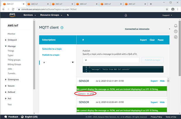

You can open AWS IoT console monitor to view received messages.

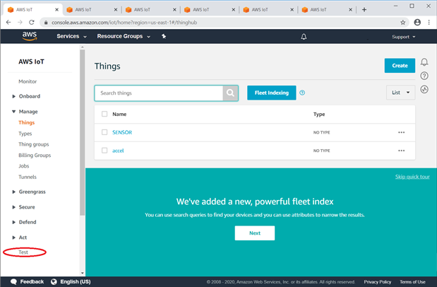

Go to the AWS IoT console, select «Test» item:
Then enter # in the «Subscription topic» field and click «Subscribe to topic»:
Now you can monitor your messages received by the AWS IoT console client:
