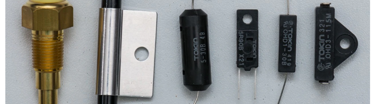

Many people know all about bimetallic thermal switches, but not everyone may be familiar with Thermorite® Thermal Switches. So, let me provide you with a brief background.
Thermal switches (also called thermal sensors) are used in industrial, appliance, and HVAC products. They are typically used as protection against overheating, overcooling, or overloads when used in a motor protection circuit. The most widely used thermal switches are bimetallic thermal switches and thermistors.
Bimetallic thermal switches consist of two strips of different metals that are bound together. Bimetallic thermal switches leverage the expansion of metals when they are heated. As the strip is heated, the different metals bend in different directions, opening or closing a switch contact (NO/NC).
A thermistor is a type of resistor whose resistance changes with temperature changes. Thermistors are widely used as inrush current limiters, self-resetting overcurrent "fuses," and self-regulating heating elements.
The bimetallic thermal switches have been a mainstay for the design of thermostatic temperature controls and over-temperature protection over many decades. Thermistors have also been widely used, but neither type offers the high accuracy or stability needed to meet the latest demands of consumers and industrial end users.
In response to the drawbacks of the traditional products, thermal ferrite materials such as KEMET’s Thermorite® have emerged to enable a new generation of thermal switches that deliver greater accuracy, faster response times, and better stability with respect to ageing and environmental conditions such as humidity. For a detailed discussion of Thermorite® Thermal Switches, go here.
How Does the Thermorite® Thermal Switch Work?
The thermal reed switch contains a pair of Fe-Ni (iron-nickel) reeds encased in a glass tube filled with inert gas. Encasing the reeds in this way ensures the switch is dust proof, explosion proof, and corrosion resistant. A Thermorite tube surrounds the reeds, and acts as a magnet at temperatures below the set point determined by the material composition. When the temperature rises above the set point, the Thermorite loses its magnetic properties and the magnetic field collapses, allowing separated reed contacts to touch (make-type switch) or close contacts to separate (break-type switch). The mechanism shows very little degradation due to metal fatigue. Tests under standard conditions have demonstrated switch lifetime based on metal fatigue of 500,000 on/off cycles.
