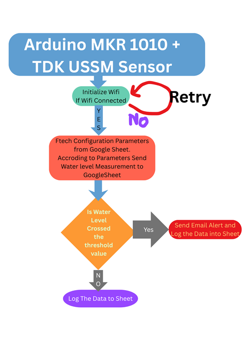

Here’s what happens, step by step, inside my setup:
  1. TDK Ultrasonic Sensors measure water level distance from Sensor which is placed at Danger line marking.
  2. Arduino will Connect to wifi. If not connected it will keep trying until its connected.

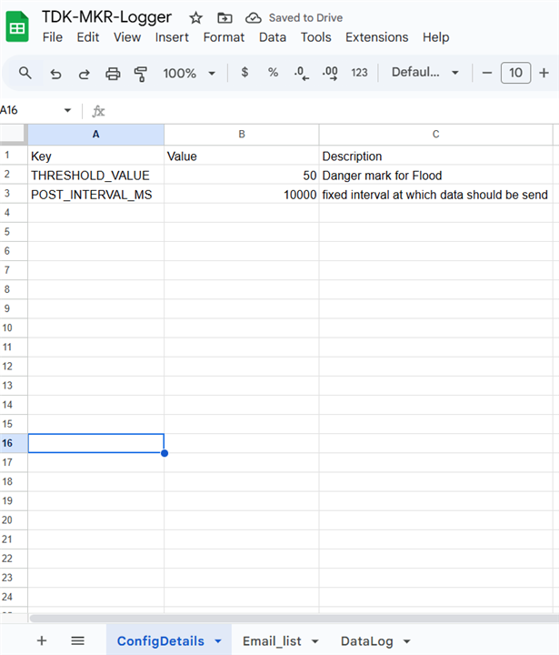

  3. Once wifi connected it will fetch the google sheet Named “TDK-MKR-Logger’ tab “ConfigDetails”
  4. From there it will fetch the THRESHOLD_VALUE and POST_INTERVAL_MS parameter
  5. THRESHOLD_VALUE will define the alarming water level to send upcoming flood alert
  6. POST_INTERVAL_MS will tell the frequency of distance measurement i.e. interval after which distance is measured
  7.  Arduino will keep measureing distance of water level from Danger mark at fixed time interval (POST_INTERVAL_MS ) from TKD Sensors. It packages that info into a neat little JSON payload .
  8.  Then send this distance to Google sheet. payload is sent via HTTPS POST to my Google Apps Script Web App . The script logs it in Google Sheets under the “DataLog” tab.
  9. When distance from water level is received by google sheet it will check if Distance is less than threshold ?

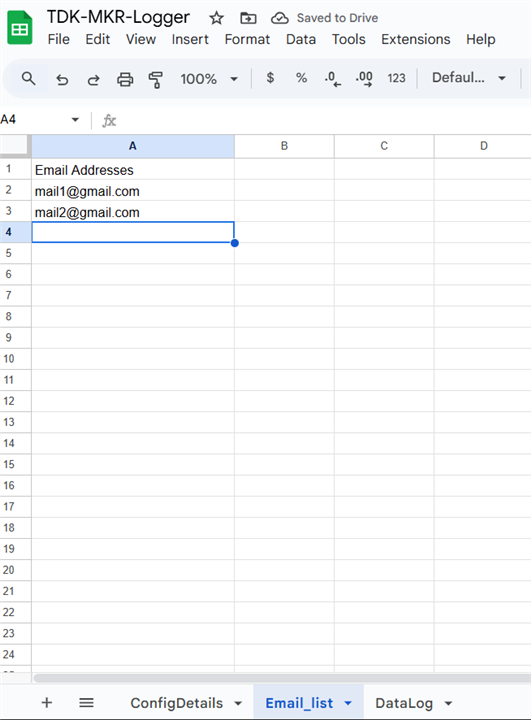

    if yes then it will send alert to Predefined Email addresses stored in “Email_list” Tab in sheet.
  10. I keep configuration in google sheet so that in case if you want to change the threshold level or frequency of measurement taken , yoou don’t need to go to riverbed or waterbody and take Arduino out of box and reprogram it. Just simply change configuration details in google sheet and it will work . no need to reprogram Arduino for each time we change Flood parameters Configuration.

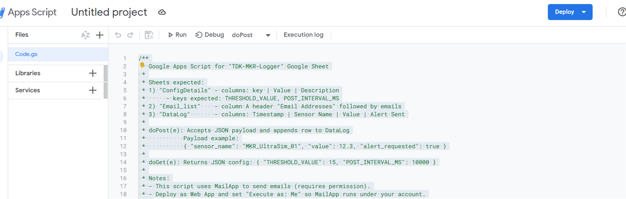

Server-side: Apps Script doPost
On the Google side, doPost(e) checks:
  • JSON parse ok?
  • api_key matches?
  • value is numeric?
  • alert_requested true AND value compared vs THRESHOLD_VALUE in the sheet?
If conditions match, it sends email(s) and writes Alert Sent @ TIMESTAMP into the DataLog row.

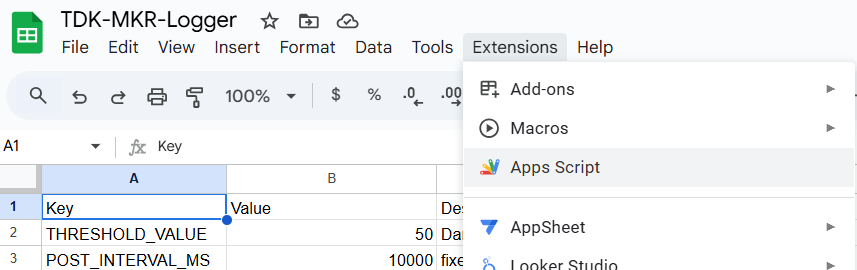

Create a google sheet "TDK-MKR-Logger" with 3 tabs.
tab1 named "ConfigDetails"
Tab 2 "Email_list"
Tab 3 "DataLog"

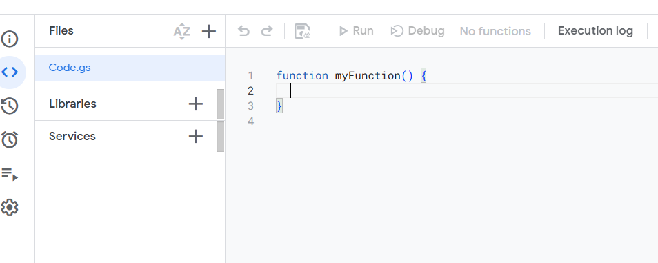

Click on Extensions and select Apps Script
Copy and Paste code.gs Code into it. find it inside zip folder i have uploaded
 Deploy
Select New Deployment> in description type any thing you want >in Who has access select anyone >Click Deploy  > from there a web URL will be created. Copy it and save for next part of arduino mkr 1010 Programming.

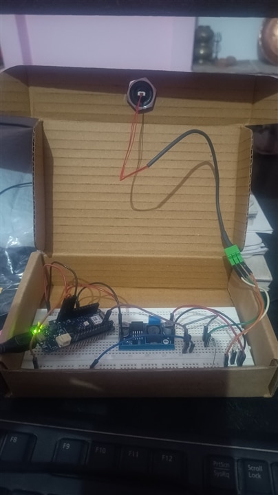

So the fun part begins — wires, boards, and the faint smell of solder.
This is where the project goes from “cool idea” to “actual blinking lights.”
Here in this blog we will discuss the wiring of all components and the Code inside the Arduino Board.

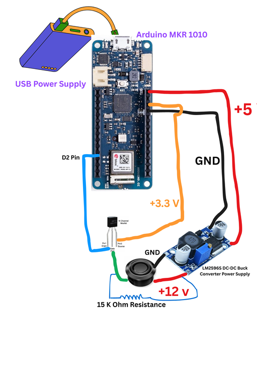

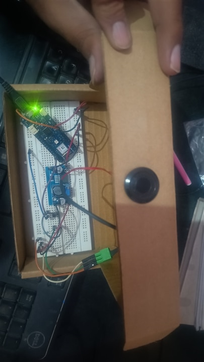

Circuit Arrangement:
Final Circuit
Required Hardware:
  • TDK USSM Distance measurement sendor — the stars of the show.They send ultrasonic pings and measure how long it takes for echoes to come back.
  • Arduino MKR WiFi 1010 — the brain that reads data, processes it, and sends it to the online google sheet for collection anf furture analysis as well as initiate warning email when danger mark is near.
  • BS170 MOSFET , 15 k Ohm Resistance , used for logic level converter to safely operate our arduino
  • LM2596S DC-DC Buck Converter Power Supply to poweup the sensor with 12 v
  • A bunch of colorful jumper wires — because what’s a DIY project without a rainbow of cables?
Open Arduino IDE and Upload following code into it
use code early_flood_warning_monitoring_system.ino and arduino_secrets.h inside zip file uploaded

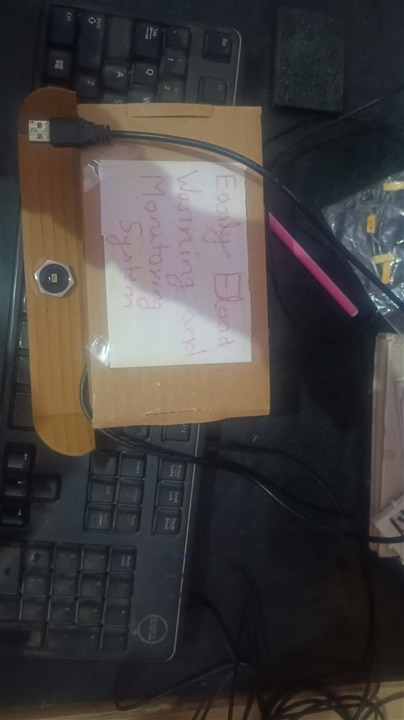

Testing the Flood Warning System by prototype assembly
So, this is it. The moment of truth.
After weeks of code, cables, and caffeine, it was time to see if my little flood warning system could actually handle the real world.
Spoiler: it didn’t catch fire. So, that’s already a win.
Setting the Scene

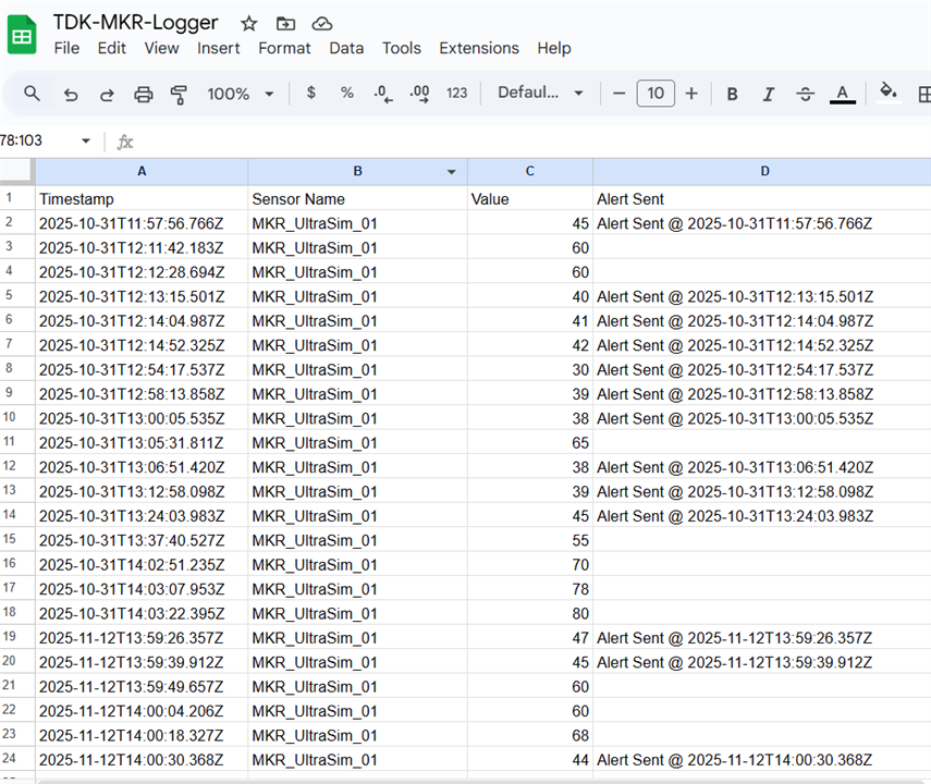

It was a Sunny morning — the perfect “let’s see what the water does” day. as this is winter time so not much changesin water level of river so decide to check it in a bucket filled with water. hwere i can rapidaly increase or decrease water level.
it is working good.

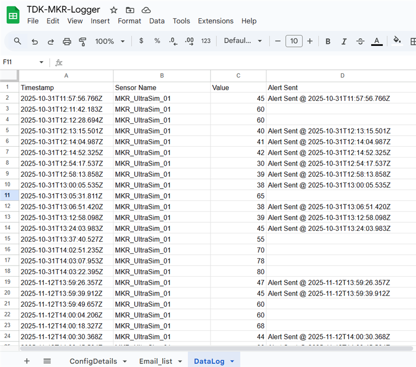

Google sheet Data LLog

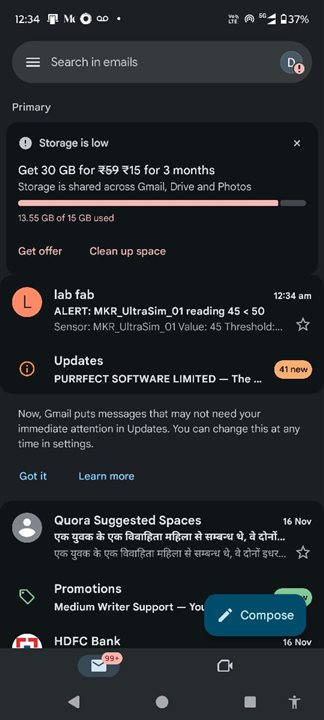

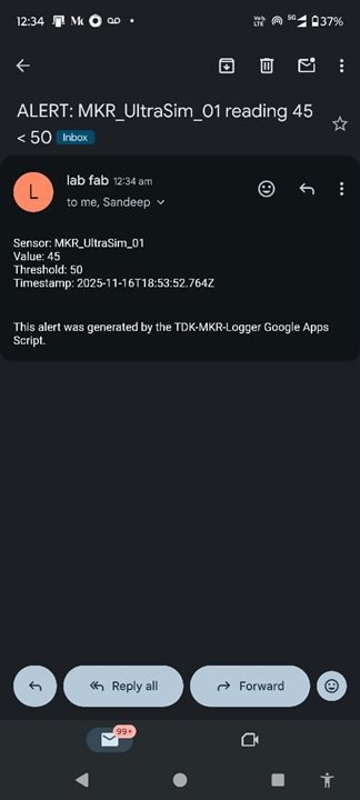

email alert screen shot
image.
For Now System is working good.
