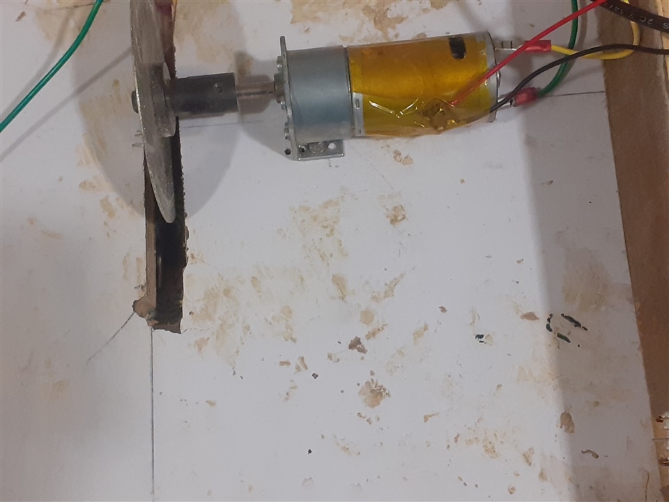

I have already build a PCB cutter for at lest 1.5 years back for cutting PCB. More often or no the DC motor used to get hot after 1 hour of use. I was looking for way to protect the DC motor that I am using in the PCB cutter. I decided to build and implement safety system for the PCB cutter. Temperature measurement and indication of motor over heating is also one of the requirement I need to satisfy. For a motor to be safe to use it's temperature should not go beyond 50'c. If it goes you should get an indication about it. bellow is the image that display how we have attached RTD temperature sensor to the DC motor.

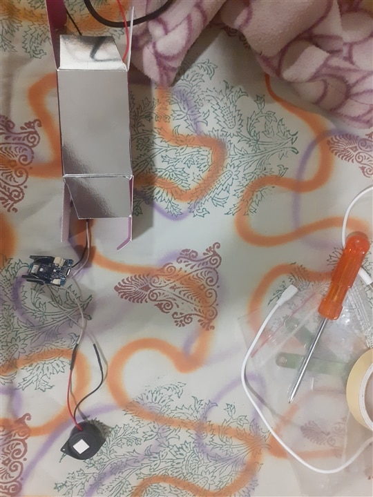

The RTD is glued to the motor using Kapton tape. So that the RTD can measure the motor temperature and send that information to the mkr Wifi 1010 development board. The mkr Wifi 1010 board checks for temperature weather it is above 45'c and bellow 50'c give a 5 beep indication and if the temperaure is above 50'c it gives 1 long beep indication. bellow is the image of how we have fitted the mkr Wfi 1010 to the paper box.

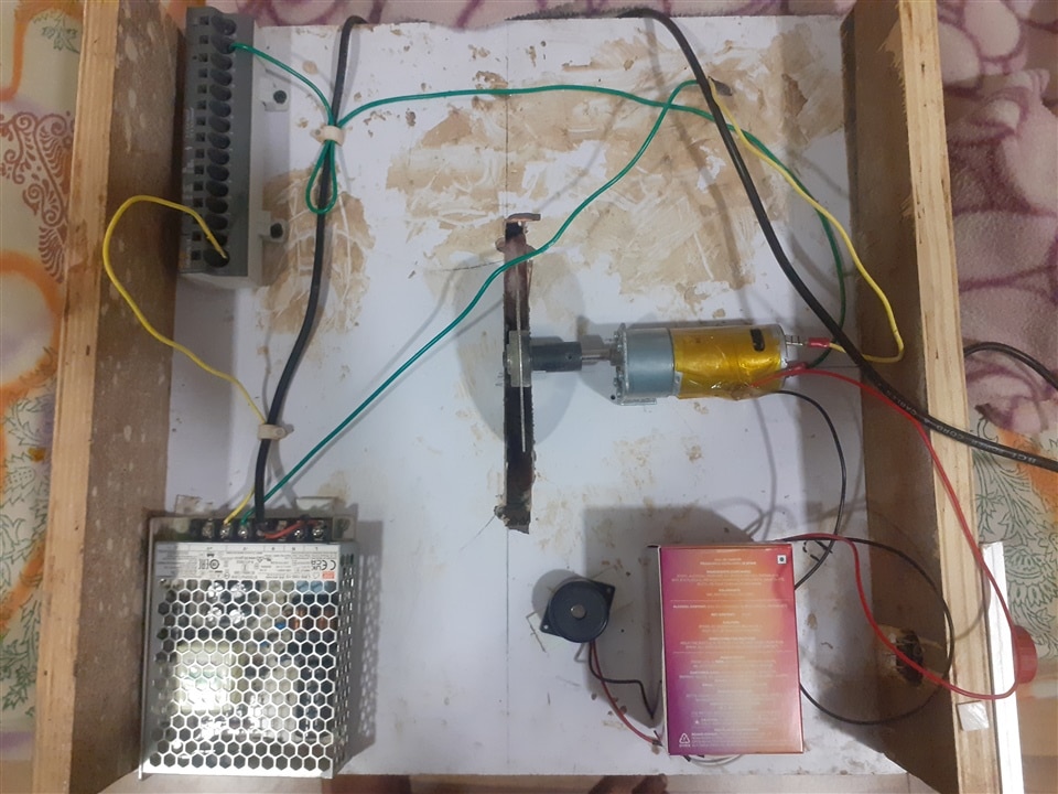

After fitting the mkr wifi 1010 board in the box. We have assembled the entire system in the PCB cutter. which is shown bellow.
Bellow is the video that is showing buzzer response when the dc motor gets over heated.

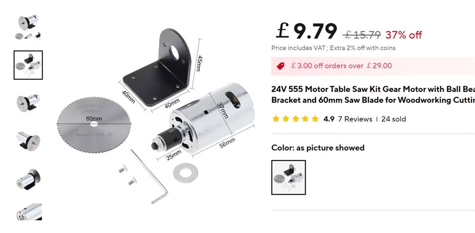

  • Something slightly more powerful than what you have would be good, but I'd strongly advise not to go to extremes for this DIY project. You shouldn't need more than 50W or so for that size blade anyway (I think mine is probably about 35-50W (I could check), and has a slightly larger blade, and cuts thin material extremely quickly - with a more coarse blade).
    And the build quality is critical (it's extremely easy to cut yourself, poke out eyes with flying material and so on, even with many of the models with more safety features built in). Table saws are one of the more dangerous tools compared to other electric saws; check some online articles or videos on the subject if you're not convinced.
  • I am looking for various other motor as well. As I have a huge requirement for this table saw for every know and than use. more powerfull motor something above 500 watt.
  • I watched the video again, that's much clearer thanks.
    The motor is underpowered, it should slice through the wood very quickly. Also, your saw blade is quite fine, if you can find one that has much coarser teeth, it will likely work better. The fine-tooth blades are usually for cutting metal  (which is dangerous anyway with a table saw).
    I looked on AliExpress and saw this, which might be more suitable:

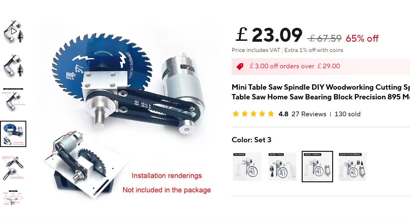

    Or, probably better but more than twice the price:
    The second example will have more suitable bearings, plus may have a better speed to match the saw blades (the saw blade isn't included in that price though).
    I have a small circular saw that is ancient and has been playing up recently, so I took the rear panel off to examine it, and noticed it too uses a belt drive. Mine has a coarse blade which is ideal for wood and PCB material (although I don't often cut PCB material with it).
