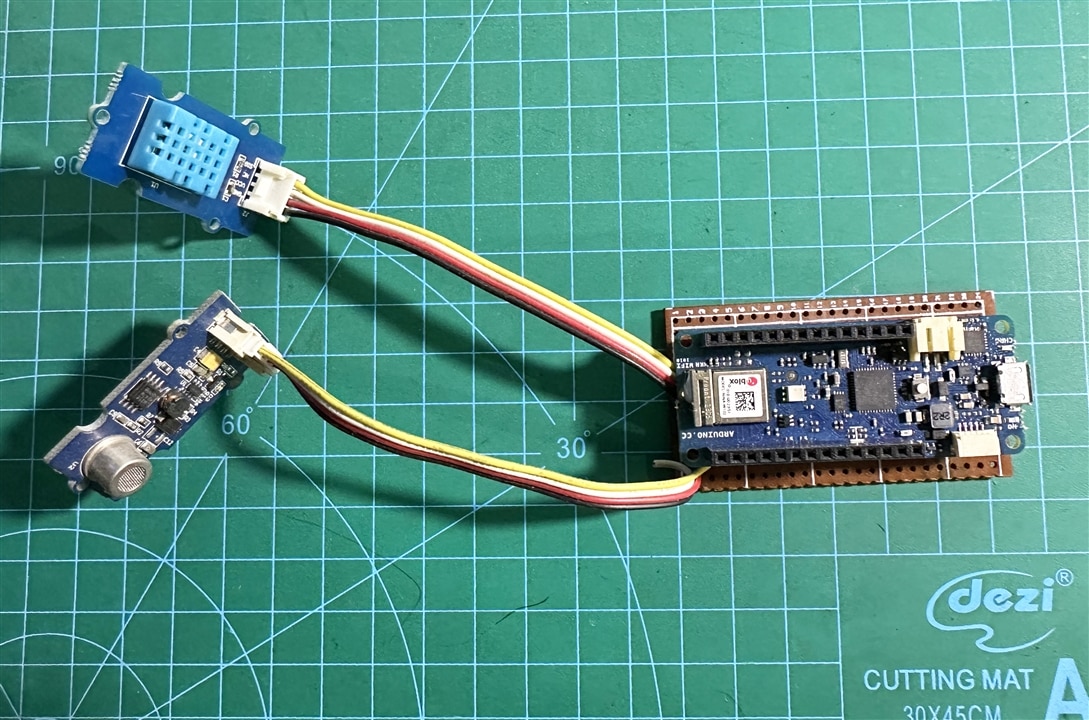

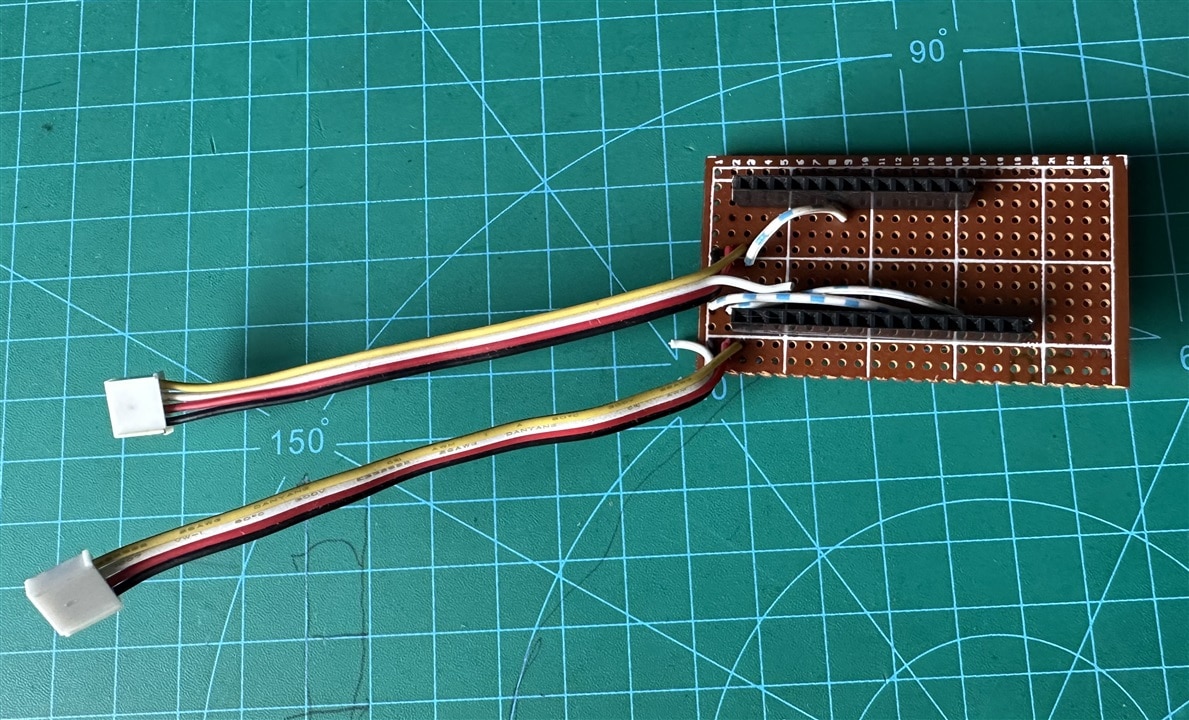

Connecting Hardware (Sensor Unit)

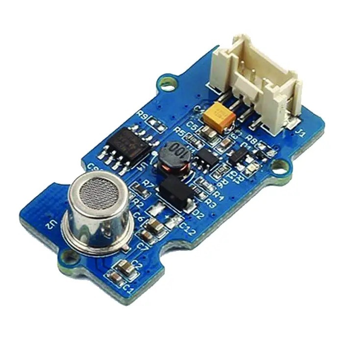

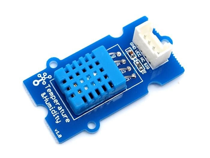

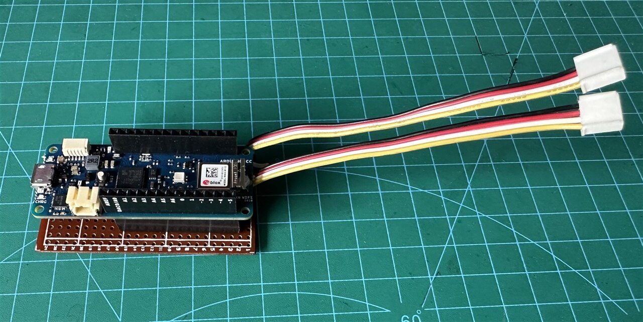

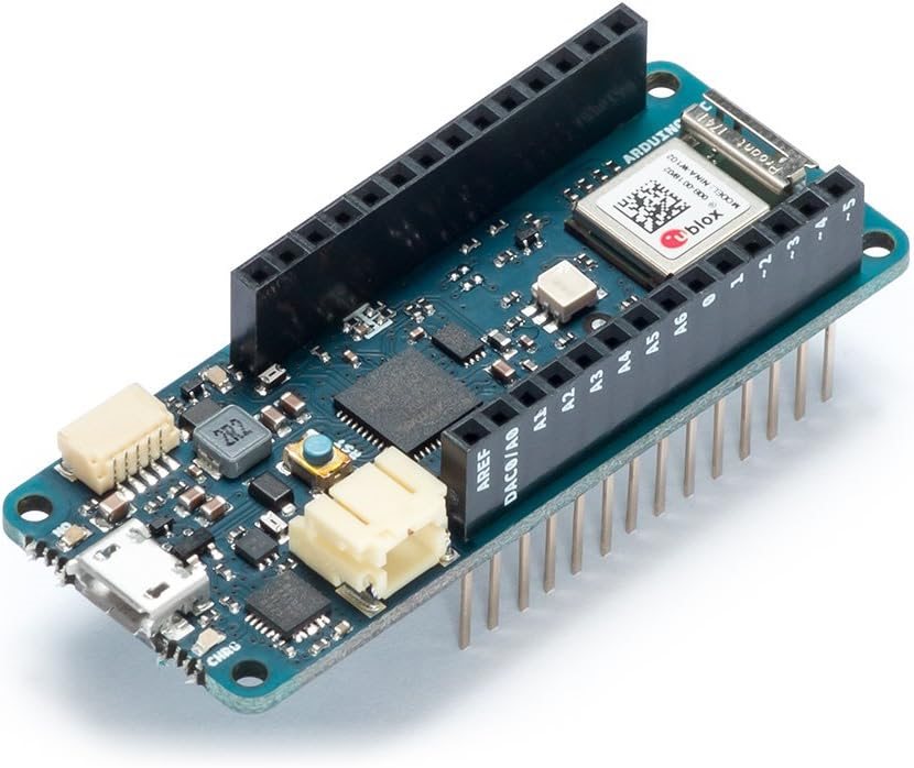

The Arduino MKR WiFi 1010 board comes with male pins on bottom side and female header on top. It makes it easy to connect external sensors with both female and male herders. The board also has a Qwiic connector but no Grove connector. For my warehouse worker safety project I need to connect a grove DHT11 temperature and humidity sensor and a grove air quality sensor. As the board has no grove connector and I don't have any grove shield for the MKR board, I prepared a PCB using a piece of perf-board.
I cut a Grove cable in the middle and solder both pieces into the PCB board so that I can connect two sensors. DHT11 sensor needs a digital pin and air quality sensor need an analog pin to communicate with Arduino.

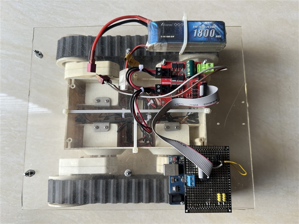

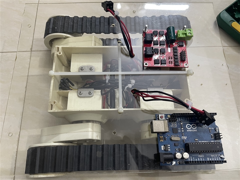

The Robot Base
The robot base will carry the sensor unit and move around the warehouse for monitoring and collecting sensor data. Building hardware is hard and more than hard for building robots where you have to work with lots of motors and sensors. When you have several medium or high-power motors in your project, providing the required amount of power also appears as a real challenge. Even sometimes you will get unstable behavior from your robot for not choosing the right size/type of wire. Making a bot from scratch involves lots of soldering and wiring works. Choosing a ready-made chassis can help to save a plenty amount of time. As the total project contains many tasks and the deadline is approaching soon, I selected a DFRobot Rover 5 tank chassis for the robot base to reduce some unnecessary complexity. I attached an acrylic sheet on top of the chassis by using zip ties.

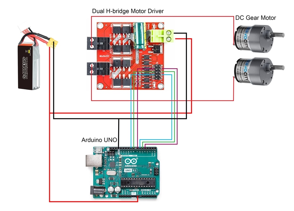

I used a Dual DC Motor Drive Module 7A 160W, 24V for driving the motors. Using some M3 screws and nuts I attached the motor driver board and Arduino board on top of the acrylic base as shown in the image below.
The motors are going to get power from a 3 cell lipo battery. I will also provide power to Arduino board from the lipo battery through VIN pin.
For making a stable connection from Arduino board to Motor Driver board I used a 10 pin jumper connector. I used a piece of PCB perf board to make like an Arduino shield and jumper is connected to the board using double line 10 pin male header.
The motor, motor driver and Arduino connections are shown in the following connection diagram:

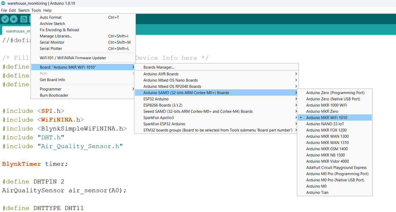

Then for programming I started with the example program for Arduino MKR 1010 board that was included in the Blynk library. I made all the necessary modification in the code and uploaded the code to the Arduino MKR board.
This kept this part totally independent from the robot controller unit. For robot controlling a separate Arduino is used. Both Arduino used independent code. Following is the code for sensor unit that was uploaded t the Arduino MKR WiFi 1010.

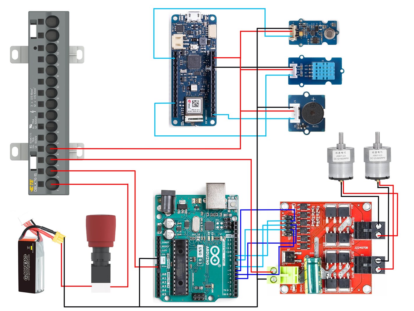

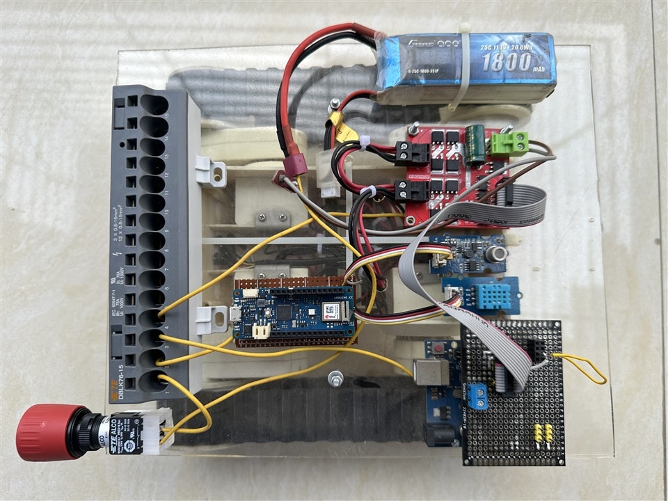

The Complete Connection Diagram

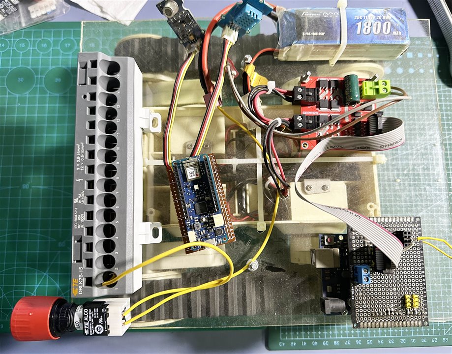

Following image shows the connection among all the hardware components. The Arduino MKR board is responsible for only sensor data collection, making alert and uploading the data to the cloud. The moving base has nothing to do with it. On the other side, the motor driver board is connected with Arduino UNO. That board has no connection with the sensor unit. Two units are working independently.

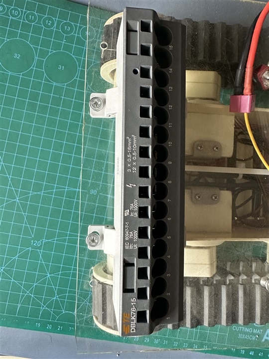

Distributing power to a complex project is not a easy task where lots of power connections is required. In my project I need to distribute 12V supply from the battery to different parts like motor driver board, microcontroller unit and the sensor unit. A power distribution block can be a good choice for this purpose. Here I am using the TE DBLK POWER DISTRIBUTION BLOCKS based on PI-Spring (Push-In & Spring) technology, specially designed for power distribution  in control panel. No screw is required for this block and helps to save connection time.
The sponsor TE for this challenge provided DBLK76-15 power distribution block which is a high power 15 port distribution block, highly overrated for my project.

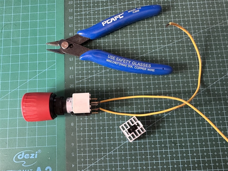

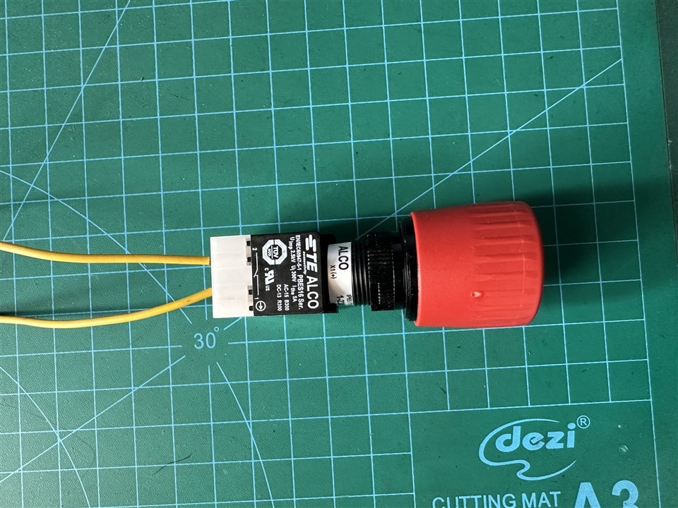

Above connection diagram shows the power connections among different components with the TE emergency switch. The following images show the connection of TE Emergency Stop switch.
Placement of the power distribution board and switch.
Connecting TE Power Terminal
I attached M3 nuts to attached the TE Power distribution terminal block with the robot base.
Then, I distributed the power to the motor driver board, and two Arduino boards. The power is in to the distribution block using TE Emergency switch.
