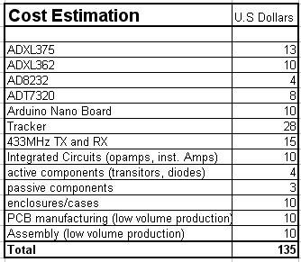

15. Cost of the Product
The cost of this system will be low since it does not involve any expensive components, materials, or software platforms.  I estimate the cost of low volume production to be around $135 and the cost of a large volume production to drop down to around $50-$70.  Here is a table with my estimates for low volume production:
