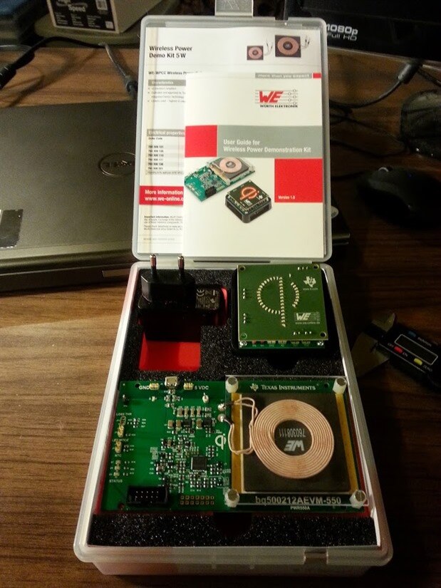

When i first got the kit i was very impressed by how nicely it was assembled. The box makes it easy to travel with. The only problem i had up-front was that the USB charger was a European model. <Sarcasm> it's not like i have a ton of USB chargers laying around or anything </Sarcasm>.

I will admit, in person i was surprised at how thick the primary coil was. A quick check with calipers (without removing it) showed around 0.080".

This had me worried because my application relies on a low-profile receiving coil that i could stick behind a mouse. Thankfully, looking at the receiving block: Most of it is just air. I don't know why it is quite so large, but as a "kit" this is rather convenient, as it is much easier to dis-assemble.
