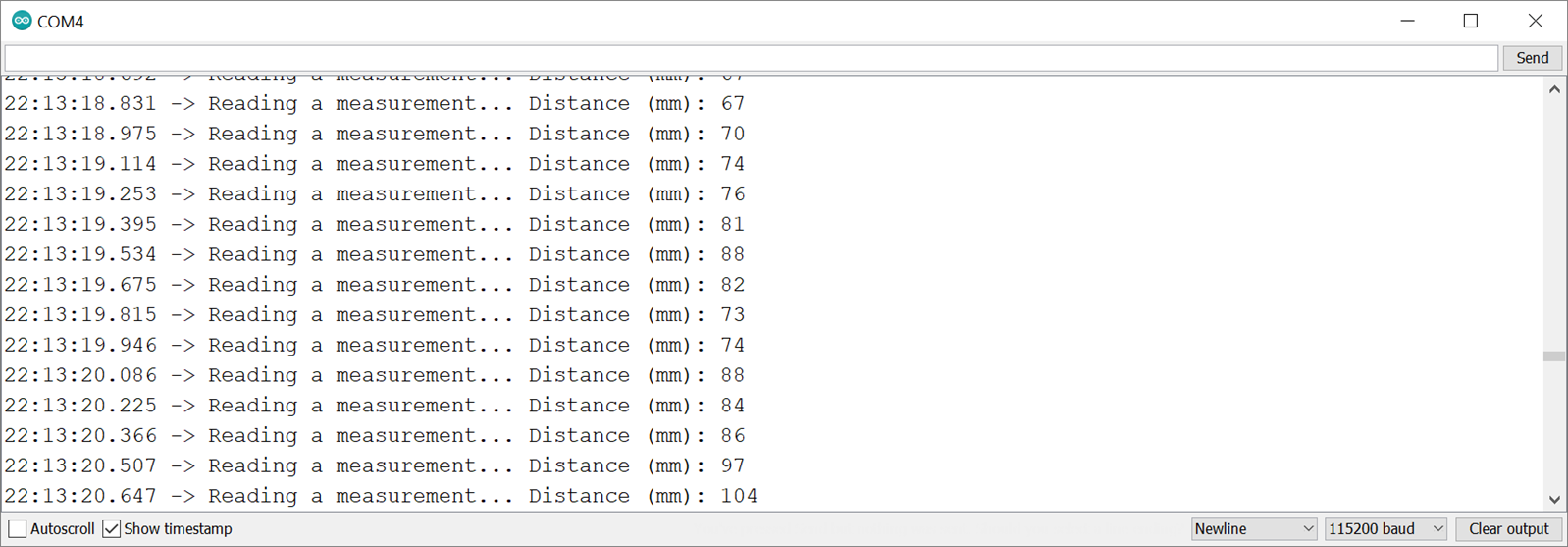

These are pretty neat. Basically a LIDAR unit. These are configured to be used with ST's Nucleo development board, and their documentation is a little spotty if you're planning on using it as the whole satellite board without the Nucleo. They are breakoff boards, so you can bust it down to just the VL53L0X piece but then you need some other components. Also, part of the challenge with this was that the ST libraries didn't cooperate with the MKR Zero, as its a SAM-D board. There's some differences in the dependent libraries like Wire which added to the challenge. ST has an example with gesture recognition that I was never able to get working. In the end it was ok, it was still easy to get the distance measurements from the chips which was all I really needed.

    So after some struggle, i've worked out the pinout on the breakoff portion of the TOF boards. It appears ST "intends" for them to be used with their nucleo eval board setup which with header sockets soldered…
