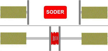

    I don't understand why the solenoid powered version was rigged like it was.  It seems like it the idea would have worked better if the can was pushed against instead of being pulled against the solenoid.  Also, having to pierce a hole through the can was a little ridiculous.
    Maybe have two solenoids opposite each other that fire in unison at a can in the middle.  Obviously taking care to actually have it mounted on something and have a shield of sort in place to prevent the cans from firing off like a pinball.

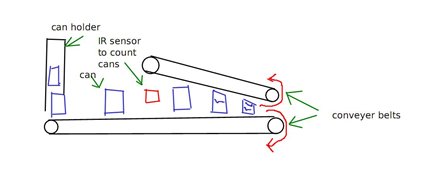

    What if you used two belts to crush the can instead of stomping on each can.
