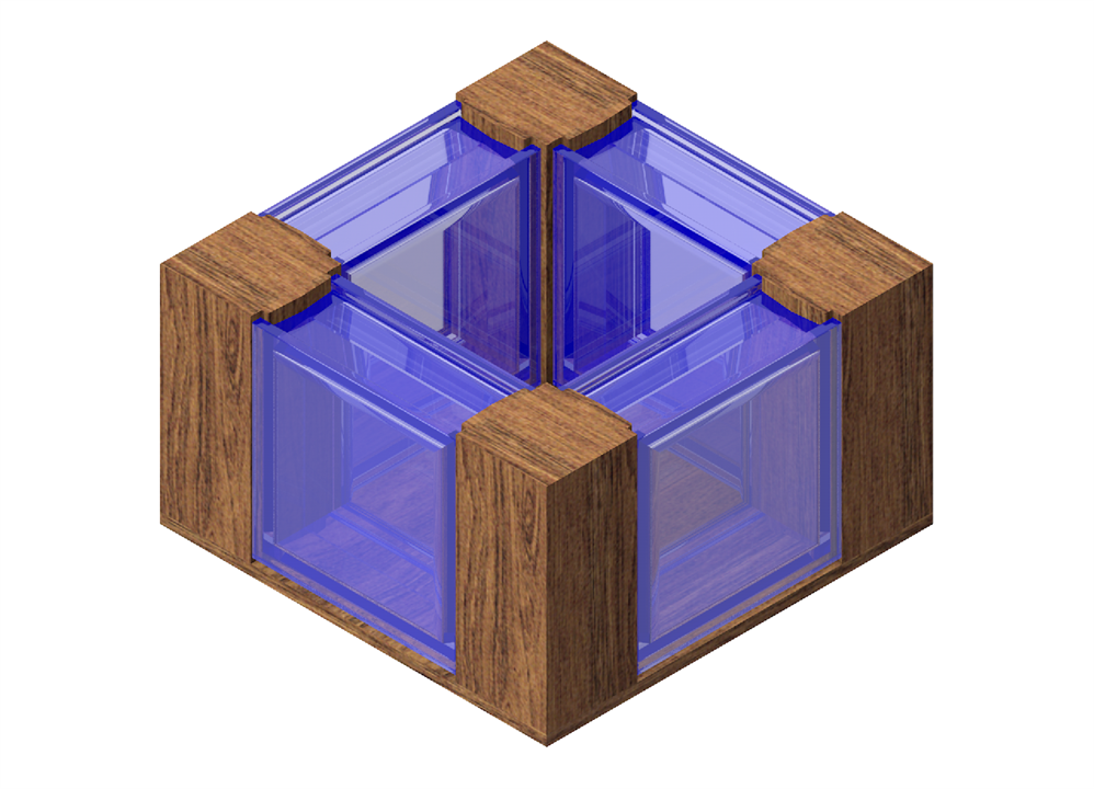

    For stacking, then perhaps something like this might work:
    If you use stock square section planed timber / T-slot, then perhaps 3D-print some shims to match the profile of the glass bricks which can then be screwed onto the frame as required. Can leave space in the shims to take LED pixel strip for edge lighting or slots for one-way mirrors/gobos/transparencies.
    You could quickly create different frames for different projects and just slot the bricks in as required during assembly.
