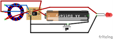

Learn how to get more bang from your battery by using an inductor to make a battery juicer that can run a flashlight off a single, used battery.

    I have been experimenting with the circuit and I found that the 2N2222 will allow the battery to be drained down to about 0.6 Volts. If on the other hand you use a Germanium NPN transistor the circuit will continue to drain the battery all the way down to 0.2 volts before it stops working. If we are going to Juice the battery we might as well drain it as low as possible.
