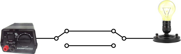

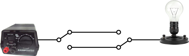

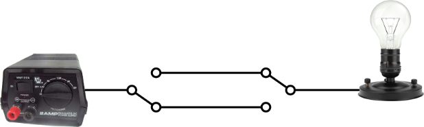

Many homes have lights that can be turned on by more than one switch. Karen goes over how these switches work and how to wire one into your project circuit.

    Great explanation of the circuit, Karen! I'm glad to know that I'm not the only one whose bothered by the whole "switch is up but light is off" concept! image

    This is of course possible but it is contrary to traditional function of slide switches. I saw you had one of these switches. Why not take an ohm meter and verify the position for confirmation. I would be fascinated to see the physics of the internal contacts if you are correct.

    I'm not sure that you're right for this particular switch. Here's a clip from the data sheet. Unless I'm reading it wrong, A is on when 1-2 are connected and B is on when 1-3 are connected. Those pins are on the opposite side of the slide position.

    Yep. Here in the US we call the the circuit, with the crossover switch in between, a 4 way switch.  Interesting how the same thing is labeled differently in different countries.

    Is this what you call 3 way lighting in America?
    I would be used to calling this 2 way lighting, and 3 way lighting would have a third intermediate switch between the 2 changeover switches.

    Very nice presentation of the 3-Way switch configuration. At the very end your explanation of the position of the toggle with respect to the closed contacts was correct but the position of the slide switch with respect to the closed contacts is actually the opposite from what you indicated. The contact follows the slide and this means that the closed contact is always on the same side as the slider.
