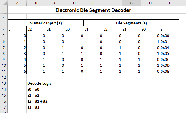

If you look at the dot pattern on the faces of a six sided die, you will notice there are a few common pairs of dots:
Take for example the dots on the 2 side, neither of those dots are every displayed individually, so we can group them together as one segment. Similarly, we can group the other 2 opposing corner dots as a segment. Here is how I wired up 7 LEDs to represent the six faces of the die:

  • scottiebabe
    scottiebabe over 4 years ago
    I only just realized how simple the decode logic for an electronic die actually is...
