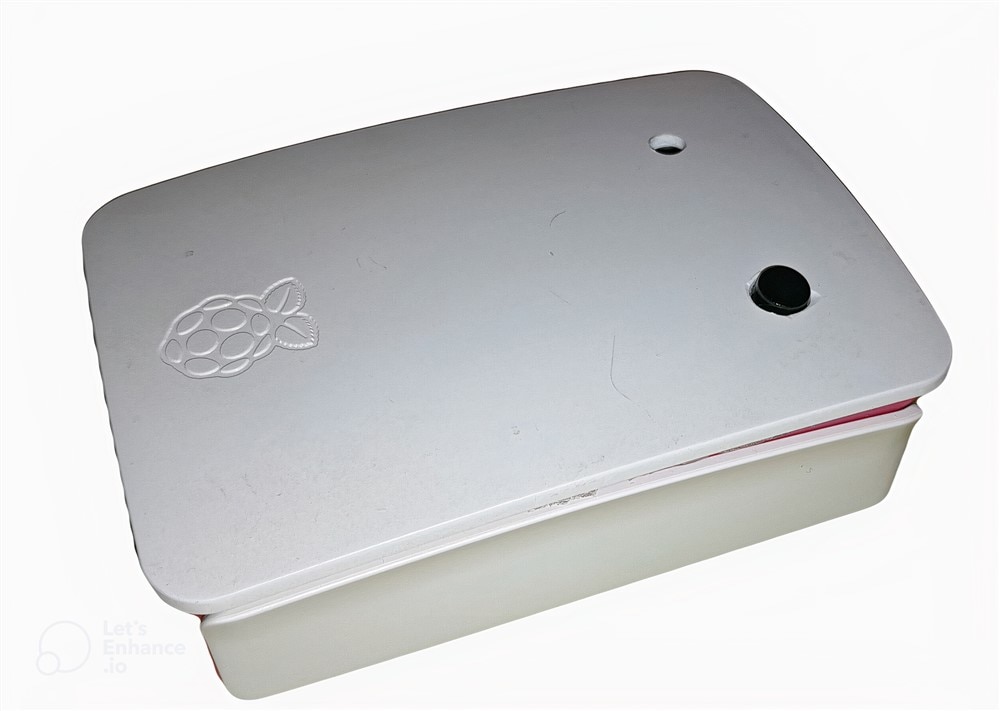

Hardware Hookup
For audio, I plugged an amplifier into the Pi 3 audio jacket.
The button is connected between GPIO2 and ground.
Nothing else needed , except a Wi-Fi connection and power.

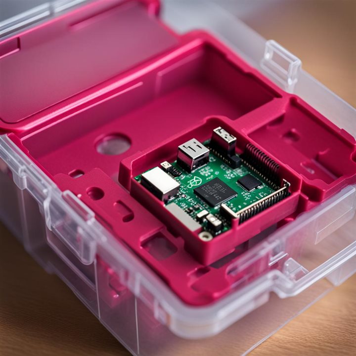

I asked AI to design the hardware:
housing design: nightcafe
This is the real housing :
image AI enhanced with LetsEnhance.io
