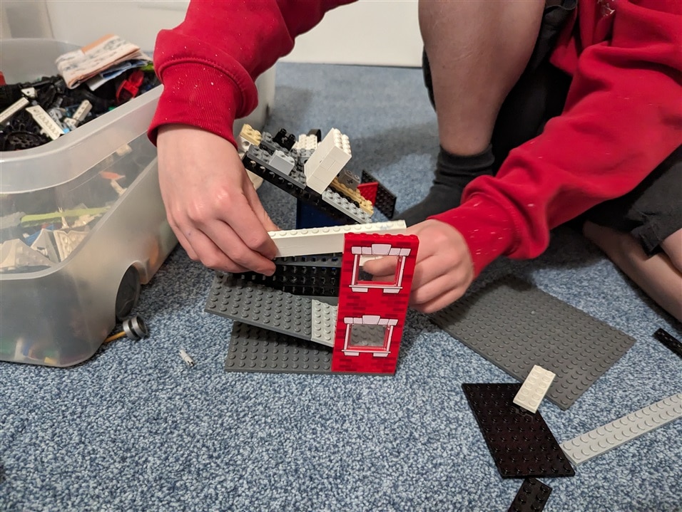

So, the Lego build is gradually evolving. Here's a version one of building two ramps so the dropped prize comes out of the front of the machine.
Getting better... The ramps are in place and a bit sturdier. The dropper is attached to the motors which are firmly embedded in the walls. The colour sensors are on top of a handmade Lego Raspberry Pi case (to the rear)- although Farnell had some Lego i cases on offer, so a few are on the way to be added to the mix soon. That pocket-sized switched mode power supply is one of my favourite electronics purchases. It might not have the greatest specs, but it's perfect for this sort of thing when you need a random 8V for the BuildHat.
Lego build continues
I find it can be easy to order lots of "that's bound to be useful" parts thinking that you're advancing your project, but I managed to hold off and ensure that the concept was sound before jumping into buying parts.
The Lego Boost only has one motor and one color sensor, so it was off to eBay to find some more. I ended up paying £28 for the electronic parts from the Boost, but I have seen whole sets go for similar prices (or less). We now have all the Lego parts we need.
My Farnell order also turned up. Using a proper BuildHat power supply should make the project a little less fragile. I'm also hoping that my son's interest in using the BuildHat continues, and this shoud make it easier for him to do things on his own. No more setting voltage on a PSU and plugging in banana leads. No risk of releasing any magic smoke.
It also turns out that with a Dremel and a set of needle files you can just get a Pi3 and a BuildHat into the Multicomp Lego (sorry generic building block) case that Farnell stock here.
Lego Pi case modified to fit a BuildHat
It's a very tight fit. Because of the connectors poking through on two sides, you have to flex and squeeze the lid onto the BuildHat first and then clip the lower part of the case on. Some internal supports for the Pi's mounting holes and the unused camera mounting have to be removed too.
