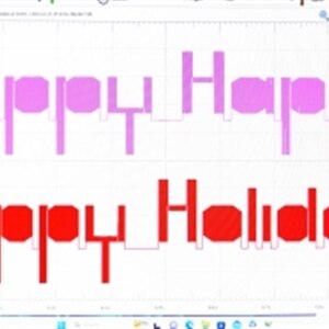

The first image is produced just using the Digilent AD3 which can generate 2 arbitrary waveforms and display them on its 2 scope channels.
The second image shows all four waveform generators being displayed on  the RTB2004 scope.
These types of image were inspired by some work by  ...Thumbsup
I did not have a great way to synchronize the 2 waveform generator instruments yet, so the image is manually triggered when the traces are in the correct phase.
The scope can change the color of each channel, but it does not have a wide selection of colors.
Here is an example:
The Digilent scope has full control over colors so here is what it can do to get close to proper colors on the logo:
Unfortunately, it doesn't have enough channels to color everything properly or fully form the letters, but I like the display and its flexibility. We will just have to wait for Digilent to make a 4 channel version of the Analog Discovery. It could very appropriately be called the AD4 Relaxed
