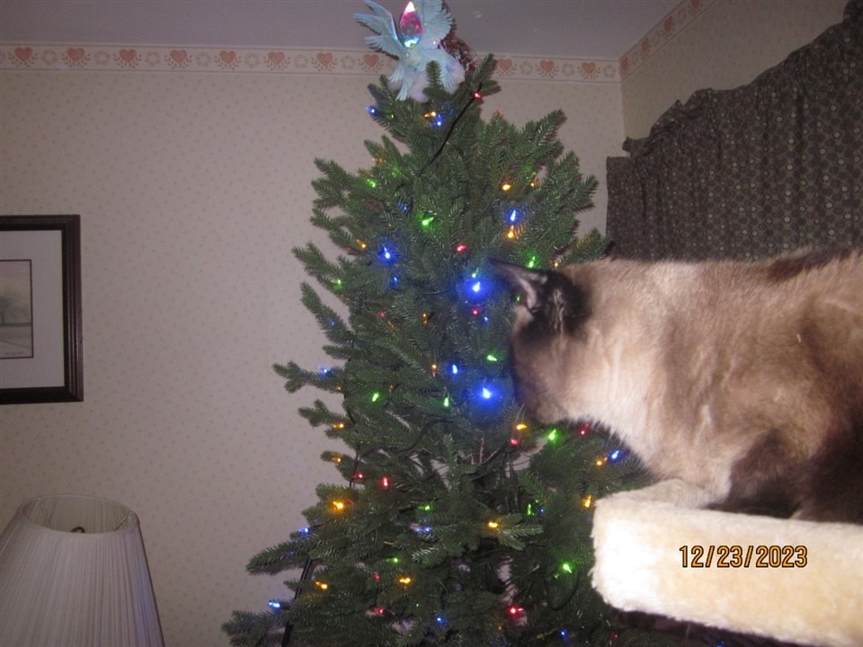

Lets open with the video link of finished tree topper, in Christmas tree, getting intense scrutiny from  the kitties:

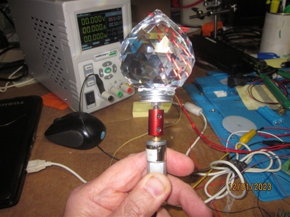

A PVC pipe is used to slide over the top of the Christmas Tree branches.
A smaller PVC pipe, hot glued to the support pipe, is used to support the neopixel, and cover the drive shaft, motor coupling, and motor.

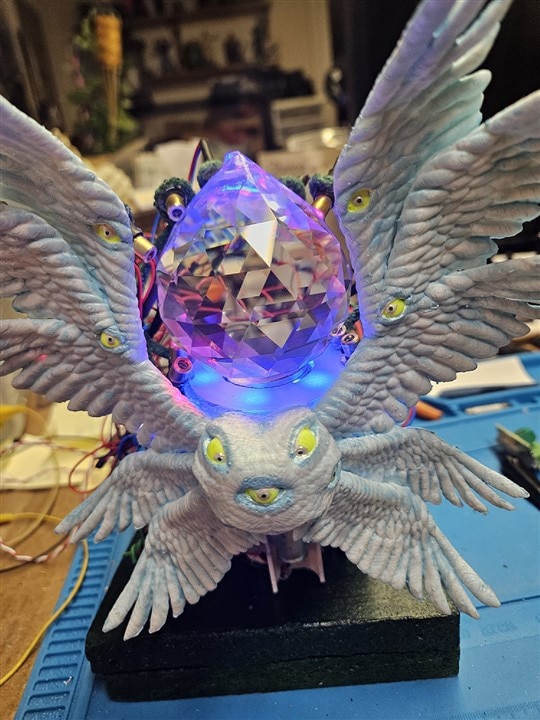

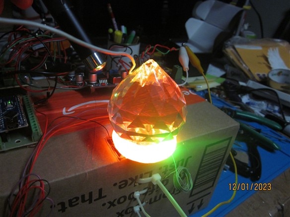

A 60mm crystal suncatcher crystal acts as a prism and reflector. Spinning the suncatcher slowly would reflect light and lasers everywhere and drive the cats nuts.
Placing a neopixel ring underneatch the crystal looks really cool just running an Arduino demo example.
Laser testing started with 3 colors of laser pointers. I destroyed a blue laser pointer modifying the laser pointers to mount on the tree topper. The green laser consumed 350mA at 3V by itself. I scrapped using laser pointers as they were too bulky.

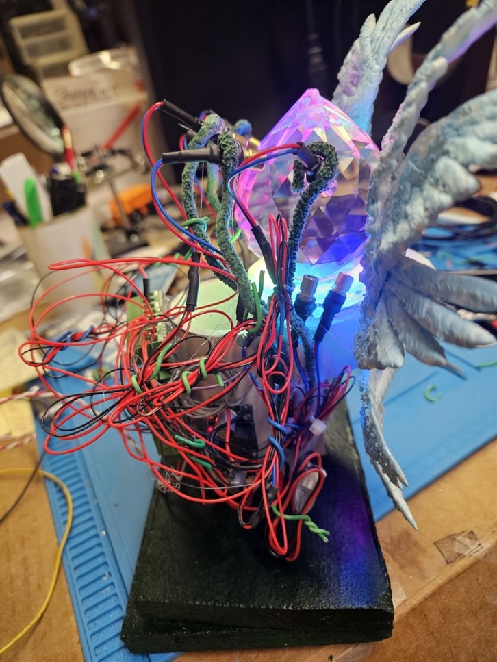

An Arduino Nano controls the neopixels and lasers. The lasers are arranged in pairs, a lower laser and upper laser. This reduces the # of IO needed, but requires a power driver per pin.

Trial 2 uses qty 10 standard 5V 5mW red lasers, measured at 30 mA each.

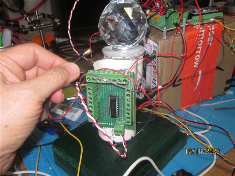

A ULN2803 hex driver IC is used to drive the laser pairs, 100mA per point.  A special board was built for wiring the lasers conveniently with a lot of extra Vccs and COM.

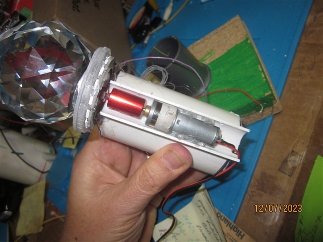

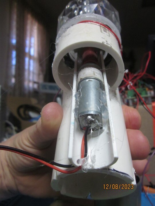

First to mount the crystal beacon and motor assembly into a protective PVC tube that would also support the neopixel ring.
The motor mount would be hot glued to the tube that sides over the top of the christmas tree.
The crystal assembly is top heavy, so a base needed built for the remaining construction and to have a tabletop display.

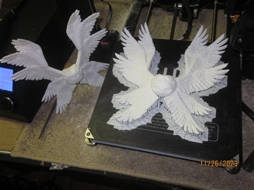

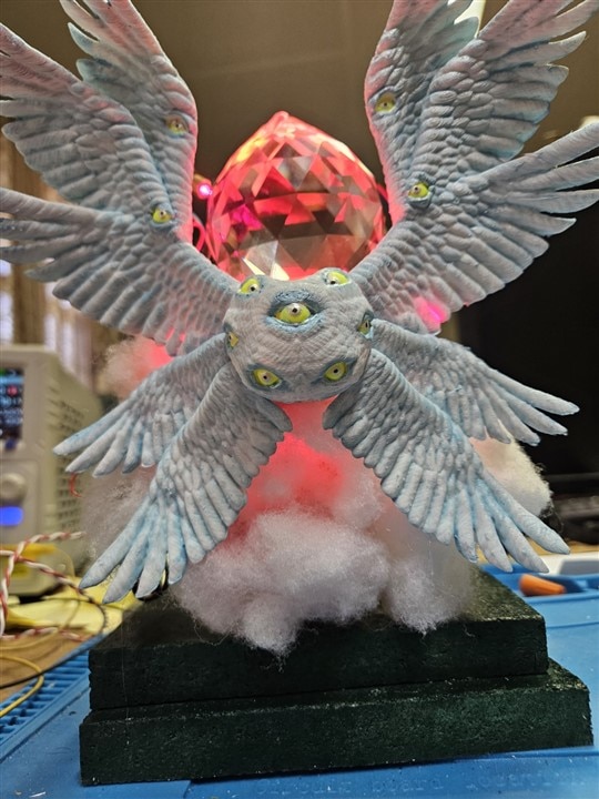

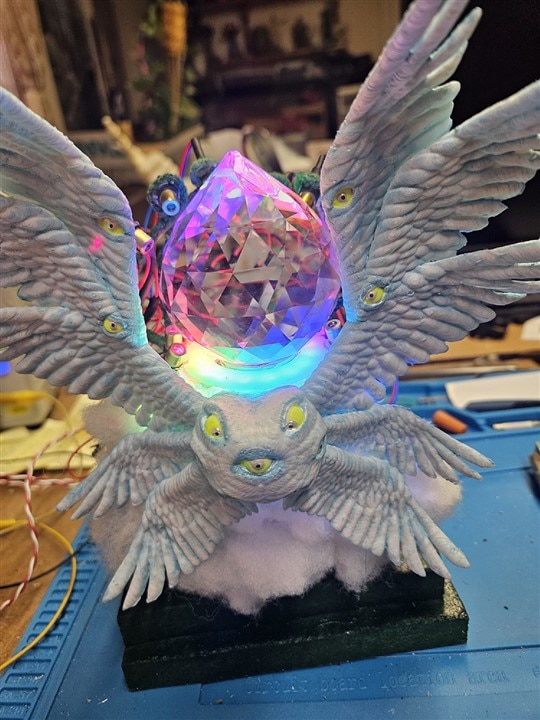

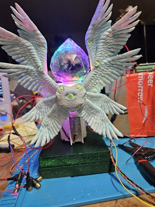

The Angel: biblical rendition is powerful and a touch creepy.

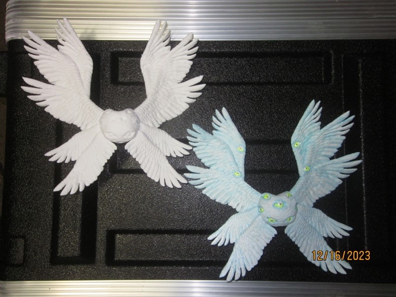

It took 35 hrs to 3D print one in white PLA ,. https://www thingiverse.com/thing:5153207
Latex metallic pearl paint, tinted with baby blue was thinned,  washed on the printed angel and gently wiped off to create lines in the relief.
Fluorescent yellow eyes, silver iris, green pupil completed the angel. I printed 2 just in case......
The painted angel compared to the unpainted.
The next step is to add the angel to the motor beacon assembly.

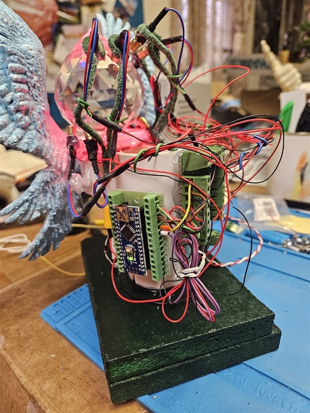

Now to move the control cards from the test stand to the tree topper.
This is the ULN2803 driver card for switching the 10 lasers off and on, and 5V power distribution.
The Arduino Nano for controlling the Neopixel and lasers.
An LM2596 buck power supply is the motor speed control. The PS is set for 2 volts out. It is buried under the laser wiring.
a 5V wall wart powers the tree topper.
The upper lasers are mounted on pipe cleaners so they can be re-aimed as needed.
The motor assembly and tree topper base are covered in cotton to emulate clouds.
I didnt take closeup photos of the Kitty Teasing Angelic Animated Beacon tree topper because they didnt convey any revealing new information........
BUT the videos were really nice with the projected colors and laser dots and driving the kitties crazy trying to catch them.
