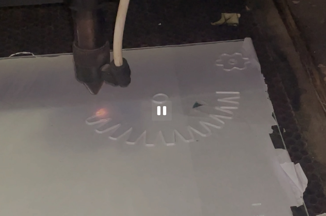

For organizing the LEDs I used a 2 mm acrylic sheet. The spacing between two pins of a 5 mm LED is 2.54 mm. So 2 mm acrylic sheet is the right selection and it fits well with the LED. I distributed the LEDs into 12 layers. For arranging LEDs in layers I laser cut the acrylic sheet in gear form. The cut sheets are shown below. The design files are attached in a zip file at the last.
At the center of the design, there is a hole that will be used for passing wires from one layer to another. Three M3 size drill holes are made in every layer for attaching one layer with the other using M3x15mm hex spacers. In layer 11 (the bottommost layer) there are 28 teeth and it gradually reduced by two towards the top.

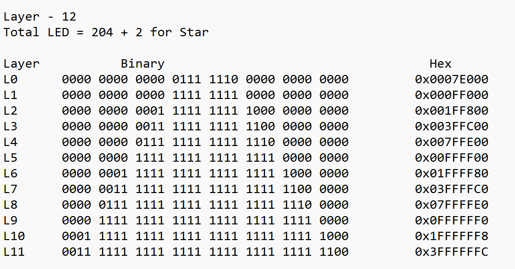

Topmost layer has 6 LEDs. At the top, a star is placed with 5 teeth. The LED distribution is as follows:
28 -> 26 ->  24 -> 22 -> 20 -> 18 -> 16 -> 14 -> 12 -> 10 -> 8 -> 6 (Total: 204 + 2 for start)
The diameter of the bottom layer is 140mm and is gradually reduced by 10mm on every layer.

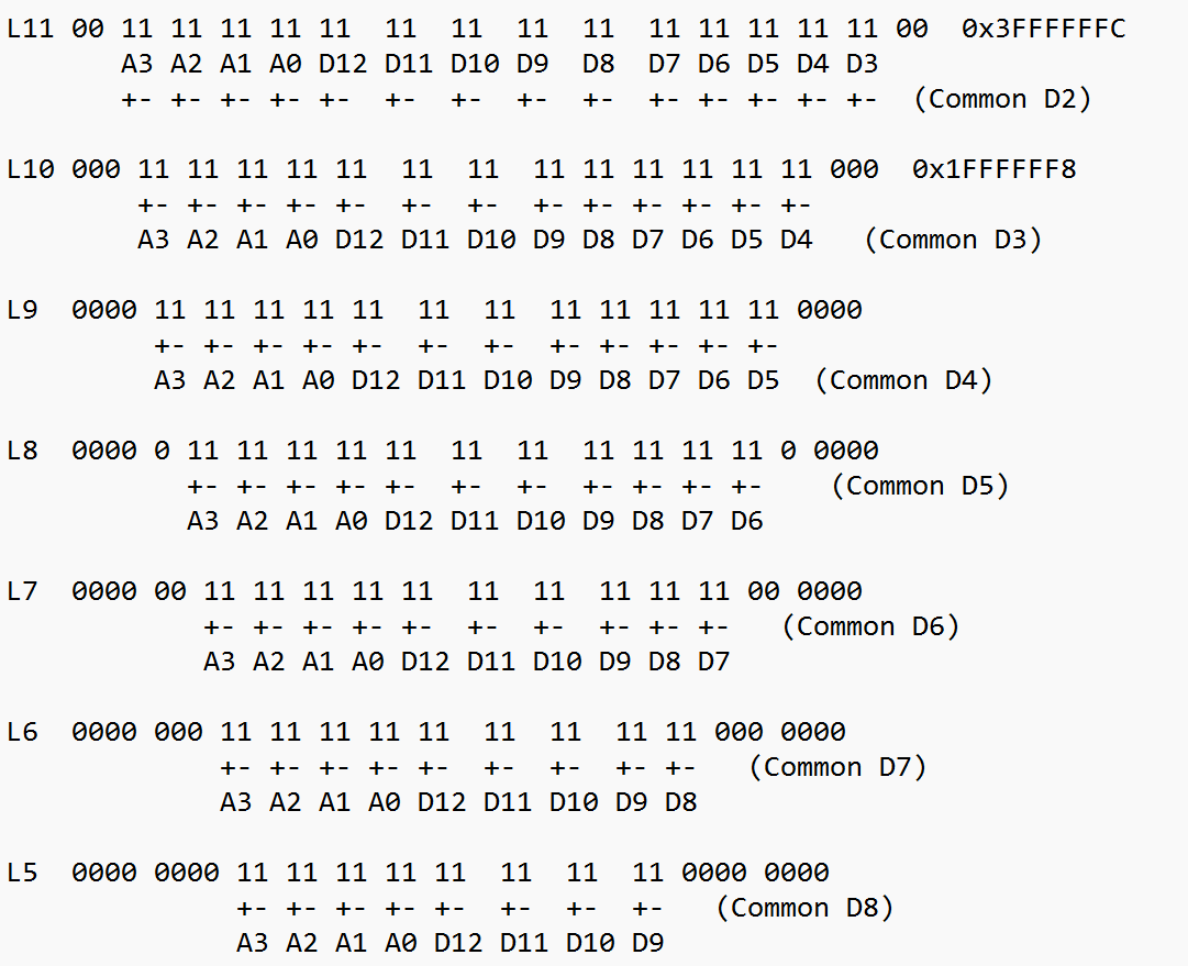

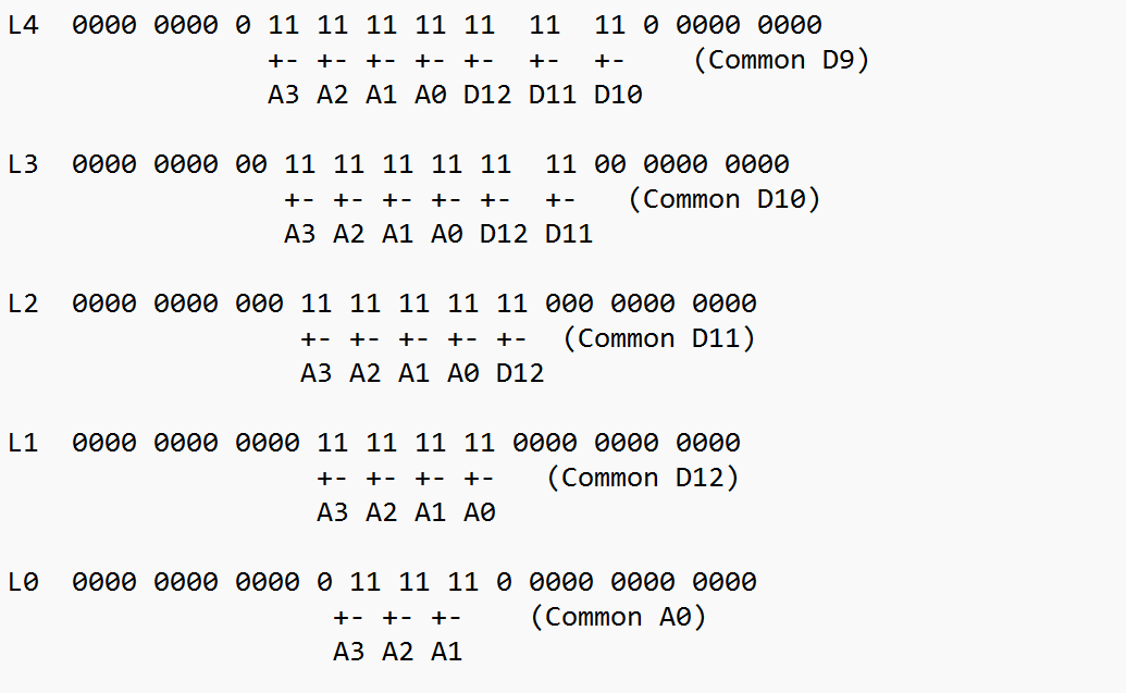

LED placement of a layer is shown in the following image. Every adjacent LED has the opposite polarity. On one side all the LED pins are soldered together with a copper wire and it looks like a ring. On the other side, two adjacent LEDs are connected with opposite polarity. Every layer has an even number of teeth.

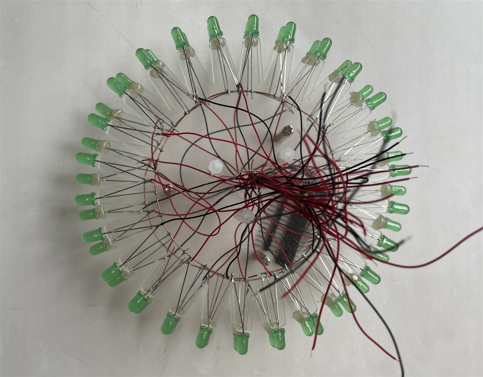

I was curious about how it is going to look after attaching all the layers. So, I arranged one after another and it looks like below without any space.
Now, it is time to attach the layers. I added two layers together using three 15mm male-to-female Nylon hex spacers. For connecting LEDs to the Arduino pins I used 24 AWG single strand insulating wire.

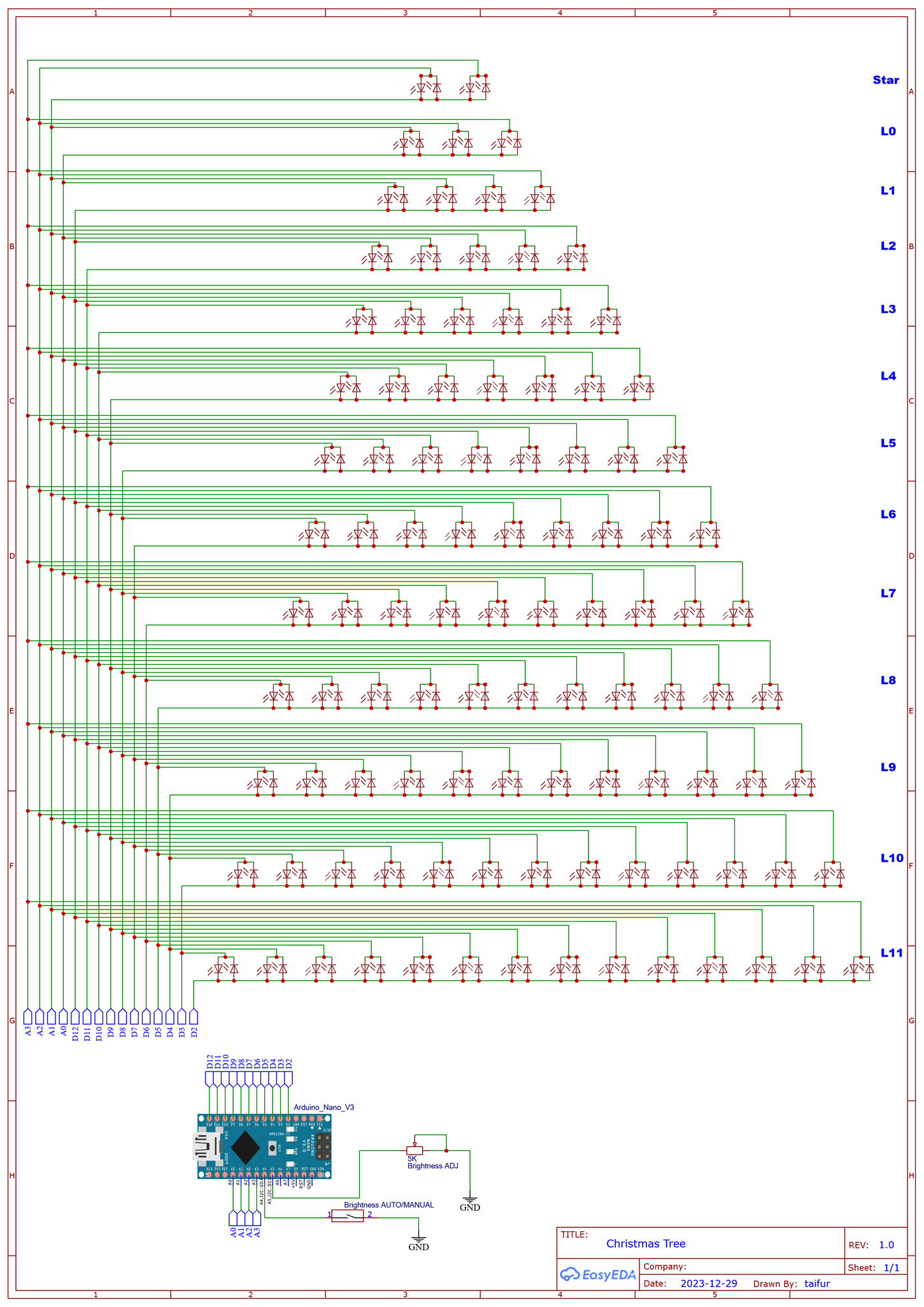

I made the Arduino circuit with a switch and resistor in a perfboard.
I used male pin headers for attaching the circuit board with the LED tree.
For the programming, I used the Arduino platform and this program does not need any additional libraries. However, an understanding of timer and timer interrupt is required. Timer 2 was utilized in the sketch. For controlling every layer an uint32 value is used. The value for turning all the LEDs is as follows.
Connections of the layer LEDs with the corresponding pins are illustrated in the following screenshot. It will help you to better understand the Arduino sketch. Let me explain a little more about the connection and control bit. If we consider layer 11, there are 28 LEDs for layer 11 and the common side of the layer is connected to the D2 pin of the Nano. On the common side, the anode of 14 LEDs and the cathode of the other 14 LEDs are connected all together with the copper ring. The minus sign (-) of the above screenshot represents the cathode and the plus sign (+) represents the anode of the LED. That means the anode of the rightmost LED is connected to the D3 pin and the cathode is connected to the D2 pin. Then for the next LED, the anode is connected to the D2 pin, and the cathode is connected to the D3 pin. So, if we want to connect right most LED then D2 should be low and D3 should be high.

      Ly[5] ^= 0b00000000001000010000000000000000;
      Ly[6] ^= 0b00000000010000010000000000000000;
      Ly[7] ^= 0b00000000100000010000000000000000;
      Ly[8] ^= 0b00000001000000010000000000000000;
      Ly[9] ^= 0b00000010000000010000000000000000;
     Ly[10] ^= 0b00000100000000010000000000000000;
     Ly[11] ^= 0b00001000000000010000000000000000;
      break;
    case 8:
      Ly[2] ^= 0b00000000000000100000000000000000;
      Ly[3] ^= 0b00000000000001100000000000000000;
      Ly[4] ^= 0b00000000000010100000000000000000;
      Ly[5] ^= 0b00000000000100100000000000000000;
      Ly[6] ^= 0b00000000001000100000000000000000;
      Ly[7] ^= 0b00000000010000100000000000000000;
      Ly[8] ^= 0b00000000100000100000000000000000;
      Ly[9] ^= 0b00000001000000100000000000000000;
     Ly[10] ^= 0b00000010000000100000000000000000;
     Ly[11] ^= 0b00000100000000100000000000000000;
      break;
    case 9:
      Ly[4] ^= 0b00000000000001000000000000000000;
      Ly[5] ^= 0b00000000000011000000000000000000;
      Ly[6] ^= 0b00000000000101000000000000000000;
      Ly[7] ^= 0b00000000001001000000000000000000;
      Ly[8] ^= 0b00000000010001000000000000000000;
      Ly[9] ^= 0b00000000100001000000000000000000;
     Ly[10] ^= 0b00000001000001000000000000000000;
     Ly[11] ^= 0b00000010000001000000000000000000;
      break;
    case 10:
      Ly[6] ^= 0b00000000000010000000000000000000;
      Ly[7] ^= 0b00000000000110000000000000000000;
      Ly[8] ^= 0b00000000001010000000000000000000;
      Ly[9] ^= 0b00000000010010000000000000000000;
     Ly[10] ^= 0b00000000100010000000000000000000;
     Ly[11] ^= 0b00000001000010000000000000000000;
      break;
    case 11:
      Ly[8] ^= 0b00000000000100000000000000000000;
      Ly[9] ^= 0b00000000001100000000000000000000;
     Ly[10] ^= 0b00000000010100000000000000000000;
     Ly[11] ^= 0b00000000100100000000000000000000;
      break;
    case 12:
      Ly[11] ^= 0b00000000001000000000000000000000;
      break;
    default:
      break;
// Light up the corresponding LED with Charlie Plexing
// corresponding DDR bit is 1 for OUTPUT
void d2High() { // Output High from D2 and light the specified LED (turn the other port Low)
  if ( Ly[11] & 0x10000000 ) DDRD |= B00001000; // D3
  if ( Ly[11] & 0x04000000 ) DDRD |= B00010000; // D4
  if ( Ly[11] & 0x01000000 ) DDRD |= B00100000; // D5
  if ( Ly[11] & 0x00400000 ) DDRD |= B01000000; // D6
  if ( Ly[11] & 0x00100000 ) DDRD |= B10000000; // D7
  if ( Ly[11] & 0x00040000 ) DDRB |= B00000001; // D8
  if ( Ly[11] & 0x00010000 ) DDRB |= B00000010; // D9
  if ( Ly[11] & 0x00004000 ) DDRB |= B00000100; // D10
  if ( Ly[11] & 0x00001000 ) DDRB |= B00001000; // D11
  if ( Ly[11] & 0x00000400 ) DDRB |= B00010000; // D12
  if ( Ly[11] & 0x00000100 ) DDRC |= B00000001; // A0
  if ( Ly[11] & 0x00000040 ) DDRC |= B00000010; // A1
  if ( Ly[11] & 0x00000010 ) DDRC |= B00000100; // A2
  if ( Ly[11] & 0x00000004 ) DDRC |= B00001000; // A3
  DDRD |= B00000100; // Assign D2 to output
  PORTD |= B00000100; // D2 High. Now turn on the LED (do this last to minimize the amount of light)

  if ( Ly[5] & 0x00001000 ) DDRB |= B00000001; // D8
  if ( Ly[4] & 0x00002000 ) DDRB |= B00000010; // D9
  if ( Ly[3] & 0x00004000 ) DDRB |= B00000100; // D10
  if ( Ly[2] & 0x00010000 ) DDRB |= B00001000; // D11
  if ( Ly[1] & 0x00010000 ) DDRB |= B00010000; // D12
  if ( Ly[0] & 0x00040000 ) DDRC |= B00000010; // A1
  DDRC |= B00000010; // Assign A1 to output
  PORTC |= B00000010; // A1 High. Now turn on the LED (do this last to minimize the amount of light)
void a2High() { // Outputs High from A0 and lights up the specified LED (turns the other port Low)
  if ( Ly[11] & 0x00000020 ) DDRD |= B00000100; // D2
  if ( Ly[10] & 0x00000040 ) DDRD |= B00001000; // D3
  if ( Ly[9] & 0x00000080 ) DDRD |= B00010000; // D4
  if ( Ly[8] & 0x00000100 ) DDRD |= B00100000; // D5
  if ( Ly[7] & 0x00000200 ) DDRD |= B01000000; // D6
  if ( Ly[6] & 0x00000400 ) DDRD |= B10000000; // D7
  if ( Ly[5] & 0x00000400 ) DDRB |= B00000001; // D8
  if ( Ly[4] & 0x00000800 ) DDRB |= B00000010; // D9
  if ( Ly[3] & 0x00001000 ) DDRB |= B00000100; // D10
  if ( Ly[2] & 0x00004000 ) DDRB |= B00001000; // D11
  if ( Ly[1] & 0x00004000 ) DDRB |= B00010000; // D12
  if ( Ly[0] & 0x00010000 ) DDRC |= B00000010; // A1
  DDRC |= B00000100; // Assign A2 to output
  PORTC |= B00000100; // A2 High. Now turn on the LED (do this last to minimize the amount of light)
void a3High() { // Outputs High from A0 and lights up the specified LED (turns the other port Low)
  if ( Ly[11] & 0x00000008 ) DDRD |= B00000100; // D2
  if ( Ly[10] & 0x00000010 ) DDRD |= B00001000; // D3
  if ( Ly[9] & 0x00000020 ) DDRD |= B00010000; // D4
  if ( Ly[8] & 0x00000040 ) DDRD |= B00100000; // D5
  if ( Ly[7] & 0x00000080 ) DDRD |= B01000000; // D6
  if ( Ly[6] & 0x00000100 ) DDRD |= B10000000; // D7
  if ( Ly[5] & 0x00000100 ) DDRB |= B00000001; // D8
  if ( Ly[4] & 0x00000200 ) DDRB |= B00000010; // D9
  if ( Ly[3] & 0x00000400 ) DDRB |= B00000100; // D10
  if ( Ly[2] & 0x00001000 ) DDRB |= B00001000; // D11
  if ( Ly[1] & 0x00001000 ) DDRB |= B00010000; // D12
  if ( Ly[0] & 0x00004000 ) DDRC |= B00000010; // A1
  DDRC |= B00001000; // Assign A3 to output
  PORTC |= B00001000; // A3 High. Now turn on the LED (do this last to minimize the amount of light)
