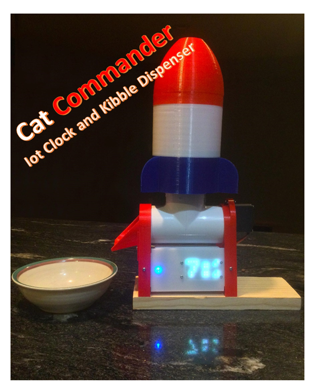

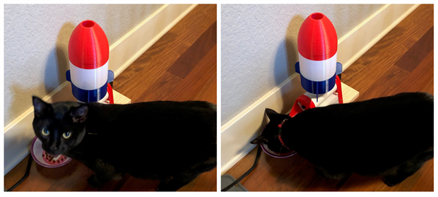

We present a clock that synchs itself with the Network Time Protocol (NTP), feeds cats, and can be controlled wirelessly.
Features
This is the kind of fun that can happen when working with 7 to 9 year old children image
The Cat Commander iot Clock and Kibble Dispenser has the following features:
  • Timeless style that looks great with any décor
  • Synchs automatically on startup for accurate time keeping using NTP
  • Scrolling time and helpful messages displayed on RGB LED matrix
  • Kibble reservoir stores enough food for two or more cats for several days
  • Up to two feedings per day at user set times
  • Adjustable feed amount
  • Wireless User Interface works with smart phones, tablets, and computers

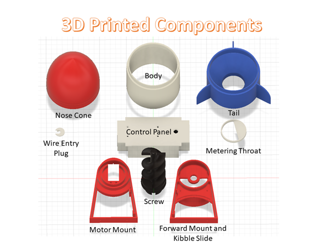

Mechanical Fabrication and Construction
The 3D printed parts were designed in Fusion 360 and printed on an Anycubic I3 Mega printer with PLA filament.  The main body of the metering section is a 1 1/2 inch Sch. 40 PVC pipe tee from the local hardware store.  The modeled parts are shown below and described in the sections that follow.
All parts can be printed without supports but the screw was split and printed in halves axially which were then glued together.

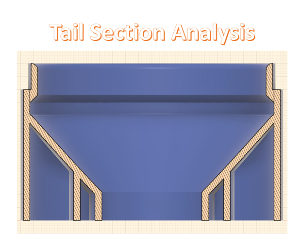

Kibble Storage
Parts:  nose cone, body, and tail
Kibble (coarsely ground meal or grain typically used as animal feed per Merriam-Webster) is stored in the rocket ship shaped silo atop the metering section.  The nose cone can be lifted off for refilling.  The tail section has an internal funnel that fits snugly over the metering section and can be removed for cleaning.  The tail section and body were glued together.

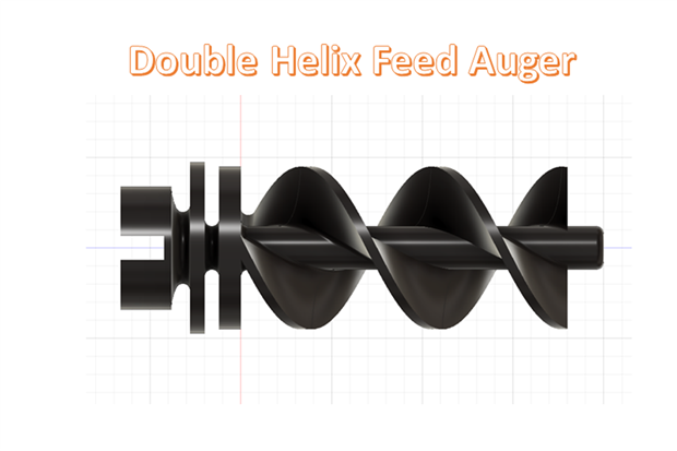

Metering and Delivery
Parts:  PVC tee, metering throat, screw / auger, motor mount, 360 degree servo motor, forward mount, kibble slide, 2 mm nuts and bolts
The metering and delivery section is contained inside a 1 1/2 PVC tee and kibble is fed into the top of the tee.  A 3D printed piece that is friction fit into the throat of the tee regulates and directs feed towards the back of the body of the tee.  A screw (auger) in the body of the tee drives the kibble out of the front towards a slide.  The device positively displaces the kibble so metering can be controlled by the number of rotations of the screw.  The screw is driven by a 360 degree servo (MG-360) and a slide at the front of the tee directs the kibble towards a bowl.
Every so often the screw can eject kibble roughly as it exits due to catching on the face of the mount.  This does not materially impact performance but could be improved with a change in geometry and tolerances.

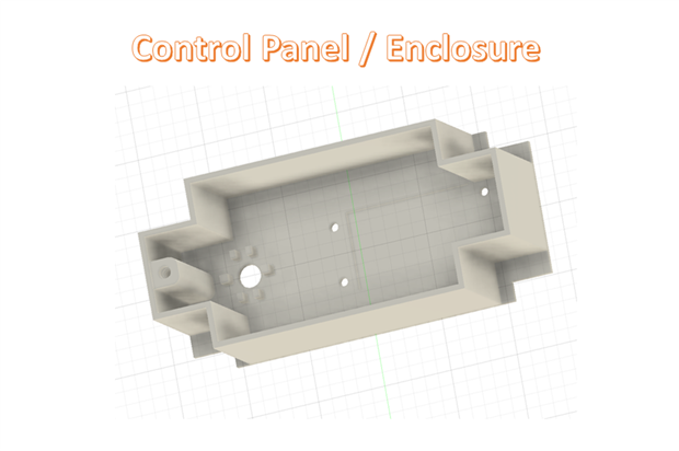

Control Panel and Enclosure
Parts: control panel enclosure, control panel back, wire entry plug, 3 mm threaded brass insert and screw, cable management sleeve
The electronics are contained in a 3D printed enclosure with an integrated panel.  The RGB LED matrix attaches to the panel with four 2 mm bolts, 6 mm long.  The button switch with LED slips into a mount with fingers to hold it to the panel and are hot glued in place.  The back to the enclosure was printed separately and presses into the enclosure with a single 3 mm screw to keep it firmly in place.  A threaded brass insert heat pressed into the enclosure allows easy and repeated removal and reattachment of the back.  Power for the electronics and control to the servo is through a hole in the enclosure back with a wire entry plug to keep things tidy.  The USB cables were encased in a 1/4" cable management  sleeve for tidiness.

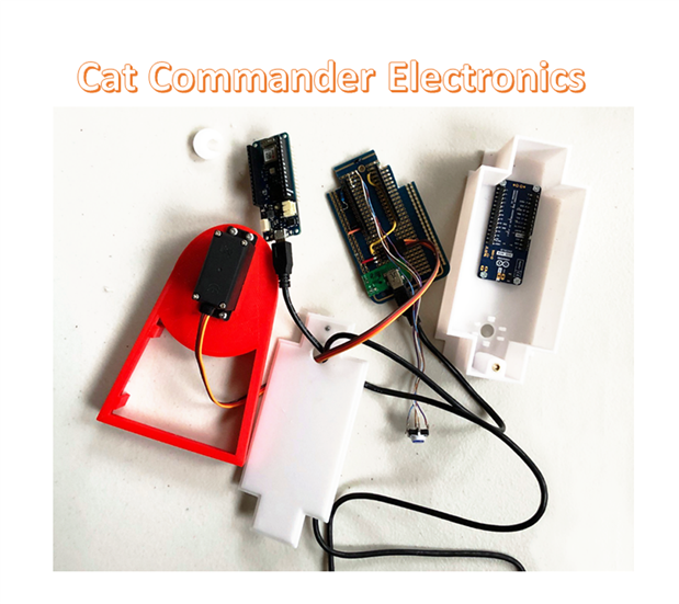

Electronics

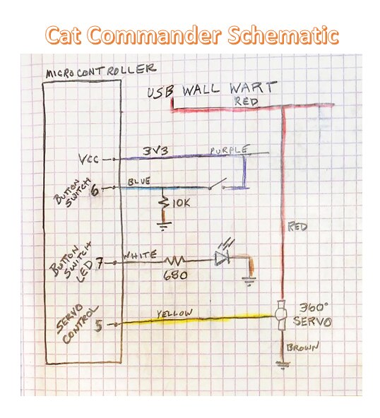

Parts: Arduino MKR 1010 microcontroller, Arduino MKR RGB shield, protoboard, dual USB wall wart and cables, momentary switch with LED, assorted bits and wire
Thanks to element14 and Tariq for providing the Arduino parts sometime back as a reward for participation in Project14.  The electronics are straight forward and were prototyped on a breadboard before soldering up on protoboard configured as a breadboard which eased development and construction.
Unfortunately it was soldered "upside down" and as a result the display was upside down.  This was not originally considered an issue as the Adafruit RGB libraries allow the display to be rotated in software.  This turned out to not be the case for the Arduino library and due to time the protoboard was rotated and notched out so that it would fit the enclosure.  To accomplish the fit of the USB connection it was necessary to move the RGB matrix further from the center than originally planned.
Because the motor draws a fair amount of current, especially when starting, it requires a separate power source and the motor used requires 5V or greater.  Using what was at hand, a section from a surplus PCB with an SMD USB footprint was cut out and soldered to the protoboard (the green PCB section visible in the photo below) to provide power for the motor.  The final assembly is tight and fiddly but neat.

 * Servo Leads:  Red = Power from separate source
 *               Brown = Ground connected to Arduino
 *               Yellow = Servo control, Arduino pin 5
 * Button: Purple = Power from Arduino Vcc to button switch
 *         Blue = Button swich pulled down connected to Arduino pin 6
 *         White = LED on button switch connected thru 680R to Arduino pin 7

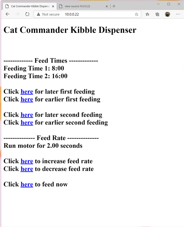

void webPage() {
  if (client) {                             // check if there is a cllent
    String currentLine = "";                // string to hold incoming data from the client
    while (client.connected()) {            // loop while the client's connected
      if (client.available()) {             // check for byte to read from the client,
        char c = client.read();             // read a byte, then
        if (c == '\n') {                    // respond only when there is new line
          // if the current line is blank there were two newline characters in a row.
          // that's the end of the client HTTP request, so send a response:
          if (currentLine.length() == 0) {
            // standard response header
            client.println("HTTP/1.1 200 OK");
            client.println("Content-Type: text/html");
            client.println("Connection: close");
            client.println();
            // web page
            client.println("<!DOCTYPE html>");
            client.println("<html>");
            client.println("<head>");
            client.println("<title>Cat Commander Kibble Dispenser</title>");
            client.println("</head>");
            client.println("<body>");
            // Title
            client.println("<h1>Cat Commander Kibble Dispenser</h1>");
            // feeding times
            client.println("<h2>");
            client.print("<br><br>------------- Feed Times -------------<br>");
            for (int i = 0; i < FEEDINGTIMES; i++){
              client.print("Feeding Time ");
              client.print(i+1);
              client.print(": ");
              client.print(feedingTime[i].h);
              client.print(":");
              if (feedingTime[i].m < 10){
                client.print("0");
              client.print(feedingTime[i].m);
              client.print("<br>");
            // create the adjust time buttons
            client.print("<br>Click <a href=\"/UP1\">here</a> for later first feeding<br>");
            client.print("Click <a href=\"/DOWN1\">here</a> for earlier first feeding<br>");
            client.print("<br>Click <a href=\"/UP2\">here</a> for later second feeding<br>");
            client.print("Click <a href=\"/DOWN2\">here</a> for earlier second feeding<br>");
            // feed rate
            client.print("<br>-------------- Feed Rate --------------<br>");
            client.print("Run motor for ");
            client.print(feedRate);
            client.print(" seconds<br><br>");
            // create the change feed buttons
            client.print("Click <a href=\"/MORE\">here</a> to increase feed rate<br>");
            client.print("Click <a href=\"/LESS\">here</a> to decrease feed rate<br><br>");
            client.print("Click <a href=\"/FEED\">here</a> to feed now<br><br>");
            client.println("<\h2>");
            client.println();
            client.println("</body>");
            client.println("</html>");

User Interface
The User Interface runs on a server on the Arduino MKR 1010 and is only accessible locally.  It is basic at the moment but we have plans to enhance it with improved HTML and CSS which are not in my core skills at the moment.  Access from a PC, tablet, or smart phone is possible.

The project was a success in that the design criteria were met and the kids and I  enjoyed the project and learned something.  The positive aspects include:
  • Overall design is both fun and functional
  • Scrolling RGB matrix is eye catching
  • Positive displacement screw pump works well
  • Threaded brass inserts worked well and I will be using them again

  • The screw geometry and tolerances can be improved
