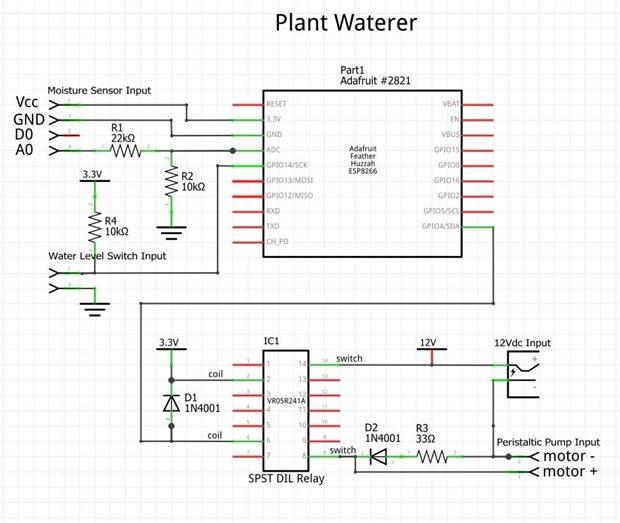

The two sensors are connected to inputs of the feather, and the water pump is controlled by an output signal from the feather. There are two built in LED’s on the feather:
  • Red: used to indicate that the soil is dry enough to warrant watering
  • Blue: Used to indicate that the bucket is empty (requires a refill of water)
There are three criteria which all have to be met in order to turn on the pump (and water the plant):
  1. There must be water in the bucket
  2. The lack of moisture in the soil must be greater than a specified threshold value
  3. A specified minimum amount of time must have elapsed since the pump was last turned off while watering.
Any one of the following criteria will cause the pump to be turned off:
  • No water left in the bucket
  • The moisture level of the soil is higher than a specified threshold value (this criteria also triggers starting of the timer which keeps track of the amount of time that has elapsed since the pump was turned off).
Basically, the feather just goes in a loop checking the criteria above and taking the necessary action. Each loop iteration takes approximately 20-30 seconds to complete.
A feature that I would also like to implement is to have the system send me a message whenever it detects that the water bucket is empty (and possibly send a new reminder each day for a week before giving up). Unfortunately I have not found any official libraries with SMTP capabilities that I can use to accomplish this, so I do not know when or if I will be able to accomplish this goal.
I have tested the system quite a bit while implementing it (during the last 2 days) and feel confident that I have found and fixed all of the problems I have encountered along the way, but experience has taught me that the test of time is a very important test – and that test has only just begun.

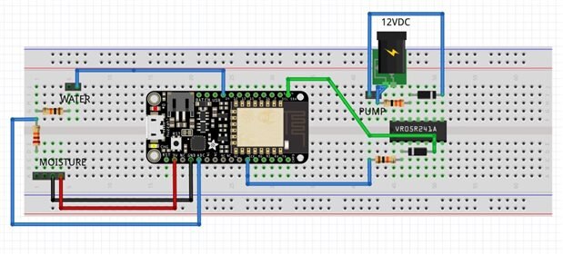

Schematic Drawing
Breadboard

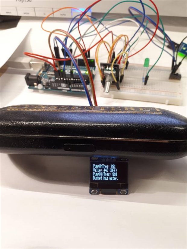

    Status update: Here is a picture of the latest breadboard configuration (although i would be amazed if it would be helpful to anyone as it looks like a rats nest). It is now connected to all the sensors…

  • urkraft
    urkraft over 8 years ago
    (sorry, but after inserting the second picture i could no longer see what was going on, so i just had to post the last entry to continue).
    After the thresholds are set the display shows the two thresholds and the current reading as well the status of the water reservoir:

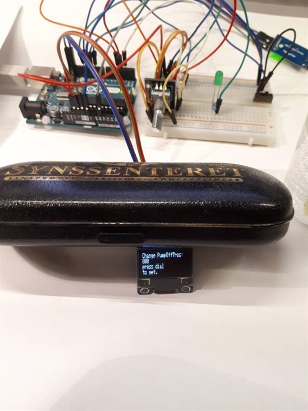

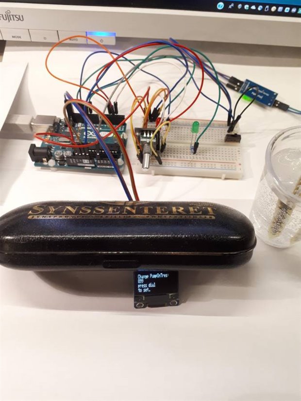

    Progress update:
    Picture of display when project is powered up:
    After adjusting the PumpOnThreshold (by turning the knob on the rotary encoder til the desired value is shown followed by pressing the knob in to select that value) you are prompted to set the PumpOffThreshold:
