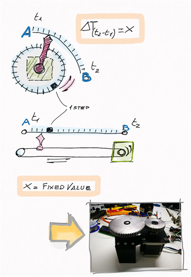

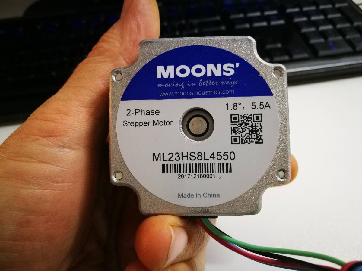

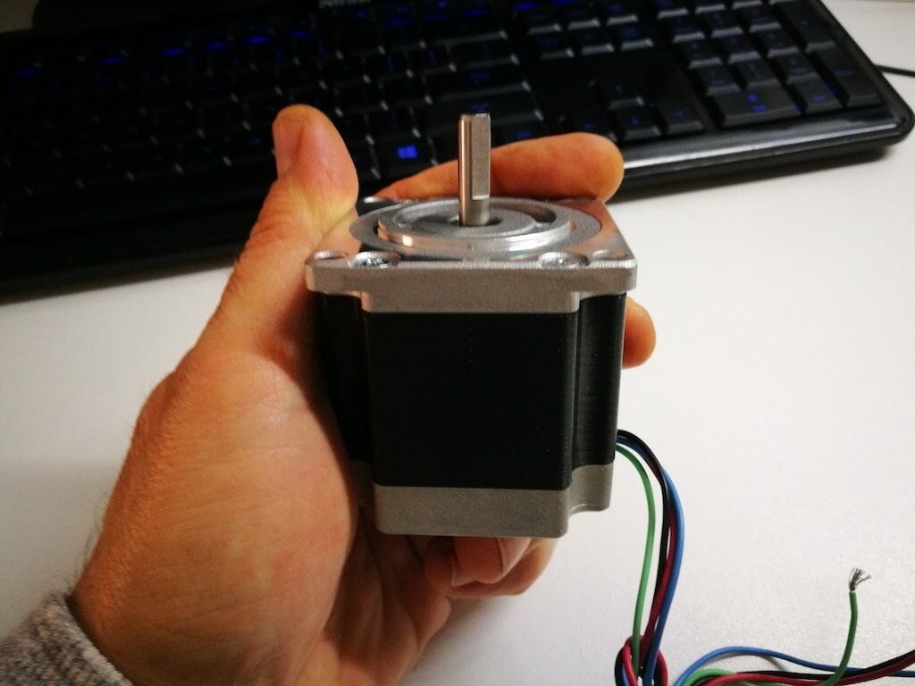

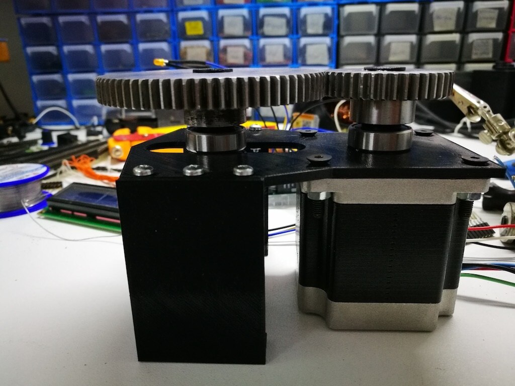

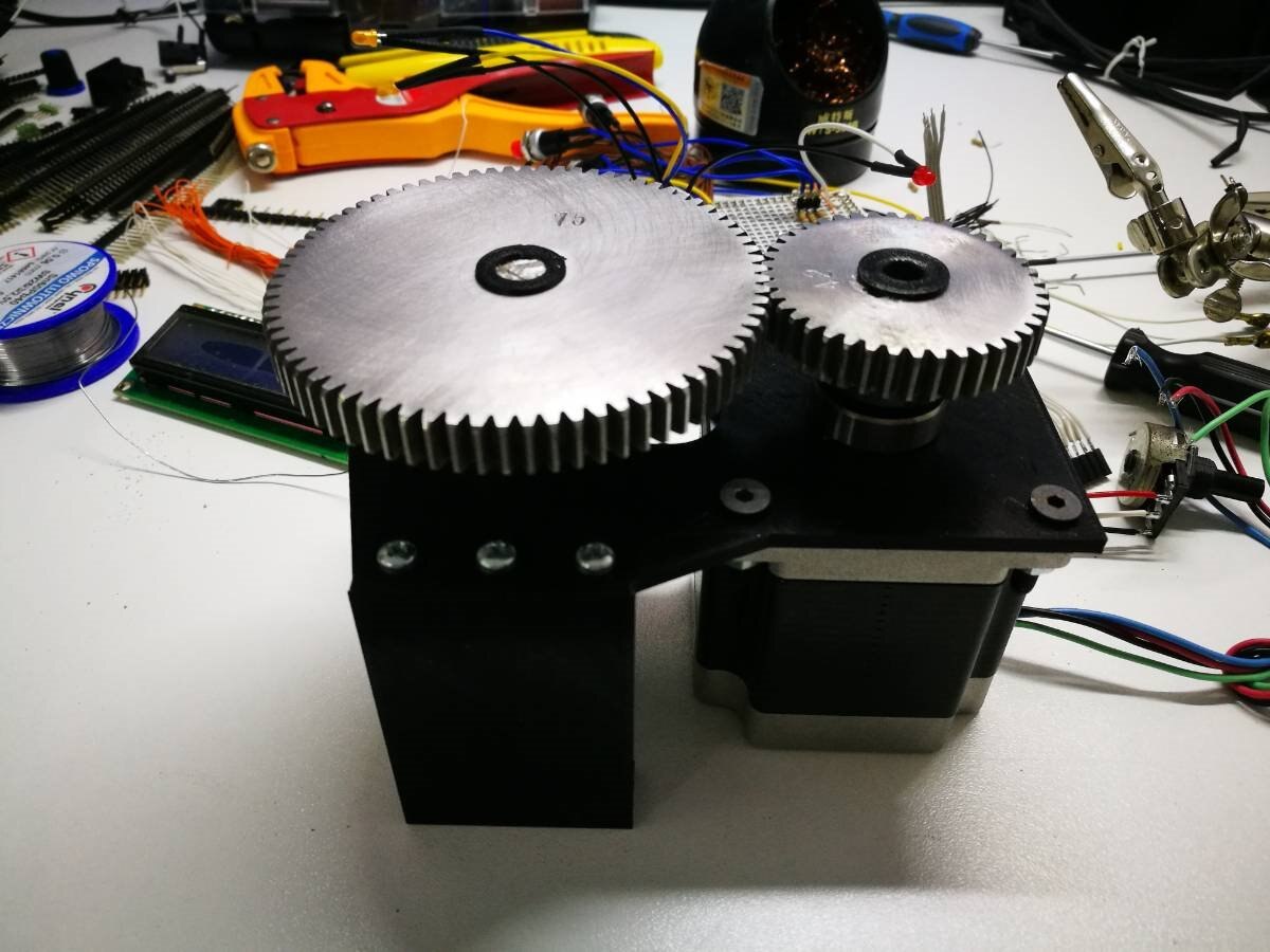

The first decision I took was using a robust stepper motor to grant the right stability an precise positioning along the curved path. The point is that the path is very uncommon respect what we are used to managing motion controlled by stepper motors; instead of managing distances, like what it is done by a 3D printer, in our case we should manage time: we need to complete the rotation semi-circular path during a predefined time. Just a few seconds of variation can be accepted and rotation should be very slow.
The image above shows the stepper motor I have used for this project. It is a 1.8 DEG per step, that means 200 steps every rotation. The average path the tool should rotate is around 90 DEG. Consider the following:
  • Angular rotation (easier to calculate than linear motion)
  • 90 DEG angle is our path
  • Time to travel: l minute (from 0 to 90 DEG)
Based on the above parameters, we deduce that
90 DEG = 1/4 of a full rotation
Resulting (theoretical) Motor speed = 0,25 RPM
At the speed of 1 RPM motor will run too fast!
A couple of gears reduction (in our case I have used a 42:75 steel gears) only solve partially the problem. Applying the reduction gear what we get is a 90 DEG rotation in about 200 steps. This is a too low limit and very difficult to control along the time. The scheme below shows the axis motion along distance respect the time needed.

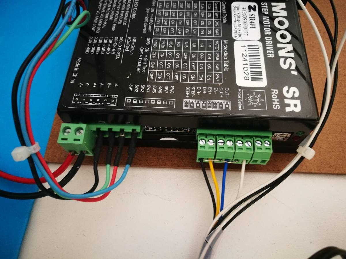

To dramatically improve the steps performances without introducing a too complex gear mechanics, the solution has been completed with a motor driver supporting micro stepping.
Due to the industrial application of the target I have used a Moon's SR stepper controller. As a matter of fact, the same theory and development can be applied using cheaper components (stepper and motor controller) without any change to the design architecture.

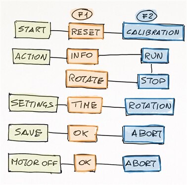

The motion system should be programmed. Not so difficult, we just need to add some buttons. But things - again - become complex because the user interface has the following requisites:
  1. Many choice options should be easy to manage by the user
  2. Last settings should be saved to be persistent after power-down
  3. Users should interact also while a sequence is running
  4. Need an emergency stop button
  5. Need end-stop switches
To support the behavior as mentioned in the points above we should exclude any possible approach based on time delays but need an interrupt driven application. In detail, we should be able to manage at least three interrupts: one emergency button and two end-stop switches.

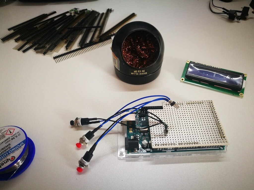

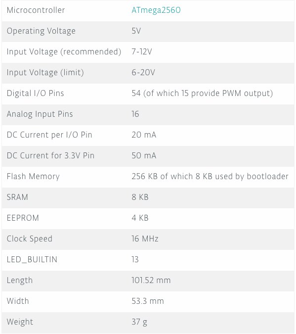

Fast prototyping the interface controller, the choice using an Arduino Mega 2560 revealed right.
256 Kb of flash is more than sufficient to write a complex software, and up to 4Kb available on EEPROM is what we need to store the user settings for persistence. We should add that the Mega2560 has 4 hardware interrupts available. Due to the available number of PINs, it was possible to connect the 16x2 alphanumeric LCD screen consuming six I/O ports without problems for better responsivity of the interface.
Prototype Design
Electronics

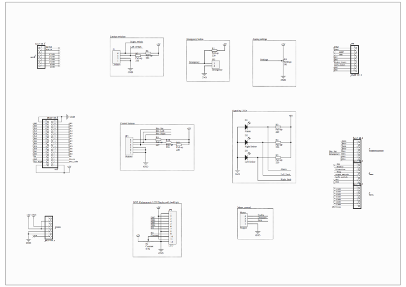

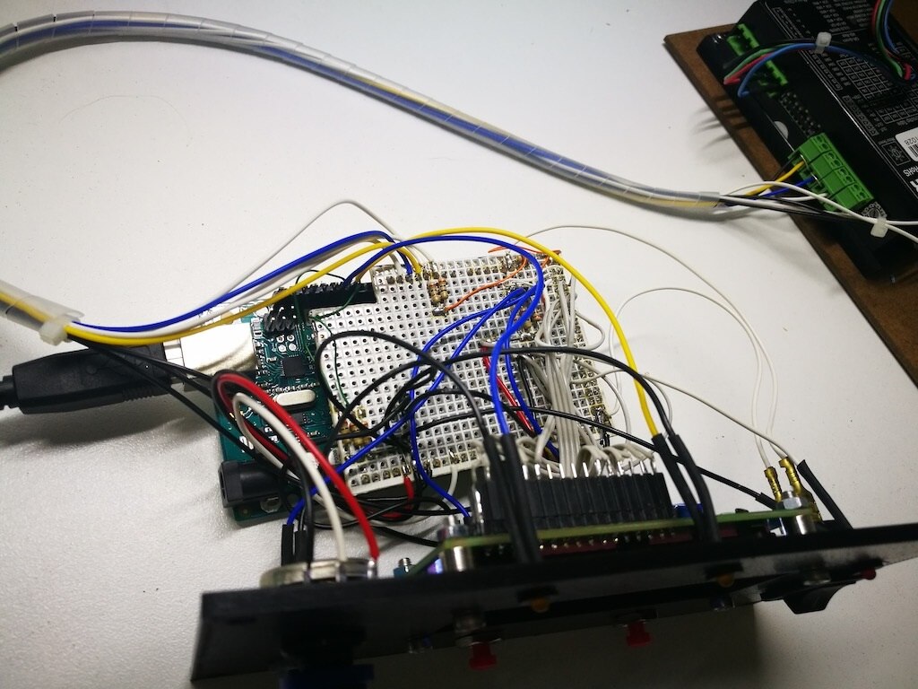

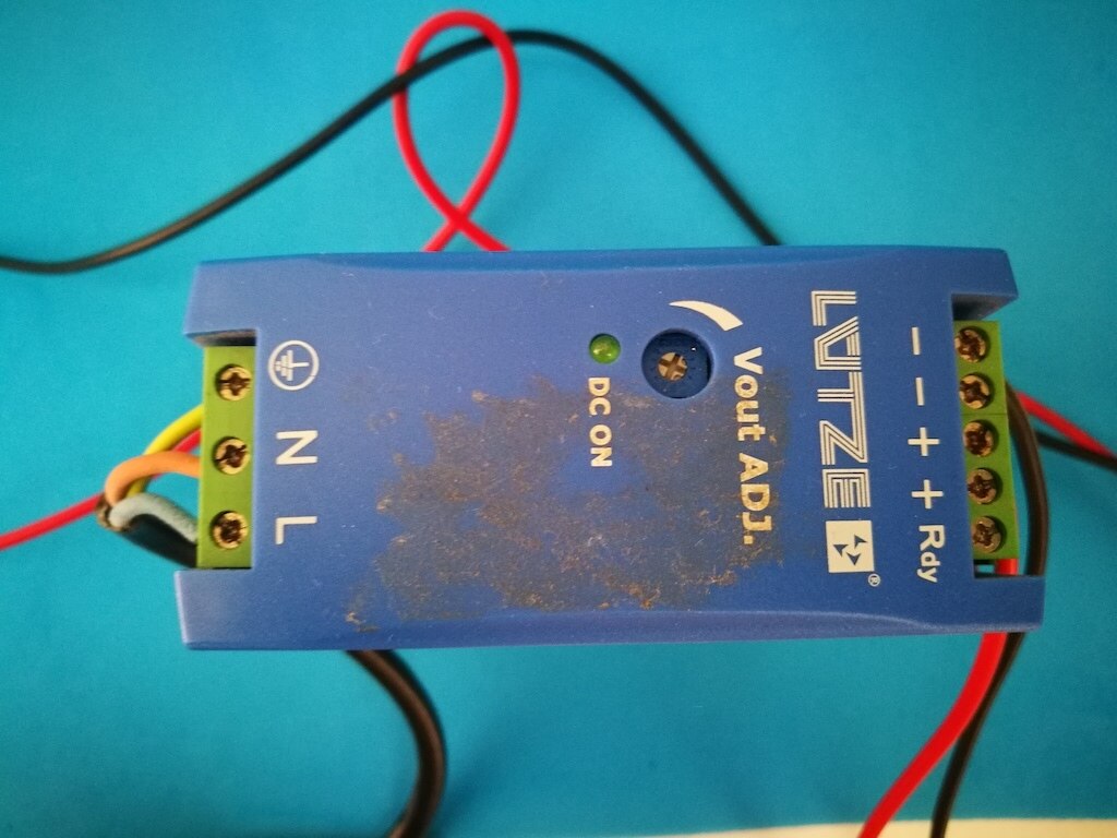

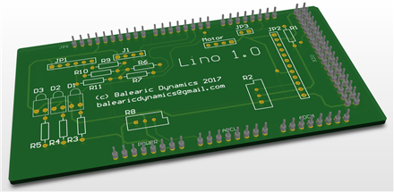

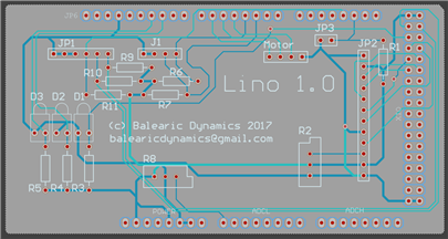

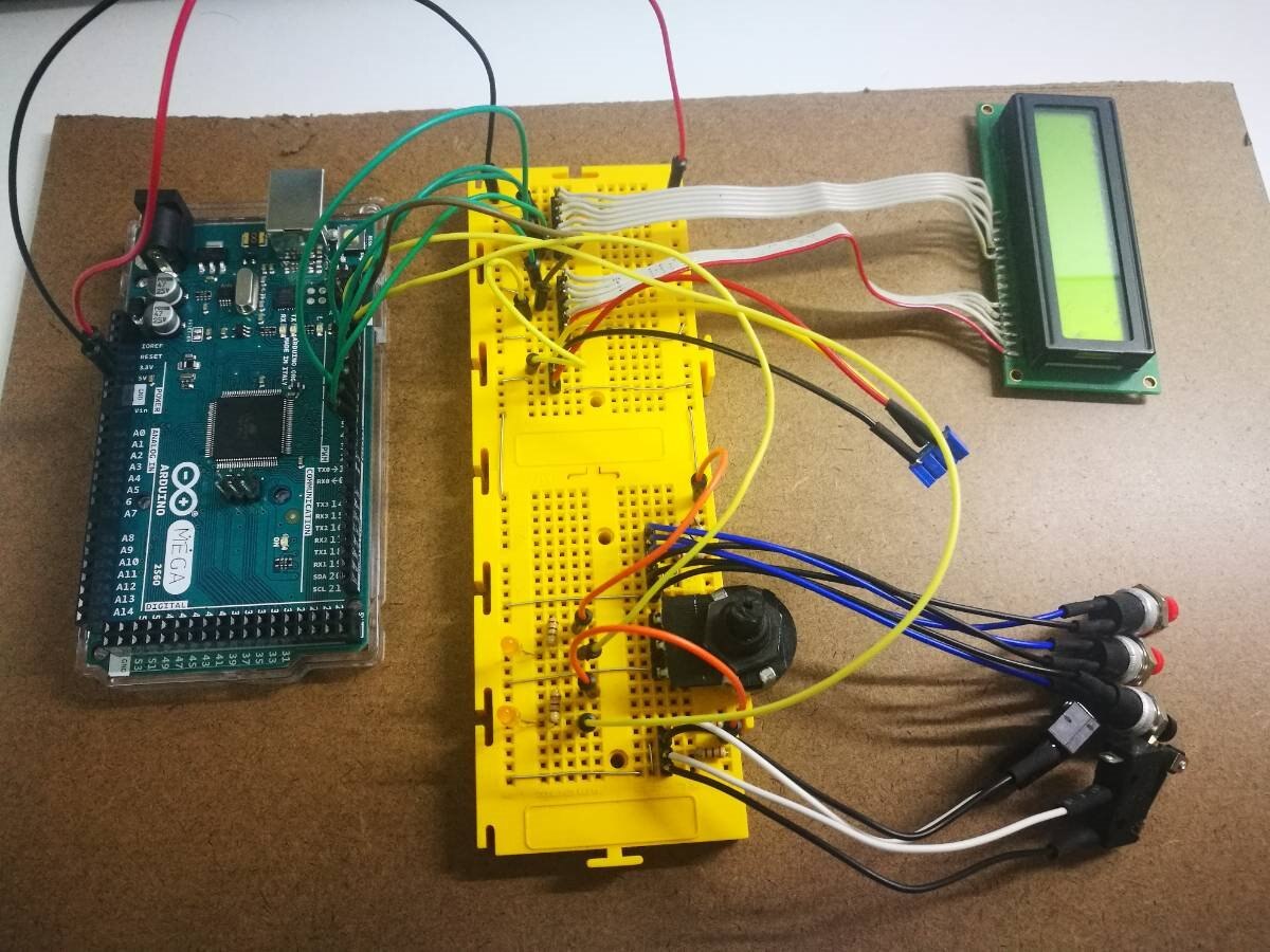

The circuit itself is not particularly complex but should work in not properly clean environments. For better stability, I have designed it as a Mega shield. The image below shows the schematics and the rendered PCB
The project has been developed with Altium CS

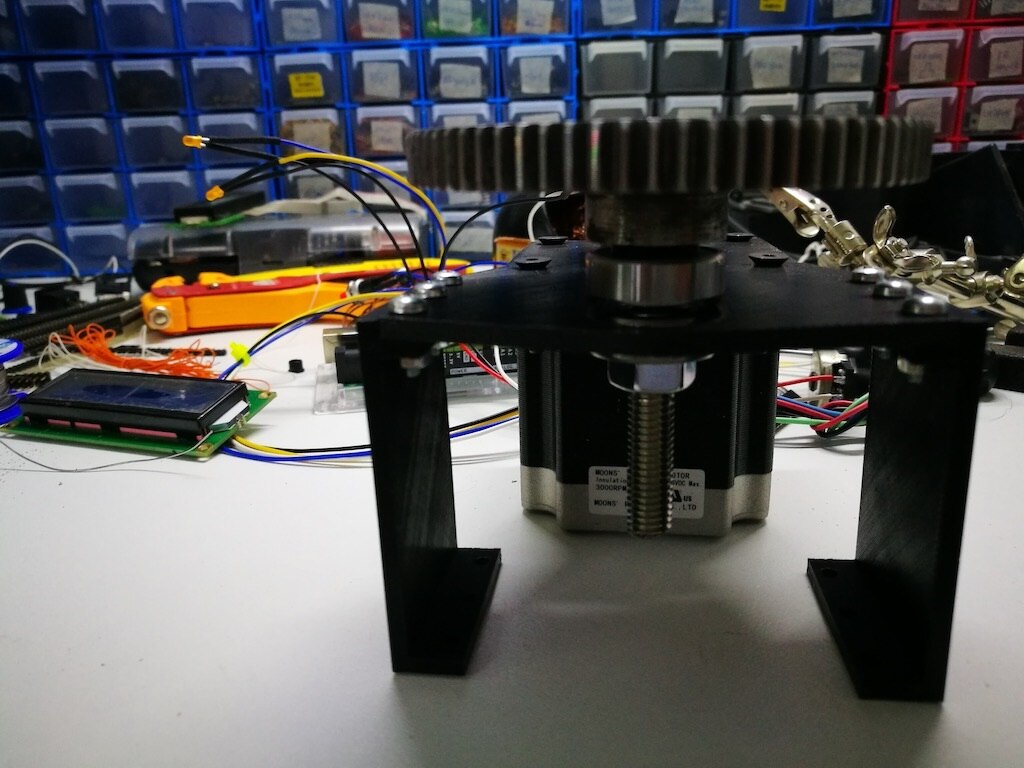

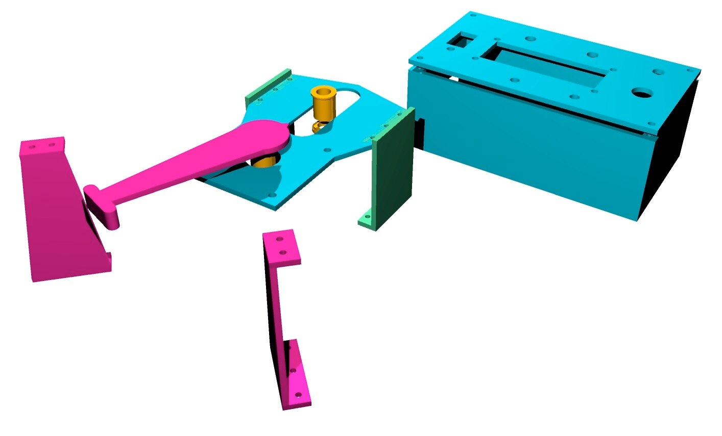

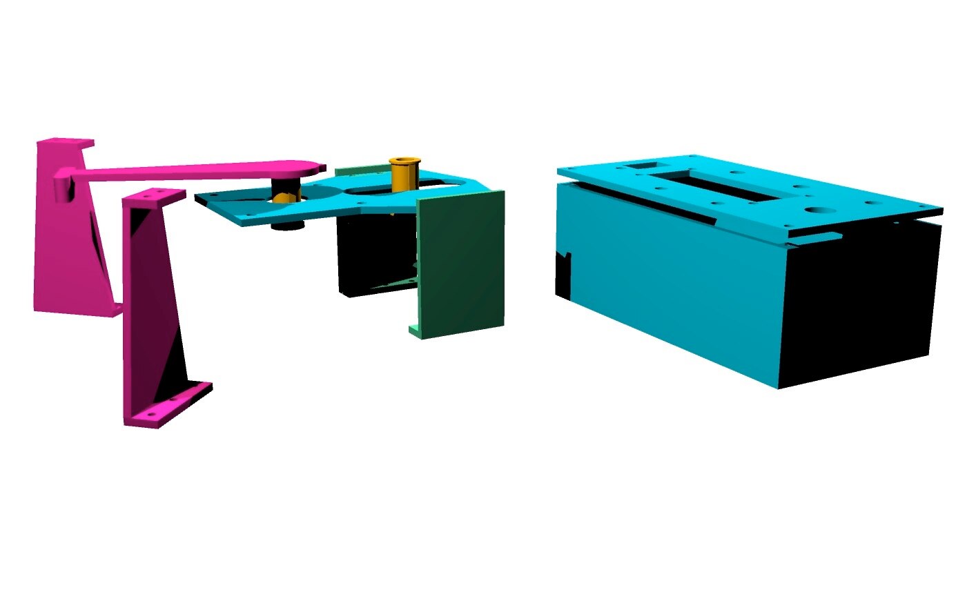

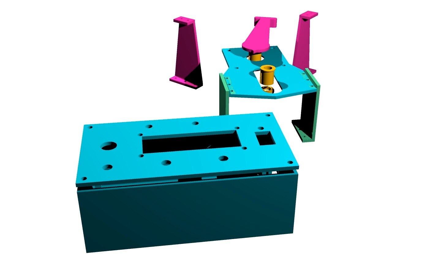

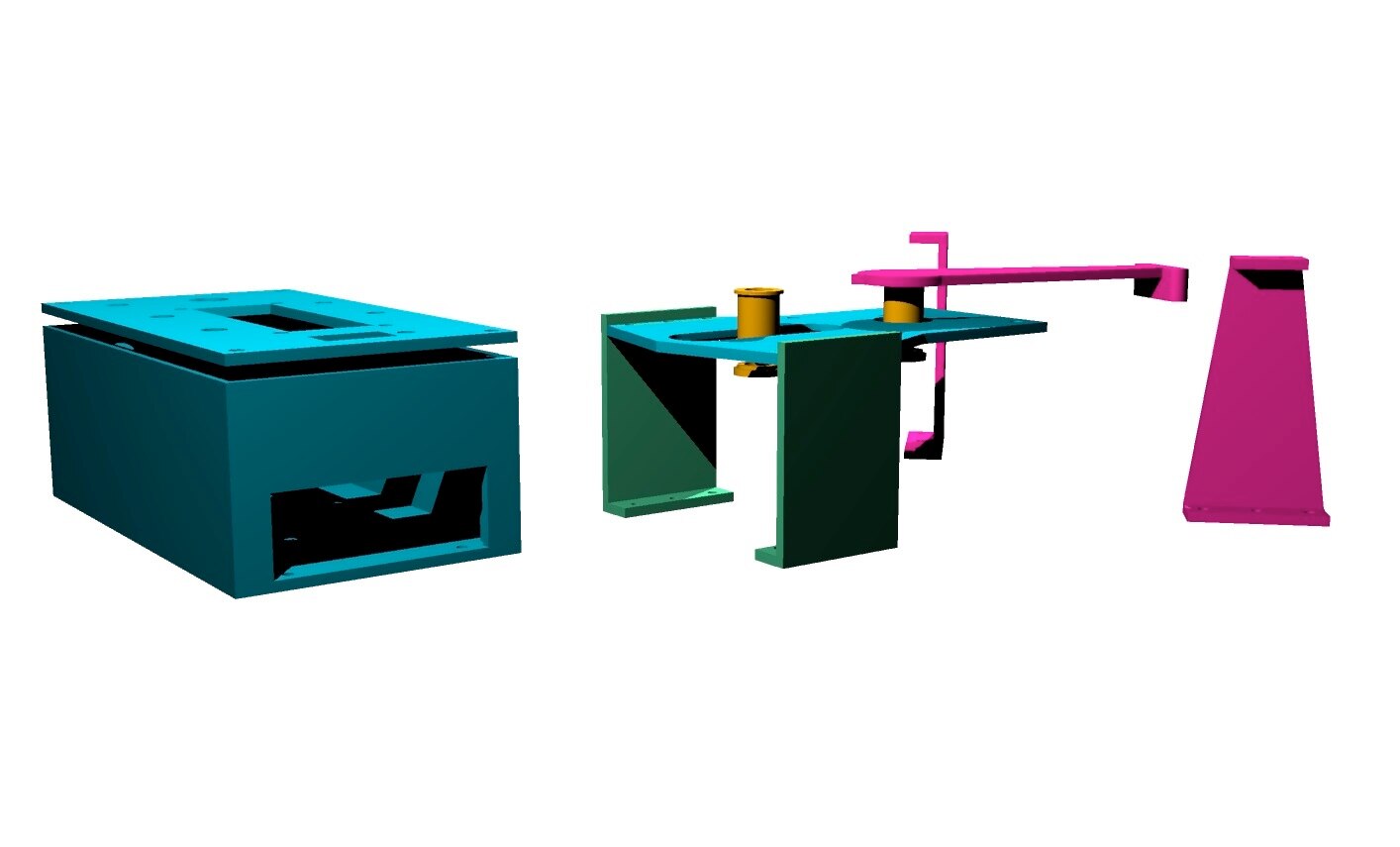

As the simulation build should not support particular mechanic stress I decided to make a simple design, focusing the attention on replicating the critical points involved in the real world application. The image gallery below shows the 3D rendering of the design parts
{gallery} Prototype 3D Design
3D rendered prototype components spacially assembled

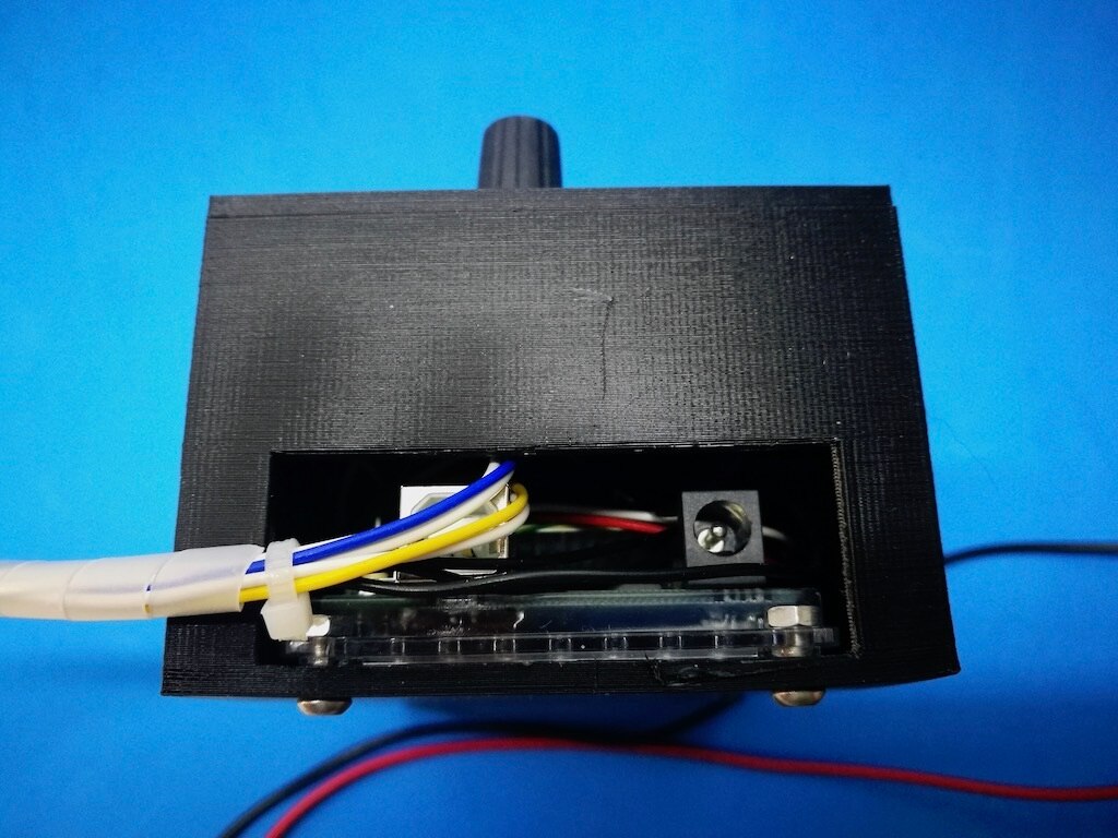

A simple box to host the Arduino Mega 2560 and the support for the motor with the rotating gauge to simulate the vertical rotating part of the real machine.

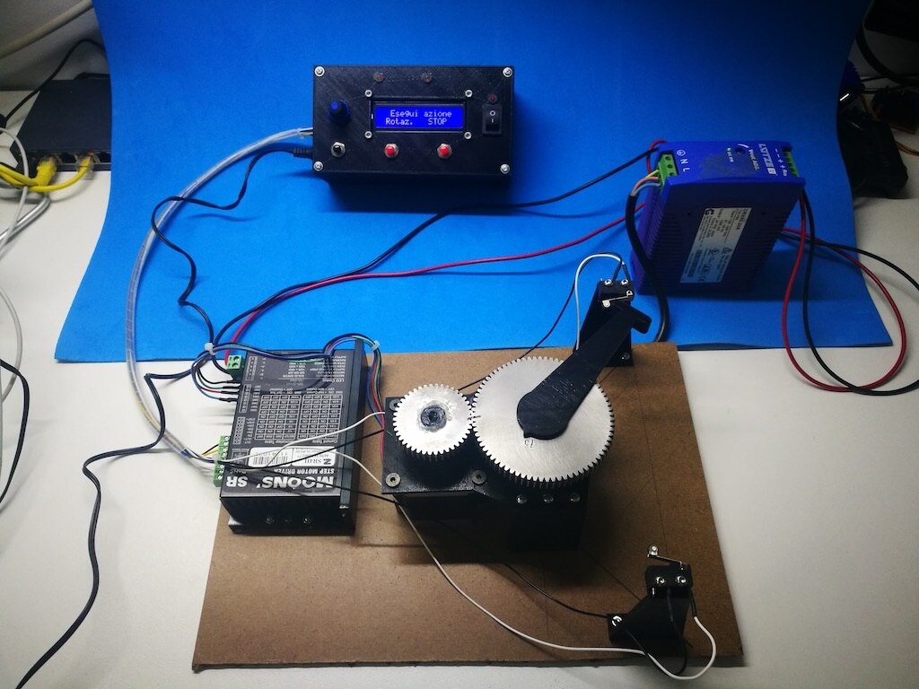

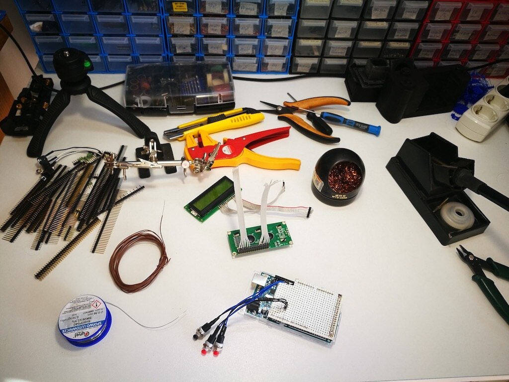

Assembling the prototype

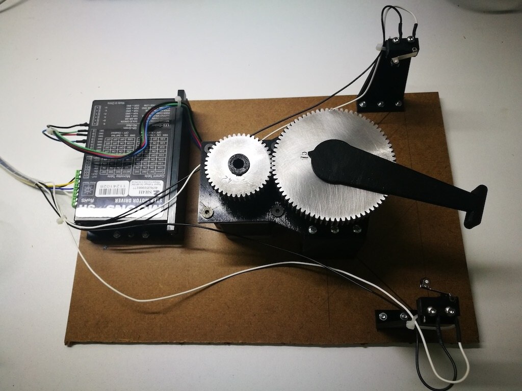

The slideshow below shows the final prototype assembled on an MDF base. Note that the rotating gauge attached to the motor axis can move between the two end-stop switches to control the motion inside the mechanically preset angle (typically it is 90 DEG)

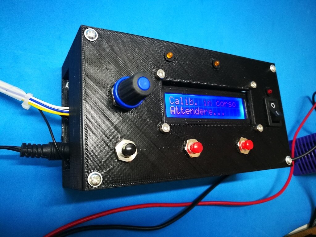

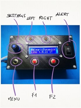

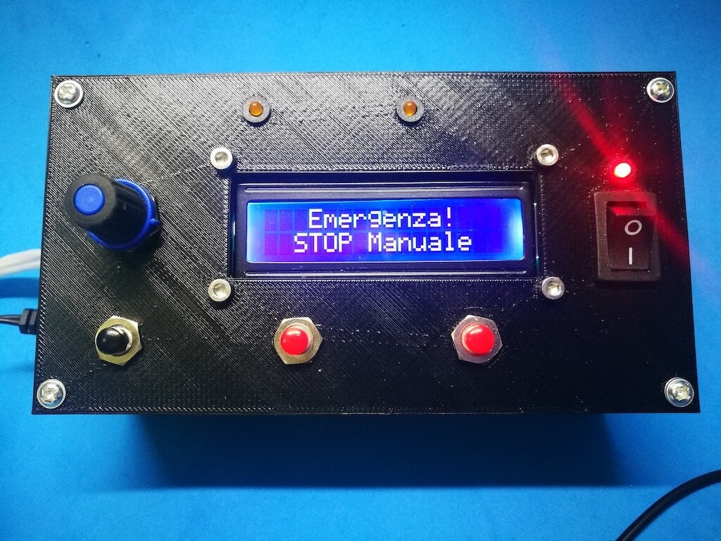

To make the UI easy to use also with a small-sized alphanumeric display I have created a two-buttons multilevel tree. After I have experienced the difficult managing some 3D printers interfaces, where the menu tree is controlled by an encoder I have opted for a multi-functional three buttons controller. To avoid irritating long button-press sequences, I have also added a potentiometer when the parameters of some functions should be changed between a wide range of numeric values. The scheme below (left) shows the menu tree while the right image shows how it has been created.
The Left - RIght LEDs monitor the end-stop switches status. The Alert section stop immediately the job and free the stepper motor.

The video below shows the prototype in action.

    Thank you. The prototype worked as expected, so now the game in on the other side. Lino is implementing the same inside a test machine then we will proceed. The idea is to automate and revamp the entire…
