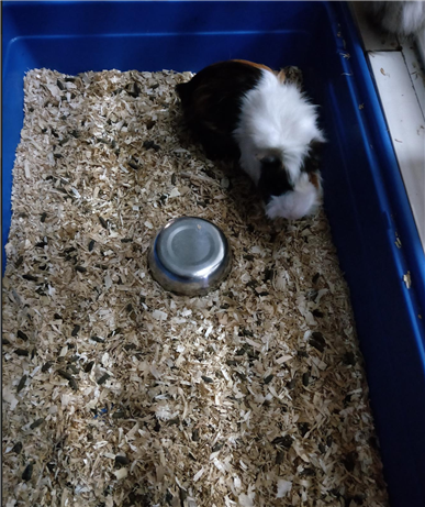

Poop Buster is a robotic poop cleaner for my children pet guinea pigs (there are 2 of them)
although they roam the garden during day time , they go back to cage with bedding at night
Problem
- guinea pigs poop needs to be manually clean by hand. We selectively pick the poop out and discard them at my garden plants and tree as fertilizer, leaving the bedding material intact
Note: guinea pigs are fully vegetarian and their poop actually is kinda not very smelly, not too hard to clean, can be used to fertilize my garden, but it still needs to be cleaned
well, we can in fact change the entire bedding and not manually picking up the poop but that will be kinda wasteful for the bedding material
eventually, the bedding material needs changing but by using poop buster to clean it we can prolong the lifespan of the bedding material and making it clean longer
end of lifespan of the guinea pig bedding (besides poop, there is also urine, so typically when it is too long duration, eventually we throw it at the garden as fertilizer)

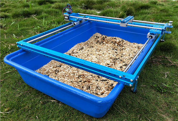

The solution is to use a X-Y plotter to selective pick up the poop (the mechanism, either it is a suction, a gripper or others, needs to manually built).
i put the plotter (with only one stepper motor attached) on the guinea pigs cage to illustrate the idea. Coincidentally, the size is very suitable
The role of the BeagleBone AI is to perform poop reconigtion with is powerful DSP and EVE cores (look in the reference section for its spec). with its dual cortex-M4 cores it should be able to also be used to control the stepper motor pair on my plotter and the 'poop gripper' mechanism

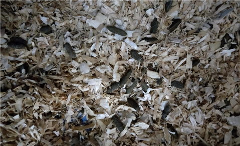

technically speaking the poop is extremely different from the bedding material so a classical image processing method may be sufficient for the task. However, AI method like machine learning or deep learning is general purpose image recognition method that we can train the device to seek and destroy the target. A bonus step that can be achieved with AI is that the engine can automatically derive the stage of health of the pets by looking at the composition of the poop (although i won't try to do this step for this contest)

    1) the target will be picked into a bin outside of the bedding. subsequently they are manually offloaded by human to some corner of my garden as fertilizer
    2) attaching a camera module or webcam to the beaglebone AI that is mounted on the x-y plotter i am hoping it is able to cover the region of interest (ROI) at least half of the bedding and take a snapshot. The image processing is capable of doing for the entire snapshot frame at a time

    Interesting project, but I think applying AI for such task is a bit of an overkill. Supposing you are going to use a camera to locate the droppings, the difference between the guinea pig droppings and the wood shavings is easily identifiable by just looking at the pixels' colour, so it will be far easier (and faster) just to implement your own algorithm rather than using AI. Looking forward to see how this project will evolve.
