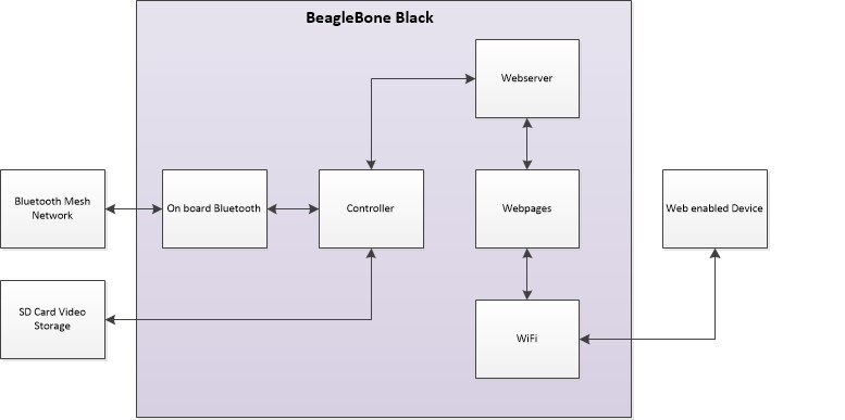

Figure 1 contains a diagram showing how I will implement the home security system. Bluetooth enabled sensors will report the status of a connected device back to the BeagleBone Black. I will create a webpage to interact will the homeowner. The BeagleBone Black will analyze the data received from the sensors. The BeagleBone Black will send the data to the webpage or act upon the information itself (i.e. sounding an alarm if a carbon monoxide leak is detected). Also, the BeagleBone Black will process the response sent back from the webpage. A response may include turning a light on/off, closing the garage door, turning off an appliance.

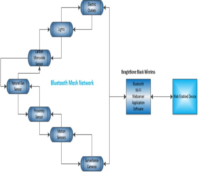

Figure 1 shows a high-level view of the home security system. All of the sensors are connected to each other via Bluetooth modules. A Bluetooth LE module will connect to any other Bluetooth LE module within its range. This forms the Bluetooth mesh network shown in Figure 1. Note: to keep Figure 1 from getting too messy I did not show all possible connections between the Bluetooth modules.
The BeagleBone Black Wireless box in Figure 2 shows the components contained within the BeagleBone Black. The BeagleBone Black will receive data via its Bluetooth module, analyze it, pass it to the web server. The web server will send the information to the homeowner’s device via a webpage, depicted by the Web Enabled Device box. The homeowner can view the information on the webpage and act upon it by sending a request (i.e. turn a light on/off) back to the BeagleBone Black. The request will be sent to the appropriate device via the Bluetooth mesh network.

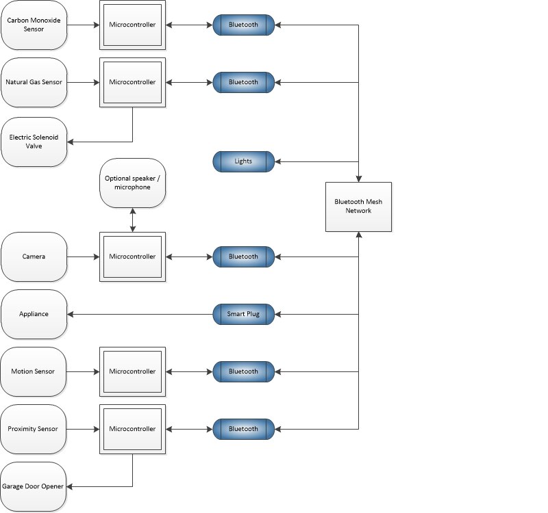

Building a Bluetooth mesh network requires a lot of hardware. Figure 3 depicts the hardware required to build out the Bluetooth mesh network. You need sensors to detect what is happening in the environment. Hardware is required to process sensor data and to manipulate the devices the sensors are monitoring. Bluetooth modules are required to send and receive data on the network. A computer is required to process sensor data and to provide web services. Listed below are hardware components for this project. Note that this is not a complete list. Other components may be added as the project progresses.
  • BeagleBone black (includes Bluetooth LE and Wi-Fi components)
  • Bluetooth LE modules to attach to sensors that do not have their own Bluetooth LE built-in
  • Small microprocessors to process and send sensor data over a Bluetooth module. This is for devices that are not Bluetooth enabled.
  • FTDI Basic Breakout board – for programming microprocessors
  • Battery holders/batteries for devices that cannot be connected to an outlet.

The BeagleBone black will host most of the software. See Figure 2. It will contain the web server used to serve up the web pages for the user interfaces to the system. The code for the web pages will reside on the BeagleBone Black. The controller program will also reside on the BeagleBone Black.
In some cases, a microcontroller is required to read the sensor data and determine what information to send back to the BeagleBone Black. The microcontroller will format the sensor data and pass it to the Bluetooth module, which will send the data to the BeagleBone Black via the Bluetooth mesh network. Example, microcontroller attached to the natural gas sensor will send a signal to the electric solenoid valve if it is necessary to turn off the stove. The microcontroller attached to the proximity sensor will open or close the garage door at the homeowner’s discretion.
