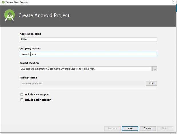

2. There have been two choice for android development, eclipse SDK or android studio. It would be easy for android studio for quick development and deployment.
2.1 The updated version is Android Studio 3.1.4. Start one new project,

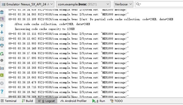

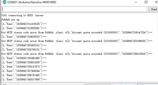

3. The run the arduino sketch in last blog,
Received by android application.
This test is passed.
