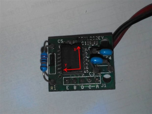

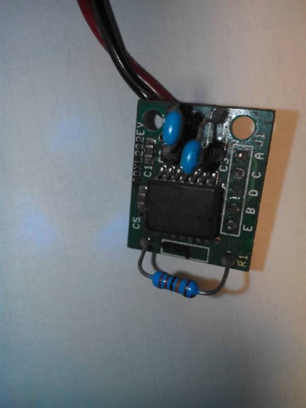

In order to detect when the MagicHat is picked up from the docking station, an accelerometer will be installed.
The accelerometer I will install is a quite old model, now out of production: the ADXL210. The reason for this choice is that it was the only available in my lab and I decided to use it even if it reminds me one the most disastrous project of my engineering life: a washing machine dynamic balancing device, which reveals to be a self-destroying device... I hope this project will be a bit more lucky than that one...

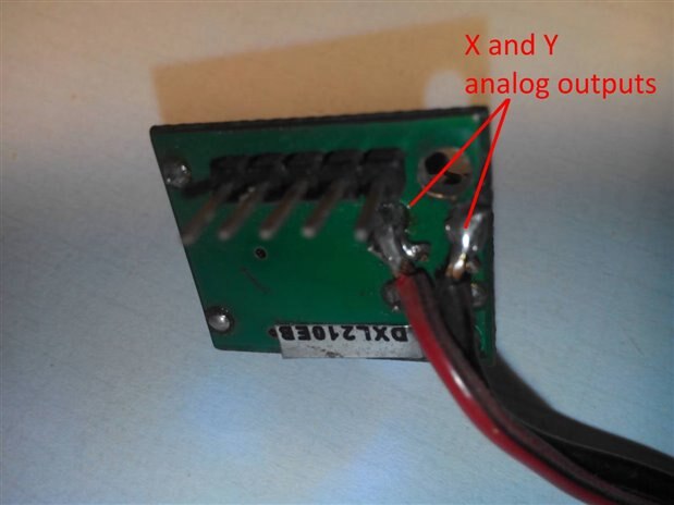

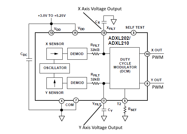

Back to technical topics, The ADXL210 is low cost complete 2-axis accelerometers with a measurement range of /±10 g. The ADXL210 can measure both dynamic acceleration (e.g., vibration) and static acceleration (e.g., gravity). The outputs are digital signals whose duty cycles (ratio of pulsewidth to period) are proportional to the acceleration in each of the 2 sensitive axes. These outputs may be measured directly with a microprocessor counter. However, in my case a voltage output is desired since I don't have other input capture timers available (I'm going to use the only input capture available on Arduino Yun for reading the temperature sensor). Fortunately, a voltage output proportional to acceleration is available from the XFILT and YFILT pins, or may be reconstructed by filtering the duty cycle outputs. I chose the first option, since with Arduino it's very easy to read an analog input
The board will be mounted so that the X axis measure is vertical
The output from accelerometer will read using the usual Arduino function analogRead and values will be averaged to filter out a bit of the analog noise.
The filtered values will be then analyzed to determine if the MagicHat is handles without any care for its...age!

    amgalbu over 11 years ago in reply to clem57
    The idea is to have to X axis vertical and the Y axis facing forward... I know it's not the optimal solution but I don't think accelerometer is an important component in this project
    cheers

    clem57 over 11 years ago
    So this is a 2 axis device. How will you mount?
