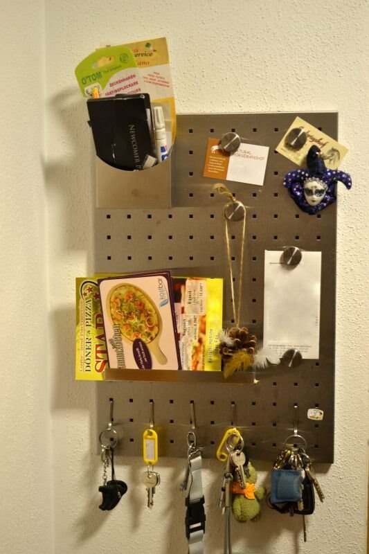

Our Key Hooks looks like this:
As you can see it is not only used to store the keys, but it also serves as a message board. Since every household member has an own keyring and would not leave home without it one can determine who's at home by looking at board. Hanging the key would be one of the first thing one does when back home. If you look closer you can see a few key rings with only one or two keys. That belong to special security profiles like "guest". Er, sorry for the security language - I am to used to it. What I meant to say was there are keys which we hand to our guest to allow them to leave and come back on their own. An other example is the key to the shed or the garage.
