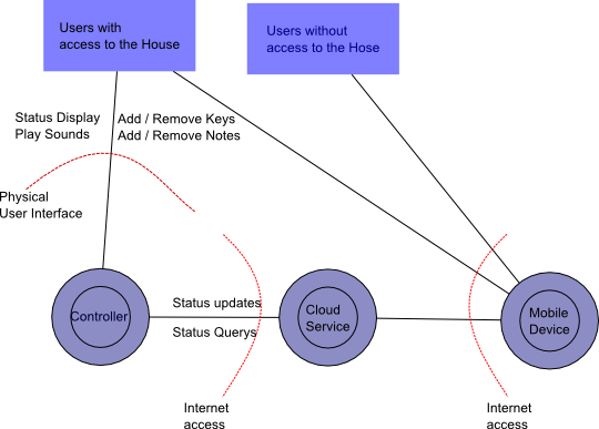

Data flows
The following chapter is a very simple implementation of the Application Threat Modelling from The Open Web Application Security Project (https://www.owasp.org/index.php/Application_Threat_Modeling).
Data is generated by the sensors connected to the controller and sent from the clients over the Internet. The Trust boundary is clearly the Internet connection of the controller.

Physical Security
Key hook is inside the house which is trusted for physical security. So no authentication is necessary for interface interaction. The controller board needs to be secured against unauthorized software install. Secure boot and tamper protection can be used for this. Documentation for both features is under NDA so they cant be used in this project. If I can find an other way I'll implement some tamper protection.
