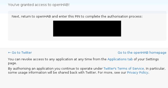

If you are not watching the messages, wait a minute and open the openhab.log file in the logs directory of the openHAB install directory. You should see the banner printed above in the log. Copy the link from your log and load it in a web browser. You will be taken to a twitter/openHAB authentication page where you need to login with your twitter credentials. Once you do that, you will see something like the following:
The blacked out portion will show an authentication number.
Step 3 - Set Authentication Pin
To set the pin, open a second terminal window, navigate to the openHAB install directory and type the following:
pi@raspberrypi ~/openHAB $ nano twitter.pin
This will open the nano text editor with a blank screen. Type:
auth=<your pin>
where <your pin> is the number from the website above. After you've done that, hit CTRL-X and say yes to the saving. Then just hit enter to confirm the file name (twitter.pin). If you've completed everything correctly and in the 5 minute window, twitter will authenticate:
21:46:31.492 INFO  o.o.a.t.i.TwitterActionService[:107]- TwitterAction has been successfully authenticated > awaiting your Tweets!

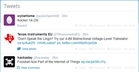

I wrote a simple rule to test this:
rule "Rocker Pressed"
when
    Item Rocker1A changed from OFF to ON
then
    sendTweet('Rocker 1A ON')
end
And, the result was:
