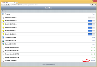

Hello, yesterday I try find how to support the HSM 100 sensor  on a STM 332U sensor in OpenHAB. As I find nothing I change the code of the java lib java-enocean-library use by OpenHAB and then modify the OpenHAB addons org.openhab.binding.enocean to use it.
I am start with this fixe https://github.com/thomasletsch/opencean/commit/de974a9c194ef7617307b170c92bdc81c64c492a and I made some changes and fixes.
My changes are available here https://github.com/pascalmartin/openhab/tree/1.5.1  and here https://github.com/pascalmartin/java-enocean-library
Bonjour, hier j'ai chercher comment faire pour avoir le support du capteur HSM 100 sur un capteur STM 332U dans OpenHAB. Comme j'ai rien trouver, j'ai modifier le code de la lib java-enocean-library utiliser par OpenHAB et ensuite modifier le addon org.openhab.binding.enocean pour l'utiliser.
Je suis partie de ce fixe https://github.com/thomasletsch/opencean/commit/de974a9c194ef7617307b170c92bdc81c64c492a et j'ai fait quelque fixe et modification.
Mes modifications sont disponible ici : https://github.com/pascalmartin/openhab/tree/1.5.1 et ici https://github.com/pascalmartin/java-enocean-library
How To
1- Replace your openhab/addons/org.openhab.binding.enocean-1.5.0.jar with new  org.openhab.binding.enocean-1.5.1.jar
2- In your items config use eep=A5:04:01 and parameter=HUMIDITY
OpenHAB demo.items config
// EnOcean Temperature sensor with humidity
Number EnOcean_temperature_0180EE74 "Temperature 0180EE74 [%.1f °C]" <temperature> (enocean) {enocean="{id=01:80:EE:74, eep=A5:04:01, parameter=TEMPERATURE}"}
Number EnOcean_humidity_0180EE74 "Humidity 0180EE74 [%.1f %%]" <temperature> (enocean) {enocean="{id=01:80:EE:74, eep=A5:04:01, parameter=HUMIDITY}"}

    When I try to use the attached binding JAR with OpenHAB 1.5.1, the EnOcean binding completely stops working. When I change back to the normal 1.5.1 binding JAR, everything is fine.
    Should I rebuild the binding from the 1.5.1 sources? How do I then supply the changed EnCOean-Java -Binding JAR file?

    I have tried without humidity sensor it shows 0%, and its fine... But at same time my temperature readings are came down from 31.3 C to 7.1 C. Do i need to re-program Temperature sensor too to work with this binding..? earlier using 1.5.0 binding I am using eep=A5:02:05 now I am using updated eep=A4:04:01 for both temperature and humidity with 1.5.1 binding.. am I making any mistake?
    I think I need to wait for EOP programmer...
