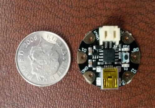

The first thing that strikes you when you see the Gemma in the flesh is how small it is. It is only slightly bigger than a 10p piece! The second thing that hits you is how quickly you want to set it up and getting going! image
