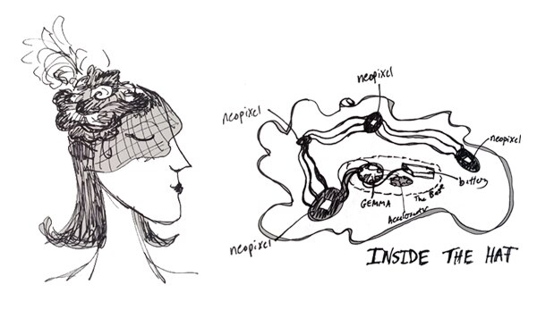

My entry in the Hats Off Challenge is the "Fleet Fascinator," an eye-catching hat that uses an accelerometer to measure the wearer's movement. This data is then used to change the intensity and color-temperature of the NeoPixels. Basically, the more you move, the brighter the LEDs and the more they change from blue to green, yellow, orange, and red. It's gonna look cool, guys. Trust me.

    You'll need a good 3v3 or 5v source while you do the developing, as each pixel can draw 18x3mA = 54mA if all ON.
    Even a 12 ring like mine with single colour drew 216mA.= at full brightness.
