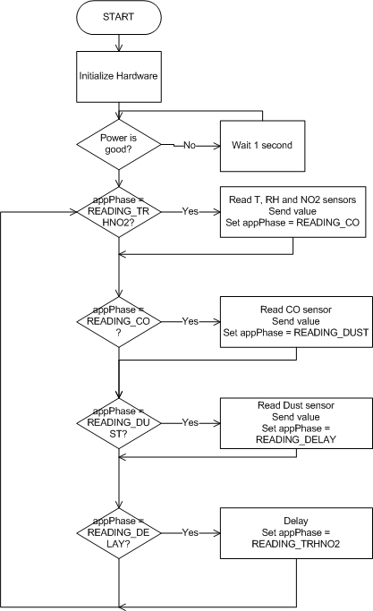

The basic flowchart of the AirMobile firmware is very simple
So I decided to save the application status and the last readings of the 5 sensors
#pragma PERSISTENT(gAppPhase);
int gAppPhase = PHASE_READING_TEMP_RH_NO2;
typedef struct
      float temperature;
      float humidity;
      float CO;
      float NO2;
      float dust;
} SENSORS_DATA;
#pragma PERSISTENT(SENSORS_Data);
SENSORS_DATA SENSORS_Data;
The application status is saved for obvious reason.
The last readings are saved in order to make a mobile average over the samples
