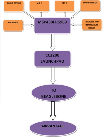

The overall design for sensor is :
    e14 Contributor over 12 years ago in reply to DAB +1
    hi I was thinking to have the bone as a control hub which takes sensor values wirelessly from different sensors and take actions along with uploading the data to airvantage. May be I will also be leaving…
    DAB over 12 years ago in reply to e14 Contributor
    I was just curious.
    It was not clear from your diagram that you were separating the UI from data collection.
    Look forward to seeing how you set up the information transfer and display.
    e14 Contributor over 12 years ago in reply to xever
    Hi
    I was considering to use the supercap on the msp430 so that the msp430 do not need to be connected to power all the time and takes readings at specific time intervals and goes to power saving mode so that it can continue on the supercap. Then I used the CC3200 so as to send the readings of those specified instants to a central hub wirelessly thats the beaglebone. I am trying to use all the major features of the launchpads through this. All this can be done by the CC3200 alone but i am trying to use all the launchpads in the design. As the competetion progresses i will simplify to include only those necessary.
  • xever
    xever over 12 years ago in reply to DAB
    I have almost the same design, the CC3200 will send sensor data to the BBB before posting it to AirVantage. However, my question about the design would be, why did you choose to use the MSP430 for sensor sampling?  The CC3200 has analog inputs (although just limited to 4 channels), GPIOs, I2C and other peripherals which you can use for sensor sampling.
    hi
    I was thinking to have the bone as a control hub which takes sensor values wirelessly from different sensors and take actions along with uploading the data to airvantage. May be I will also be leaving one of them as the competetion progresses. Thanks for the opinion thoughimage.
    I am curious why you have the CC3200 and a Beagle Bone?
    I would think one or the other could do the job.
