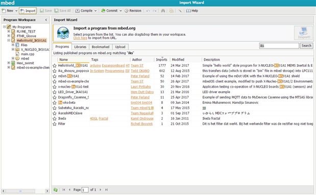

2. First, create empty project from template, or you can directly import one demo HelloWorld project by ST teams,but not for IKS01A2, only for IKS01A1. But you can still use it, if right I2C slave address are set.

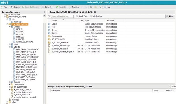

3.  After imported, the file structure is,
it is obvious what parts are used in this board. To use this template, scheme comparing is necessary. It would take extra effort. If not familiar with the difference, it is more safe to create new one.

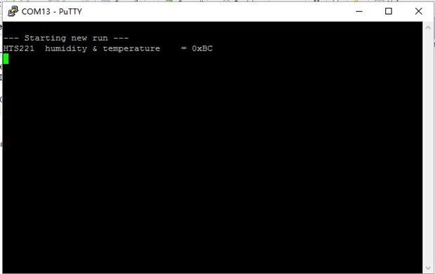

6. Then find your com-port for nucleo,
Use tools like putty to open serial port in 9600 baud rate, you will see.
It works. This is done by remark some unresolved lines. The sensors can easily be read via mbed demo codes.
