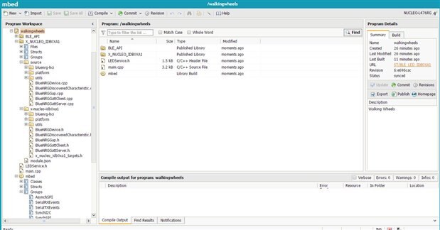

1. Create new project, using BLUENRG template.
2. Codes and sending commands

3. Test BLE
Impletion of BLE in mbed is in two steps. First, abstract of hardware via SPI. Second, porting the STM32L476 SPI data to BLE API of mbed. There is no hardware I/O defination for SPI pins in the program, since the mbeb has done all the job with ST team and the process is transparant to users. In other words, developer can not make any modifiation or redefine the pins. For developers, only BLE API matters.
With BLE instance and init, the BLE is started and function of onDataWrittenCallback() will lead the way of flashing the LED according to the Data received. No more experience with bluetooth protocols.
    BLE &ble = BLE::Instance();
    ble.init(bleInitComplete);
4. Summary
I have tested and can flash the LED from any mobile application with BLE like lightblue.
