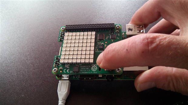

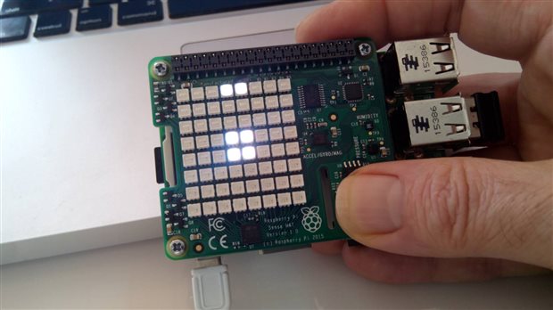

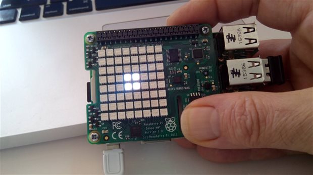

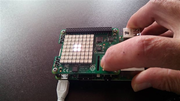

The joystick
The user will be noticed of the presence of the joystick accessible from the interface module. This will be used to get instant spot information e.g. the environmental state, reset a conditions and more.

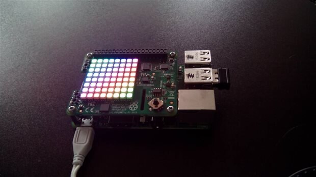

Class: HatRainbow
Usage
from iot_sense_hat.hat_rainbow import HatRainbow
Description
SenseHAT general purpose rainbow generator.
Note: this class will be updated with several different kind of color sequences specific for the IoT interface management
Methods
rainbow()
Generate the rainbow screen calculating the next pixel colour for every pixel

The example program
main_hat.py is the main SenseHAT management for the PiIoT project. This version 1.0beta launch a series of initial actions then start polling the joystick and react showing the joystick position on the display and print on the console the return code and the status.

joystickDispatcher(...) is the function passed to the Joystick class when it is instantiated. Every time a joystick event occur after the Joystick secondary thread has been launched calling the start() method this function is called. This avoid to setup a complex multithread mechanism in the main application.

   # Start the rainbow loop in the main thread
   print("Rainbow will run in the main thread")
  rainbow = HatRainbow()
  counter = 5000
   while counter is not 0:
  rainbow.rainbow()
  counter -= 1
   hatScreen.clear()
