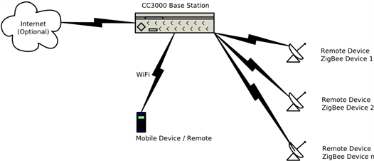

This system is designed to make watching your favourite film, TV or game easier by reducing the number of things you have to do to get the environment just right. For many, the habit is to turn off the lights, close the blinds and watch the film in the dark. Lets face it, if you are going to put on a film you are looking to be lazy, so why not automate what you can?
The challenge is to do this using the Texas Instruments CC3000 WiFi evaluation kit. This project makes a few assumptions, if you are the kind of person to have a home automation system, you most likely have a smart phone, a tablet, a laptop or other wireless device (If anyone has data on how this applies to those using home automation due to a health issue, please share!) This makes the design a little easier, use the wireless device as the remote control. Something of a Bring Your Own Device approach to the problem. Why create a whole new device when you can use standard hardware and simply drop in an app? The use of WiFi (Implemented as a client rather than an access point), would also allow the user to control the system from outside the network through the internet. Stuck late at work or in traffic? Close the blinds and turn on the lights on the go through mobile internet. With this design, the system is broken down into a device per room with one base station acting as a controller. The diagram below shows how it is configured.
This system is made up of several main components, the WiFi network, the ZigBee network and the drivers. The Wifi portion connects the main user interface to the system. This means any Wireless enabled computer is able to send the relevant instructions to the system to say what mode the relevant room needs to be in. Once these instructions are with the base station, one of two things can happen. The first is that the instructions are followed. This is because the base device controls a room just like any of the end devices. If the instruction is not for the base station it is forwarded onto the right end device using the second main component, the ZigBee network.
The ZigBee protocol was chosen for a few reasons, one being previous experience with XBee modules, second being the availability of processors which natively support the protocol and lastly, the protocol is designed for this. ZigBee has several published profiles for applications and several draft profiles. Out of these profiles, there are two which fit this use, the published Home Automation profile and the draft Building Automation profile. When you look into the specifications for these, the Home Automation profile covers exactly what is being done here as it provides lighting and closure controls (Window coverings, shades etc). Couldn’t get more suitable if you tried! To make it even better, the available software stacks for TI ZigBee products are compliant, as tested by a ZigBee Alliance test house. Z-Stack samples also support the Home Automation profile. It is like a match made in heaven!
With the instruction at the right end device, you need to have an output, to do this we need two components, a lighting driver and a motion controller. With the move towards green technology, there are very few options for lights, the biggest one being LEDs. As it happens, TI provide some lovely LED drivers, including one controllable by a PWM signal. The result is a dimmable light that can be controlled by a tiny processor. Sticking with the PWM theme, this kind of signal can also be used to drive the motor of choice. With the available range of motor drivers, there are multiple options for motors, be it a DC motor, a stepper motor or a servo. For this system, a stepper motor was chosen, allowing suitable levels of precision and the use of a step counter rather than a timer. With this in mind, the solutions chosen were the DRV8805 for the motion control and the TPS61042 for lighting control.
