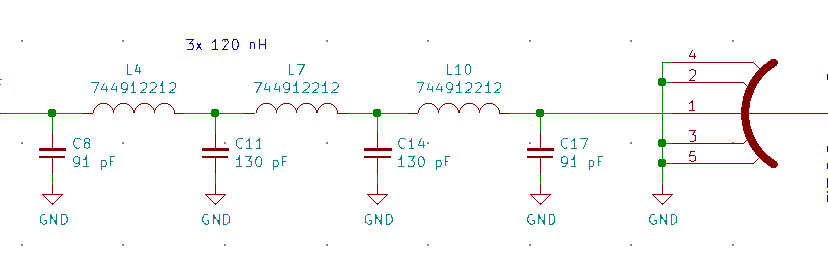

I decided to go with a seventh order chebyshev filter. There exist online calculators for this filter:
https://leleivre.com/rf_chebyshev_LPF.html
http://www.calculatoredge.com/electronics/ch%20pi%20low%20pass.htm
My parameters are:
cutoff frequency: 75 MHz
passband ripple: 1.0 dB
impedance: 50 Ohm
I chose the capacitors and inductors which are closest to the ones calculated.

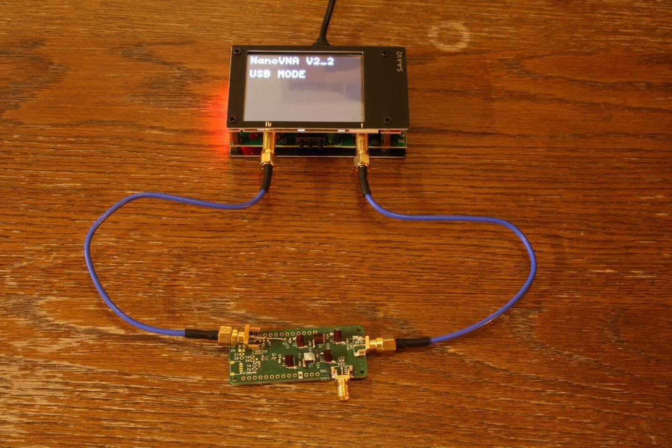

To verify the filter design I tried to measure it.
You need a network analyzer to test the filter. These devices are usually very expensive. But with the NanoVNA (https://nanorfe.com/nanovna-v2.html ) exists a cheap amateur device. I control the NanoVNA with a notebook running Ubuntu and the software NanoVNA-Saver: https://github.com/NanoVNA-Saver/nanovna-saver
The following plot was also made with this software.

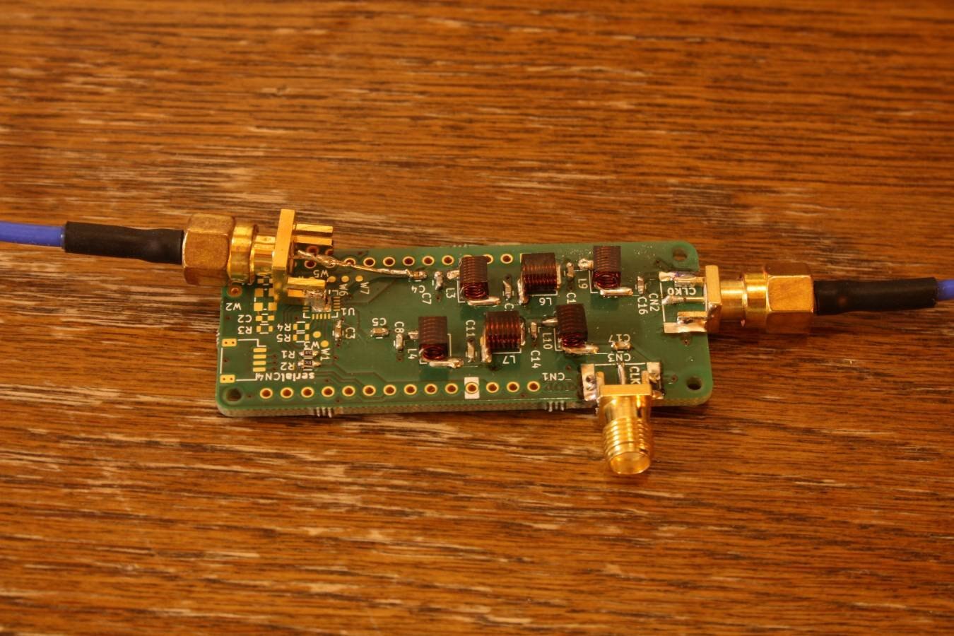

I reworked my PCB and placed a SMA connector instead of the Si5351.
The NanoVNA will generate a signal with port 0 and measure it on port 1. The filter is connected to the NanoVNA like shown in the following picture.

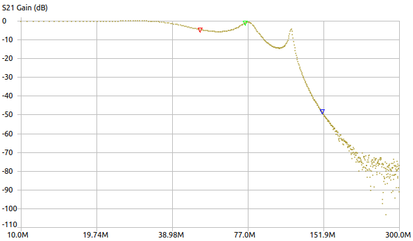

The following plot shows the attenuation of the filter.
The first marker (red) is at 50 MHz, the second (green) at 75 MHz and the third (blue) at 150 MHz.
The plot shows that the filter somehow works as expected. There is a lot of ripple around the cutoff frequency which is typical for chebyshev filters. Unfortunately the fundamental signal at 50 MHz has also an attenuation of around -4 dB. The third harmonic at 150 MHz has an attenuation of around -50 dB which is a little bit more than expected.

The filter for the 50 MHz band works like expected and the transmission should be within regulatory limits. But there is also room for improvement: The signal at 50 MHz could have less attenuation and the third harmonic at 150 MHz a little bit more as it is close to the limits.
