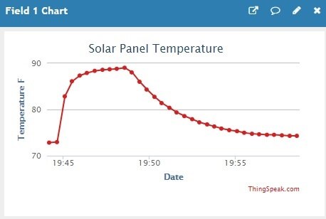

I've updated the 8266 program to change the temperature sensor from the DHT22 to the 18B20.  It was a straightforward change using the OneWire and DallasTemperature libraries.  Initially nothing was working, but then I realized that I had forgotten to add the pullup resistor on the Data line (not required on the DHT22).  Added a 4.7K resistor to 3.3V and everything started working.
Here is my test plot from ThingSpeak.  I held the temperature probe between my fingers and then released it.  It seems the thermal mass of the probe housing gives it a bit of a time constant in the response.
I also updated the program to correct the offset in the irradiance equation.  I won't update the sample time until I finish testing.  The program is pretty simple because I have not included the temperature compensation or any power management.  That's the next phase of the project.

    Thermal mass is a problem with a lot of the temperature sensors (more so when the mass of plastic around the sensor is so great).  You can improve the response by circulating air across the sensor, but in reality, the temperature changes in a more natural setting will be far more gradual so that this should not be seen as a problem,
    Good luck on your next steps!
