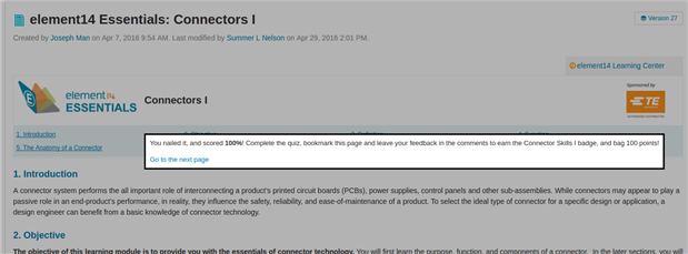

    After watching Ben Heck's video on connectors, this was rather easy! image

    phoenixcomm over 10 years ago
    Too easy!image
