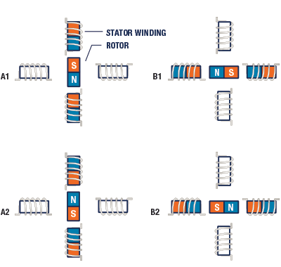

Figure 16
Figure 16: Stepper motor rotor direction
The stepper motor control allows the flow of current through the stator windings. As the current starts flowing through the selected winding, an electromagnet pair is created and attracts the rotor’s permanent magnet and aligns with it. This results in rotation of the permanent magnet. When the windings are excited in the sequence A1-B1-A2-B2 the rotor will be driven in a clockwise direction. If we reverse the sequence A1-B2-A2-B1, the rotor will be driven in a counterclockwise direction.
A Stepper motor driver is needed to drive the stator current. The main function of the driver circuit is to change the current and flux direction in the phase windings by driving a controllable amount of current through the windings. The direction change is done by changing the current direction, and this may be done in two different ways:
  • Unipolar Drive: A stator winding has three leads each at the end and one in the middle. Only half of the winding is used in motor operation at any instant of time. To change the direction of rotation, end leads are switched and the current flows in the chosen direction.
  • Bipolar Drive: In a bipolar drive, winding current flows in both directions. To change stator coil polarity, all four switches are needed in the form of an H-bridge. The bipolar drive method requires one winding per phase. The motor winding is fully energized by turning on one set of the switching transistors.

Full-Step
The unipolar full step excitation mode is achieved by energizing both windings while reversing the current alternately. Essentially one digital input from the driver is equivalent to one step. Full step sequence is shown in Table 2.
Steps A1 B1 A2 B2
1 ON OFF OFF ON
2 ON ON OFF OFF
3 OFF ON ON OFF
4 OFF OFF ON ON
Table 2: Unipolar Stepper motor Full step sequence
The bipolar stepper motor driver turns on the switches one after another in the switching sequence, shown in Table 3.
Steps A1 B1 A2 B2
1 ON OFF OFF OFF
2 OFF ON OFF OFF
3 OFF OFF ON OFF
4 OFF OFF OFF ON
Table 3: Bipolar Stepper motor step sequence
