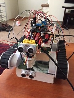

In the past, I made a multi-function robot which I named the "Blambo bot" which relied on
nRF24L01 2.4GHz Radio/Wireless Transceivers
to send data be control remotely
Here is a picture of the Blambo Bot...what a fat cat it is!
The wireless transmitter/receiver pair would work by one being connected to an Arduino and the other to an Arduino functioning separately as a motor controller. In the end, the same serial data received by one Arduino is received by the other through the nRF24L01 communication.
The Blambo bot could switch between these functions which I achieved during other robotics projects in the past; going through these will help emphasize why the robot I have created now is the "Delux" version:

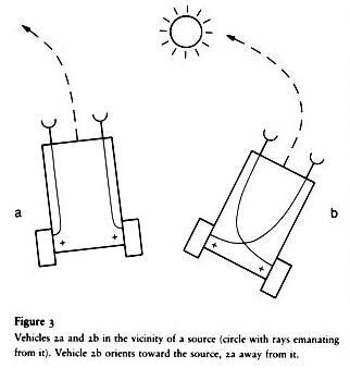

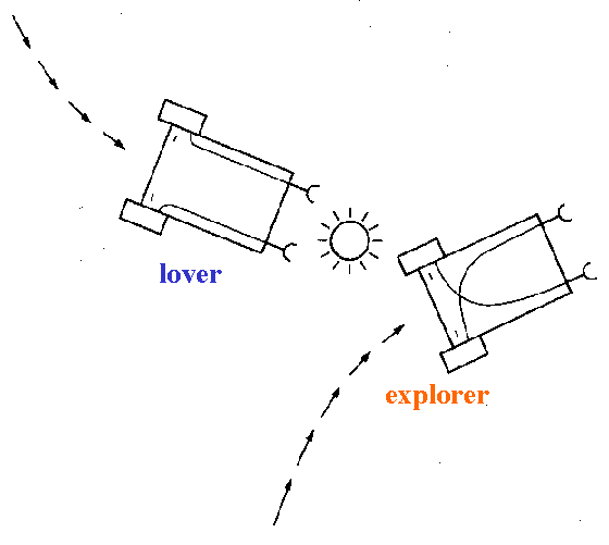

Originally, I thought that I'd attempt to program light seeking behavior in Simulink as the process was clearly outlined in the example code provided by the Parallax online documentation. .However, things as simple as adding a delay() function were exceedingly difficult for me to figure out in Simulink. I had hoped that if I could program light seeking in Simulink and have it communicate remotely with my robot then I could do some exploratory demonstrations on the subject of Braitenberg Vehicles in class. The pictures below will give you a general sense of what Braitenberg vehicles are, but basically it's about characterizing the personality of artificial intelligence through the example of very basic autonomous machines:

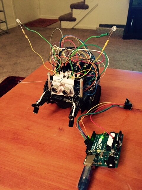

The end goal for my Teacher's Pet road test was to combine all these functions into one robot:
-obstacle avoidance, in my "pensive avoidance style" (using ultrasound, not infra-red)
-edge detection
-light seeking
-bump sensor "Whiskers"

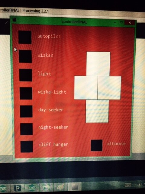

All into one robot which could be controlled remotely by arrow keys in a visual representation "control console" made in Processing. This control interface would also have buttons for activating each of these individual, autonomous, functions listed above; as well as combinations of them to see how the robot's behavior changes within a specific environment. A picture of the  control console I programmed (to be explained in a later blog post) can be seen below:
