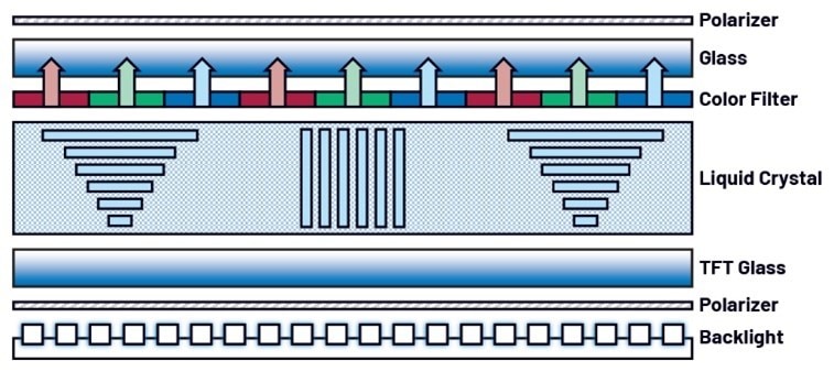

TFT LCDs utilize liquid crystals sandwiched between two glass substrates. The bottom substrate is embedded with TFTs, while the upper substrate serves as a color filter. These liquid crystals align to modulate the rotation of light passing through them by controlling the current flow through the transistors, which causes changes in the electric field. Each pixel with a different color is generated by illuminating the color filter in varying proportions.
Figure 2. TFT LCD display structure.

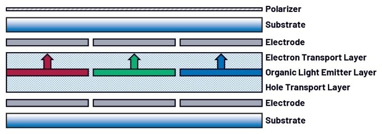

In contrast, OLED displays do not require a backlight due to their self-emissive capability. The basic structure of OLEDs consists of an organic light-emitting layer on indium tin oxide (ITO) glass. This organic light-emitting layer is sandwiched between two low work function metal electrodes: the upper cathode and the bottom anode.
When an external voltage is applied to the cathode and anode, the electron transport layer (ETL) and hole transport layer (HTL) inject electrons and holes into the organic light-emitting layer with controlled volume and speed. This process causes the OLEDs to emit light. Red, green, and blue light can be produced by using different chemical materials in the OLEDs. Consequently, OLED displays are thinner, more energy efficient, and offer superior color reproduction and contrast.
Figure 3. OLED display structure.

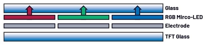

Micro-LED displays are a recent advancement that use arrays of microscopic LEDs as individual pixels. Typically, the chip size of micro-LEDs is within 50 µm, making them hardly visible to the human eye. Due to their tiny size and advanced assembly technology, the illumination sources for red, green, and blue light can be integrated into a single pixel point, eliminating the need for color filters and liquid crystals in micro-LED displays.
Each micro-LED in the pixel emits its own light, offering high brightness, deep blacks, and excellent energy efficiency. These technologies represent significant strides in display innovation, each offering unique advantages in terms of structure and performance. Micro-LED displays are suitable for applications ranging from smartphones and televisions to augmented reality, wearables, and automotive displays.
Figure 4. Micro-LED display structure.

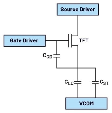

In a TFT LCD display, the equivalent circuit of a sub-pixel, which controls the electric field across the liquid crystal, is shown in Figure 6. It comprises 1T2C (one transistor, one liquid crystal capacitor, and one storage capacitor). The gate driver provides a positive voltage, called voltage gate high (VGH), to turn on the TFT, and a negative voltage, called voltage gate low (VGL), to turn off the TFT. The picture information is transmitted to the source driver, which charges the liquid crystal capacitor (CLC). The storage capacitor (CST) acts as a buffer to prevent leakage current from the CLC. More pixel drivers in TFT LCD displays are discussed in the article “New Driving Structure to Increase Pixel Charging Ratio for UHD TFT-LCDs With High Frame Rate” (Reference 4).
Image retention or flicker in TFT LCDs is caused by parasitic capacitance (CGD) existing between the gate node and drain node of the TFT. When the picture content changes and the TFT turns off from the on state, a voltage drop on the CLC is caused by a capacitive voltage divider between CGD and CLC||CST. To improve panel performance consistency, the common backplane voltage (VCOM) is introduced and tuned to the center of the pixel voltage during the pixel transition time.
Figure 6. A conventional pixel driver.

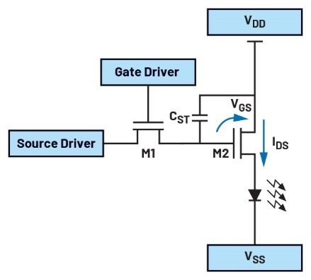

The topology of popular pixel drivers in micro-LED and OLED displays is similar but more complex than in TFT LCD displays due to the fabrication process and integration of TFT circuits with LEDs on a glass or polyimide substrate. Consequently, LEDs in each pixel are driven individually with their own brightness.
As shown in Figure 7, a simple pixel driver called 2T1C (two transistors and one storage capacitor) is described in the article “Driving Technologies for OLED Display” (Reference 5). In this pixel driver, the analog signal of LED emission is sent to TFT M1. The threshold voltage (VGS) is then stored in (CST), which is used to drive TFT M2 in the saturation region, as shown in Figure 8. The driving TFT M2 maintains the LEDs at a constant current with the positive voltage (VDD) and cathode voltage (VSS). The saturation operation driving method of this 2T1C pixel driver has the advantage of extending the LED’s lifetime compared to the linear region operation of the driving TFT.
Figure 7. A 2T1C pixel driver of OLED or micro-LED.

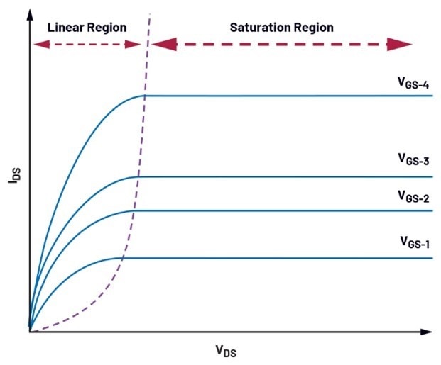

Figure 8. MOS transistor output characteristics.
There are, however, disadvantages to the 2T1C pixel driver, which include the Mura problem and threshold voltage shift under electric bias. The Mura problem is the uneven brightness in a display’s uniformity, which is mainly caused by variations in the manufacturing process, such as the density of the TFT layer, uniformity of LED forward voltage and threshold voltage, etc. These effects cause image quality issues. Although the best fabrication process cannot overcome the threshold voltage shift, pixel circuits with voltage feedback methods and threshold voltage shift overcompensation methods have been proposed to improve image quality.

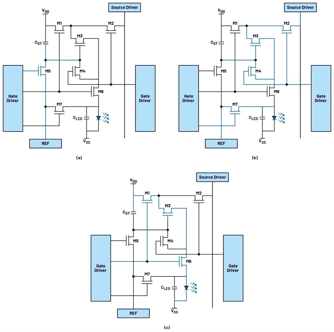

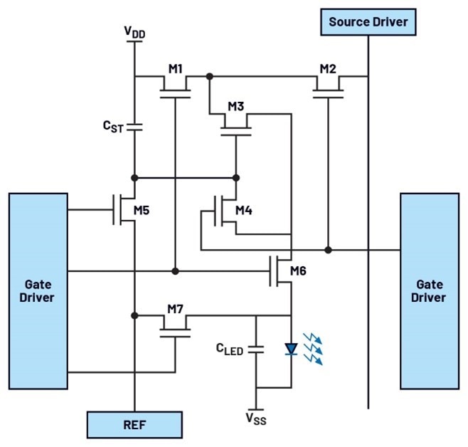

The 7T1C driving method proposed in the article “Image Quality Enhancement in Variable-Refresh-Rate AMOLED Displays Using a Variable Initial Voltage Compensation Scheme” is shown in Figure 9 (Reference 6). This 7T1C pixel circuit has three operation stages, as shown in Figure 10: initialization, compensation, and emission. The TFT M4 is used for the diode connection of driving TFT M3. During compensation, the voltage stored in CST from the source driver maintains the LED emission. The TFTs M1, M6, and M7 are used to prevent the LED from turning on. Additionally, a 7T2C pixel circuit was proposed in the article “A Highly Uniform Luminance and Low-Flicker Pixel Circuit and Its Driving Methods for Variable Frame Rate AMOLED Displays“(Reference 7).
Figure 9. Schematic of a 7T1C pixel driver.
Figure 10. Driving sequence of 7T1C compensation pixels: (a) initialization, (b) compensation, and (c) emission.
