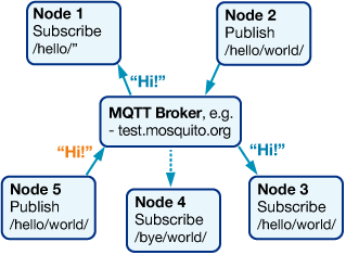

The MQTT Protocol Model
The core elements of the MQTT system are the Clients, Servers (referred to as Brokers), Sessions, Subscription, and Topics. It uses the Publish-and-Subscribe (Pub/Sub) model which decouples the client sending messages (referred to as publisher) from another client who receives the messages (referred to as the subscriber).  The process of subscription and publishing is handled by a Server also referred to as a Broker.
Brokers run topics which collect messages about specific events from clients and forward them to interested clients who are filtered by the topics to which they have subscribed. A typical system consists of one broker and many clients. Each client communicates to a single broker. The client can be subscriber or publisher.
MQTT uses TCP/IP to connect to the broker. Once an MQTT client connects to the broker, it will remain connected even if it is not sending any data.
MQTT clients send a keep-alive message usually at 60-second intervals, which tells the broker that the client is still connected. All clients are required to have a unique client name. This client name is required by the broker to track subscriptions. The publisher publishes to a certain topic and the subscriber subscribes to single or multiple topics. The topic name must be at least one character long and it is a UTF-8 string. Topics have a tree structure and use forward slash as a delimiter. For example: Home/Room/Temperature
