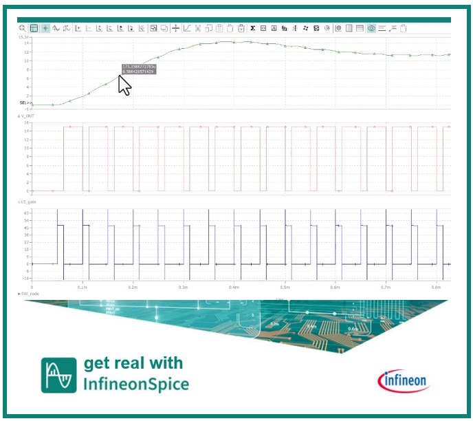

Infineon is a market leader in power semiconductor and is brining you ~ 30 years of its internal simulation engine expertise in its latest version of InfineonSpice.
What’s new?
Arrow right️Improved AC Simulation Capabilities
Arrow right️Faster and more accurate
Arrow right️3rd party component library e.g. Wuerth Elektronik passives
Arrow right️MATLAB Simulink Integration
Download Link
A interesting feature/use case is that you would like to simulate the dynamic temperature dependence of a MOSFET in your new DC-DC converter design, just to make sure your Mosfet is still operating in SOA (safe operating area). Now with InfineonSpice and with the support of our device Spice models(e.g. Our application optimized OptiMOSTm 7) you can evaluate before the start your hardware design.
