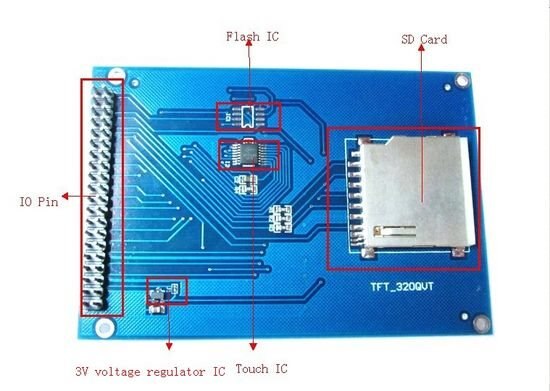

I am working on a project to create a touch screen that will enable the user to control a robotic device whilst receiving data and video from the device controlled.
I am completely new to TFT LCD technology, and was slightly daunted by the complexity of these devices. I am still on the uphill of the learning curve...

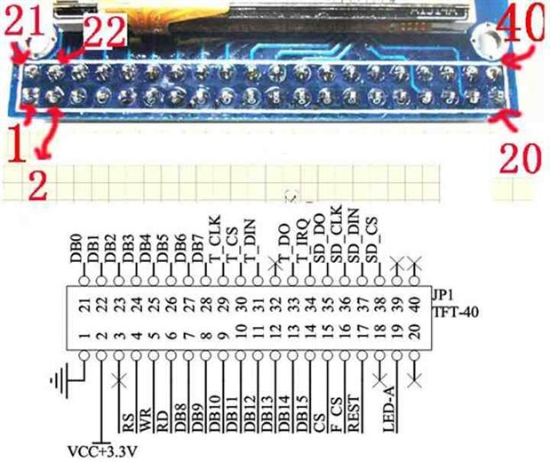

The STM32F4 Discovery boardSTM32F4 Discovery board has an FSMC ( Flexible Static Memory Controller ) which supports the connection of an LCD in parallel mode. I have 3 STM32F4 Discovery boards, so I decided to use one to control the HY32D TFT LCD I bought off Ebay, with absolutely useless example code for an 8051 type microcontroller.
There are a few examples on the web of the STM32F4 Discovery used in projects with the same controller that the HY32D uses, the SSD1289 from Soloman Systech Ltd.
The table below lists the connections used in the fractal drawing program...the touch control is not yet used.
LCD pin name
STM32F4 Pin number
STM32F4 pin name
D0
61
PD14
D1
62
PD15
D2
81
PD0
D3
82
PD1
D4
38
PE7
D5
39
PE8
D6
40
PE9
D7
41
PE10
D8
42
PE11
D9
43
PE12
D10
44
PE13
D11
45
PE14
D12
46
PE15
D13
55
PD8
D14
56
PD9
D15
57
PD10
CS
88
PD7   (NE1)
RS
60
PD11 (FSMC-A16)
RD
85
PD4   (NOE)
WR
86
PD5   (NWE)
RESET
+3V(1K Pull up) or GPIO
TP_IRQ
PD6
TP_SCK
52
PB13
TP_SI
54
PB15
TP_SO
53
PB14
TP_CS
51
PB12
BL_CNTL
69
PA10
I will send code for the fractal drawing to whoever asks, just send me your email. I have now (12/06/2012) also added it to Google project hosting.
It should be available to download here.
The code is not mine, a very helpful fellow Engineer sent it to me.
I will be working on creating a touch menu next and will update soon hopefully. image
Update: 3/06/2012
I have managed finally to convert a .jpg image into a C array and get it displayed on the HY32D TFT LCD, touch screen works also, although I do have to write a better calibration routine.
I converted the .jpg using the RGB565 converter from ST Micro which is available as part of the STM Embedded resources GUI
Decided to start on a touch menu now...could not resist putting direction arrows on..left, right, up, and down, and next a menu button in the middle. Why? Well I am taking small steps and will work up to displaying data next, to start with I am going to attempt to write a calibration routine for the touch screen, and then get each button to control direction of 2 DC motors...eventually the buttons will operate a circuit designed to transmit a 'direction signal' using 2.4GHz RF.
a pic of the screen so far...4 buttons no menu yet, each arrow is 50x50 pixels in size.
A word of caution...I am using IAR Embedded Workbench for ARM version 6.30.8. I had to increase the STACK size to be able to store these images..no point me going into too much detail, as I do not yet quite understand it properly, if you have the same problems let me know and I can at least guide you through what I have done so far...
Another pic...this one one includes the STM32F4 Discovery board in the background...on a breadboard ( just for convenience! )
And below the Arrow image..
