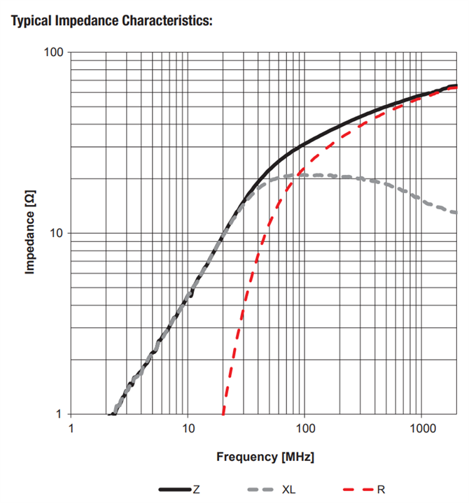

    They are great problem-solvers, getting rid of unwanted oscillations and suppressing noise. For anyone curious, for a certain frequency range, they act like a resistance (at a very high-level). There are different kinds of ferrites for different applications, but specifically, this is for those intended for "suppression", which is what this kit is for, i.e. designed to have high(ish) resistance at certain frequency ranges. Other ferrites may be intended for "inductive" applications, use-cases would include oscillators for instance.
    It's sometimes easy to know because for companies like Wurth, they will provide nice detail: the red dashed line shows the resistance component at different frequencies. Many manufacturers won't provide such granular information, they may just mention the resistance at specific point frequencies.

  • jc2048
    jc2048 over 3 years ago in reply to shabaz
    "It's sometimes easy to know because for companies like Wurth, they will provide nice detail..."
    But do keep in mind that the curves shown change when a bias current is applied (the analyser curves are for 0A dc bias), and also with a change in temperature (those will be for 25C). The former isn't too bad with smallish currents (10s of milliamps), but once a supply current gets to an amp or two the change (reduction of impedance and hence resistance) can be considerable (though it's very dependent on the actual ferrite material used for the bead).

    shabaz over 3 years ago in reply to jc2048
    Hi Jon,
    I meant that it's possible to tell which ferrites are intended for suppression use from those curves (and at what frequencies), but as you say, ferrites are not precision in any way at all. Normally at least a minimum resistance is desired, and any higher is a bonus.
    For the ferrites in question, they are SMD components (i.e. not bare ferrite that needs self-winding) and they have ready-made guidelines in the datasheet on how much current to pass through them, so it's fairly easy to choose a part, for at least room temperature. even though it won't be accurate, usually just as high a resistance as possible is desired at the frequencies of interest, so anything well north of that would be selected (if possible).
