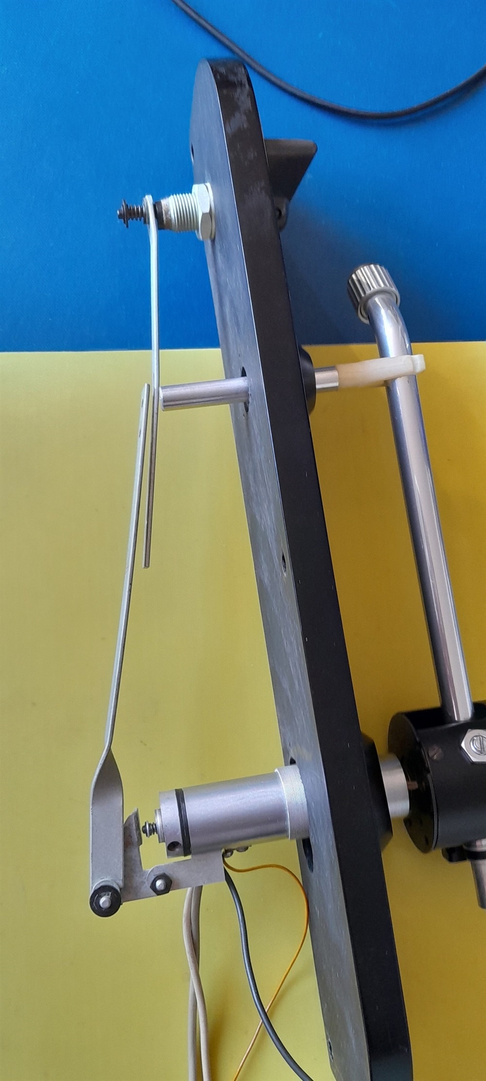

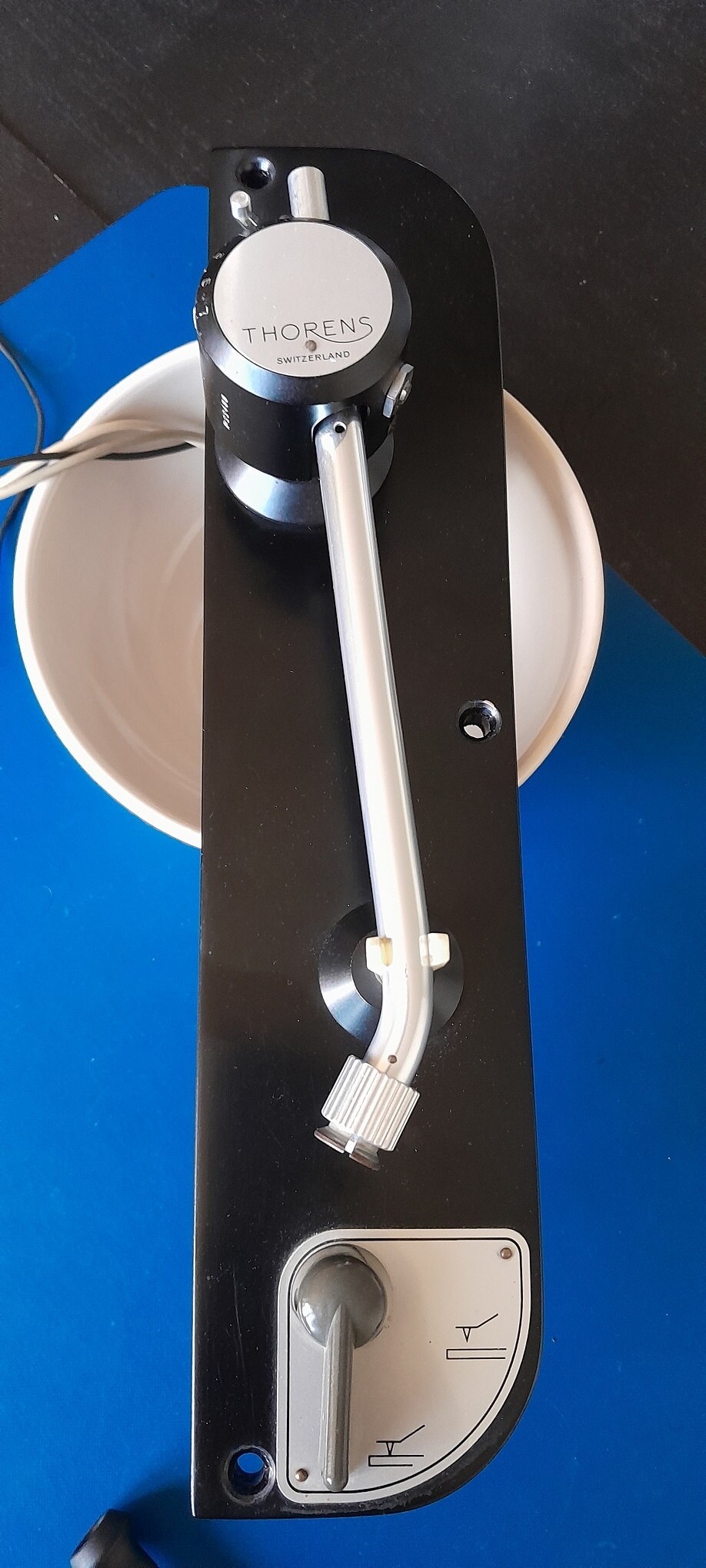

    At this moment, all difficult jobs have been done. I replaced the race and completed the assembly. The arm is now ready to be mounted on the table.

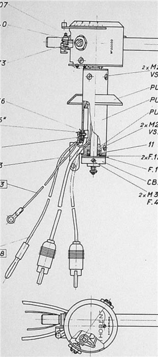

    My source for assembly instructions. What would I be without the internet and all those volunteers and enthusiasts?

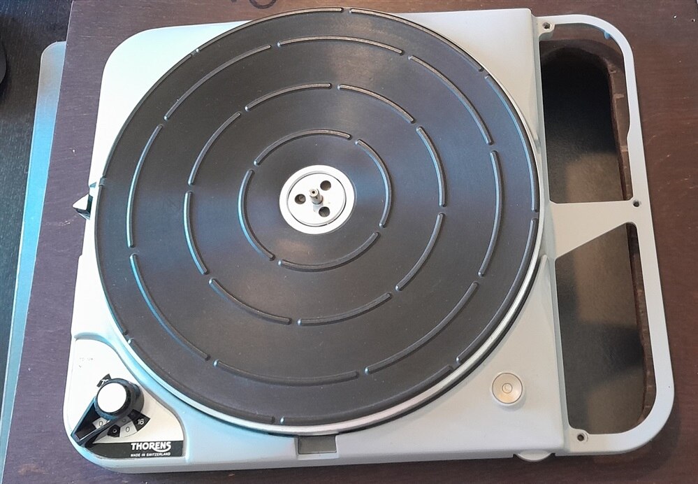

    When I bought it:
    What looks like dust was actually algae and mold (and very likely spilled beer and soda drinks). All aluminum parts were green.

    colporteur , the bottom image is my rework.
    I could have made the eyelets cleaner with some abrasive method.
    But I'm not trying to turn it into an as-new table. I service, don't restore.
    When there is dirt or ***, I clean it. I never use force, sandpaper, corrosive products. Water, soap and sweat.
    When components can't be restored, I replace them. On this table, it was the rubber belt, rubber suspension of the platform, and the rubber in the arm.
    The idler wheel and motor suspension were either made of a different processed rubber, or synthetic. They kept their form and flex.
    I also replaced all greases and oils. Completely took the motor apart and serviced its bearings.
    What I have is a player that performs well. With as much of the original parts as possible. And hopefully no damage done to it by my handling.

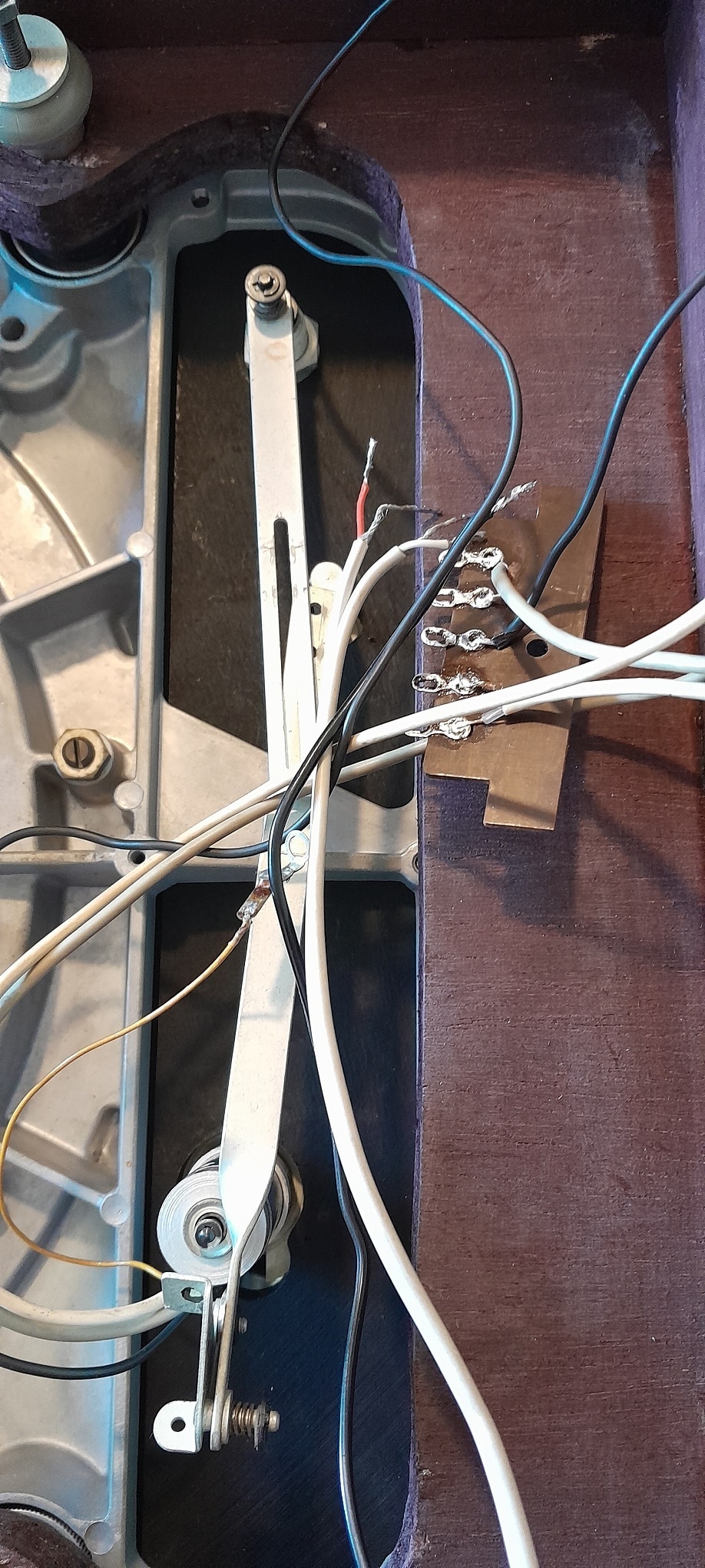

    The arm lever mechanism is back in place. The two parts are disconnected. Else I can't fit the arm on the table.

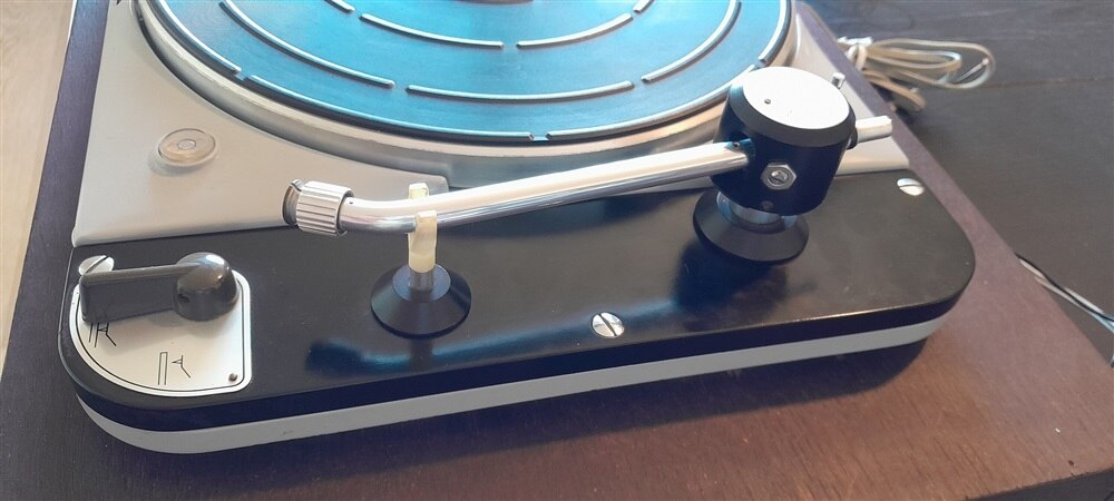

    Jan Cumps over 2 years ago
    Mounting work started.
